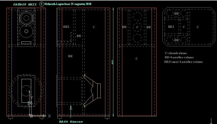

The bandpass MK2 design is cheap and MK1 has proven that it sounds very pleasant good full distortion free warm bass and detailed high tones of the dt300.
link:http://www.diyaudio.com/forums/multi-way/137036-big-bandpass-fatboy.html
To make a good sounding sub-bas is the fundament of the total sound it can make the sound impressive or to thin with a poor bass response.
HELMUTH,
i couldn't agree more, only just recently when i finished the OB with 15" beta, i realised how much the bass involved for the whole sound, although i cross them @200hz.
