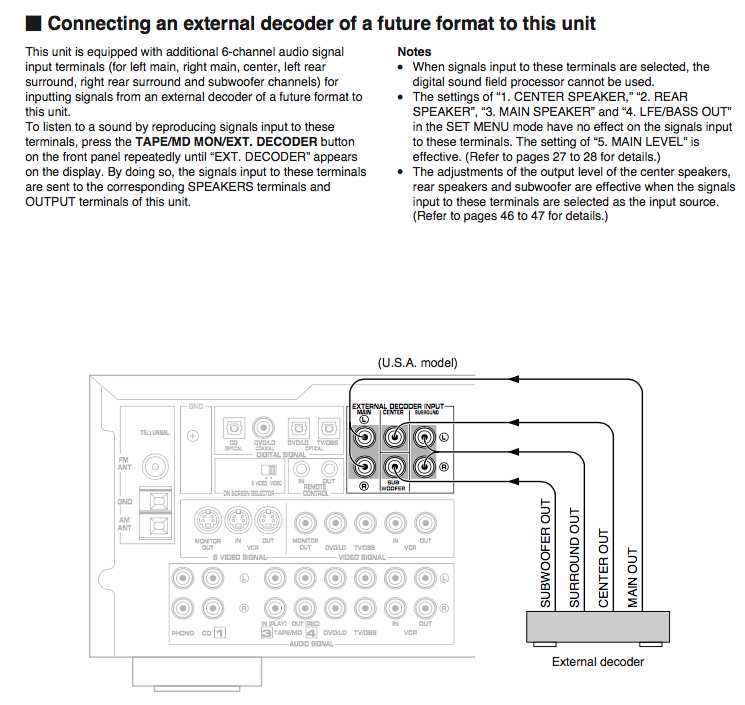

Recall that amp, the rx-v780, has couplers between the pre-amp and amp that you can break into.

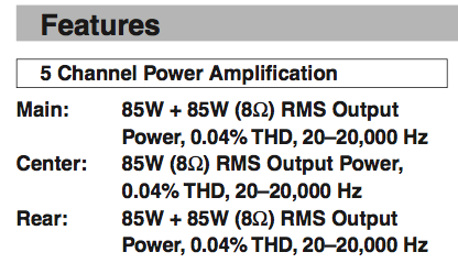

If u get 40 W a channel all channels driven u r lucky. The receiver power consumption is only 310w. With about 65% efficiency u do the math.From the manual:
Note that it does not say all channels driven, so if one is using more than 2 channels then a power derating is likely to be needed. One could probably say 50w/channel if all of them were used at once.
dave
"85 watts" is probably based on the rail voltage and that represents the loudest output possible before the power supply poops out. With all channels running sine waves, Imagemeister is right in what was said. But with music - esp natural music - 85 is what the amp is good for before clipping under any foreseeable signal.If u get 40 W a channel all channels driven u r lucky. The receiver power consumption is only 310w. With about 65% efficiency u do the math.

RE: The total wattage consumed vs. what goes out to each channel, seems like that has a lot of assumptions in it that may not reflect real world stuff.
310 watts consumed x .65 = 201.5
201.5 / 5 channels = 40.3 wpc available
In the case of stereo listening, 201.5 / 2 channels = 100.75 wpc available
Perhaps, if each channel was loaded fully (I guess with a sine wave at 40w it would be fully loaded?). But we don't listen to sine waves, usually. Actual music has peaks and lows with spaces in between where there is nothing on one channel, but maybe something on the other, etc, plus that's only 2 of the 5 channels being used so there seems to be 100 wpc available anyway in the case of stereo. HT listening, some channels may have a lot of energy being sent to them while others are nearly silent, since there's probably more "quiet" time in a given movie than most music. There's much more dynamic range in a movie vs. music, so there may be moments where if all the channels are peaking simultaneously you might see reduced output overall... but it seems like this wouldn't be a big deal. (many more assumptions, and I'm undoubtedly oversimplifying things)
