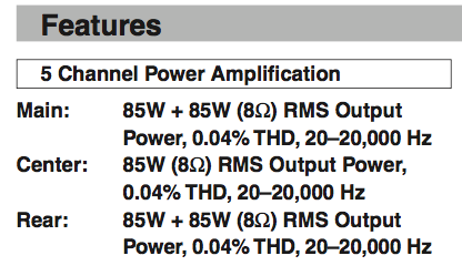

From the manual:
attachment.php
Note that it does not say all channels driven, so if one is using more than 2 channels then a power derating is likely to be needed. One could probably say 50w/channel if all of them were used at once.
dave
