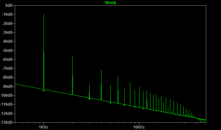

Take down R4 to 50k or so.
The problem is the gate leakage current of Q2. Over a high R4 it drives the gate voltage towards the rails and the circuit clips.
BF862 has high leakage compared to other JFETs. I have no clue, however, how accurate the spice model is regarding the gate current. I suspect it gets it too high, though.
So in a real circuit you can probably use higher R4 than in this modelling.

Thank you,
That worked like a charm and H2 is now very low. Should I do this in real life then?
depends.
on your desired output swing and on your Q2 Idss.
you can measure the voltage at the drain of Q2. add the desired swing and make sure the peak stays off the rail.

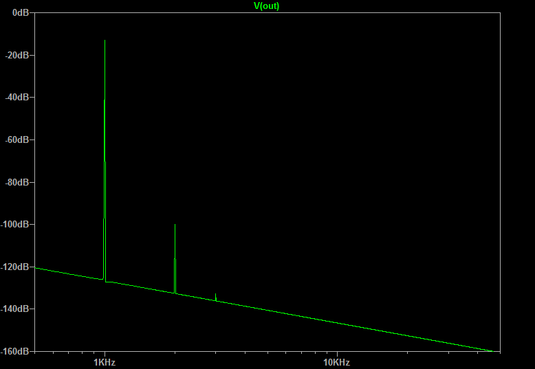

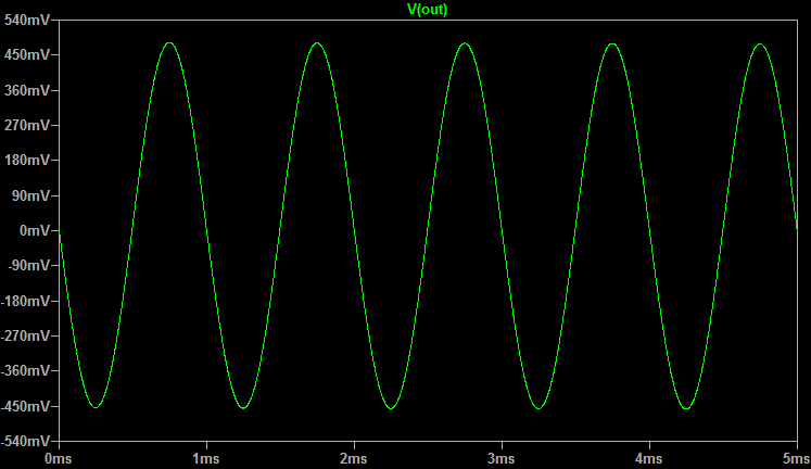

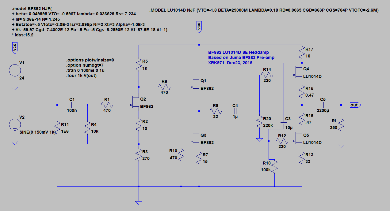

A Headamp with Juma's BF862 Pre as Input Stage
I am just playing around with LTSpice and took Juma's preamp and added a pair of LU1014D power JFETs for a SE class A output headamp. Probably lots of mistakes here and I welcome feedback and constructive criticism. I am not sure if this is a good LU1014D model (got it from here). I tried a more complex model from flg, found here but it kept giving me errors. If anyone can point me to the latest working model that would be great.
The schematic looks like this:
The scope of the output looks like this:
FFT looks like this:
It would probably play music but pretty high HD, although predominantly 2nd order so may actually sound lind of sweet if you like that sort of stuff. I have it driving a 250ohm headphone (my DT880's).

But getting back to the BF862 and LU1014D amp I proposed, are there any glaring performance issues there?

I wouldn't do it like that. Sorry, but I' don't have enough time to explain it in such a manner that you understand what's wrong with it.But getting back to the BF862 and LU1014D amp I proposed, are there any glaring performance issues there?
