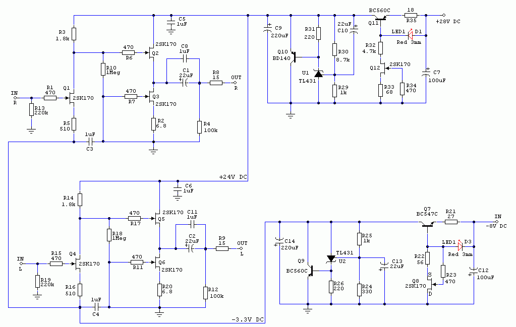

sismik,
there is an easier way to make this pre (see attached schematic).
That way we don't need the negative PS anymore and the gain is easily adjusted by changing only the value of R3 (in reasonable range: from 100R for 17dB gain to 470R for 6dB gain).
Of course, this demands the use of an input cap (C1) but since it's of small value (47-100 nF) it's easy to fit the good one (WIMA MKP10 or whatever one likes).

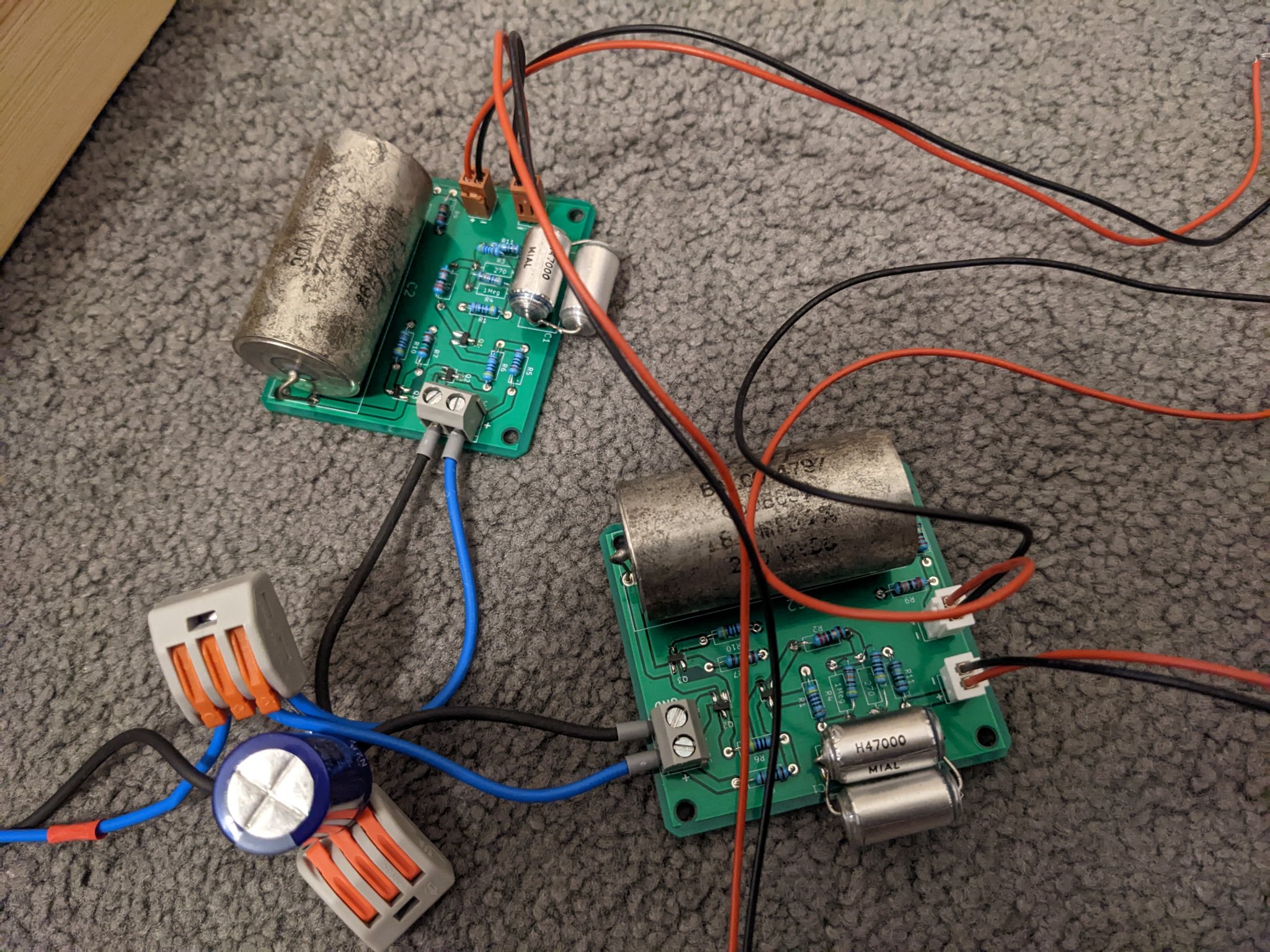

when BF862 was discontinued we had a big group bye. What to do with >150 BF862 in stock leads me to Juma's 862 Pre

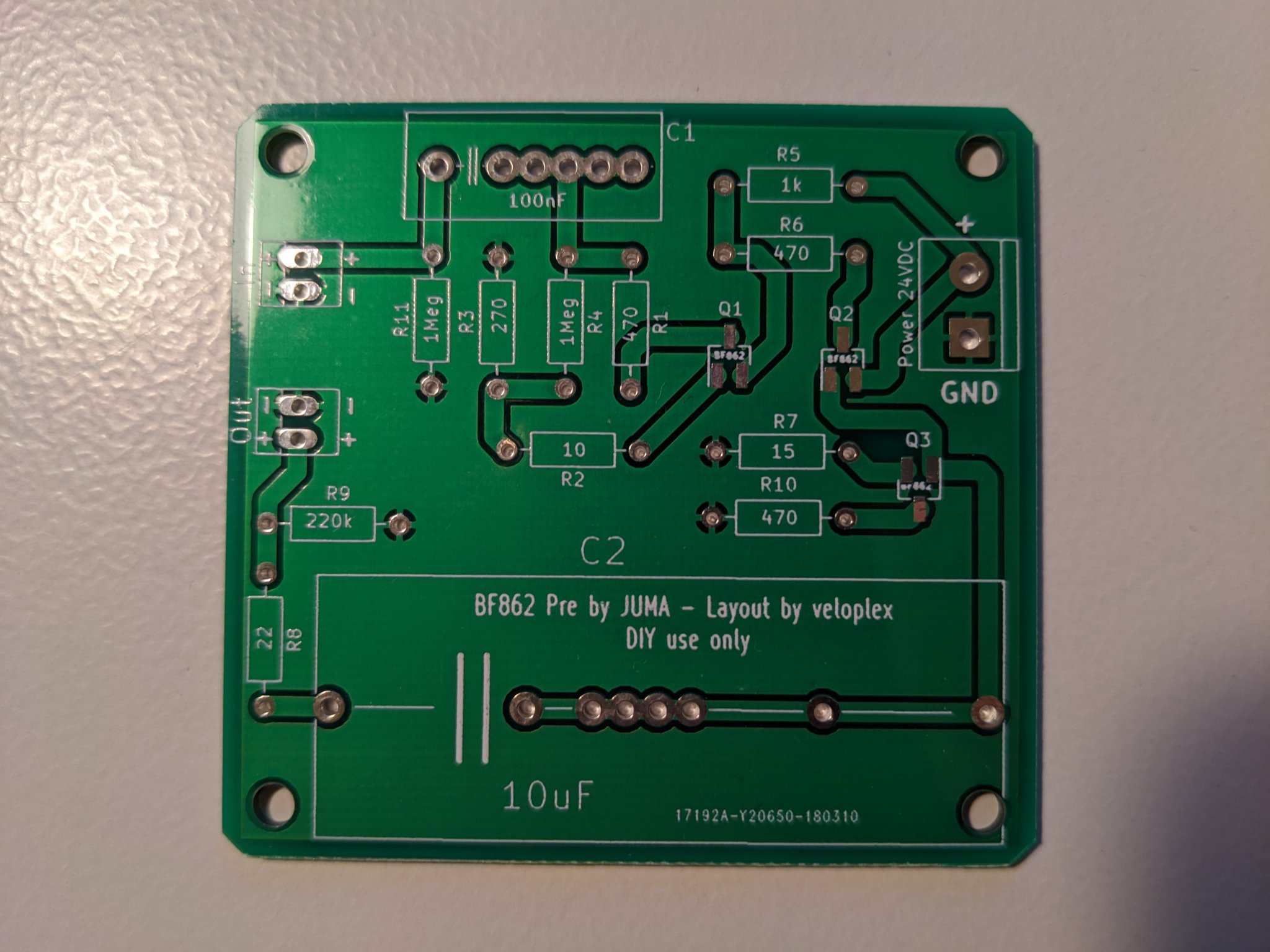

Some years ago I made these PCBs
To lazy to match all the bf862 delayed the project until last week
Fed by a Jung Didden SperReg. First listening are very promising.

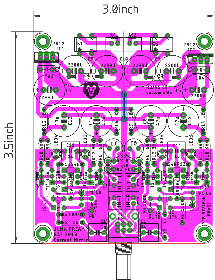

Hi Thimios,
the .zip archive from the post #54 contains Sprint Layout 5.0 file.
GBR file attached (inside the zip archive).
All the best !

Thanks juma.
I have a pcb by prasi. 🙏
The problem is that i have 2SK170 but not 2SJ74.
I have two pairs only, for a future project Nelson Pass F4.
I have read somewere your's recommendation about using a pair of k170&j74 in the preamplifier circuit and skip this from the F4 input?
