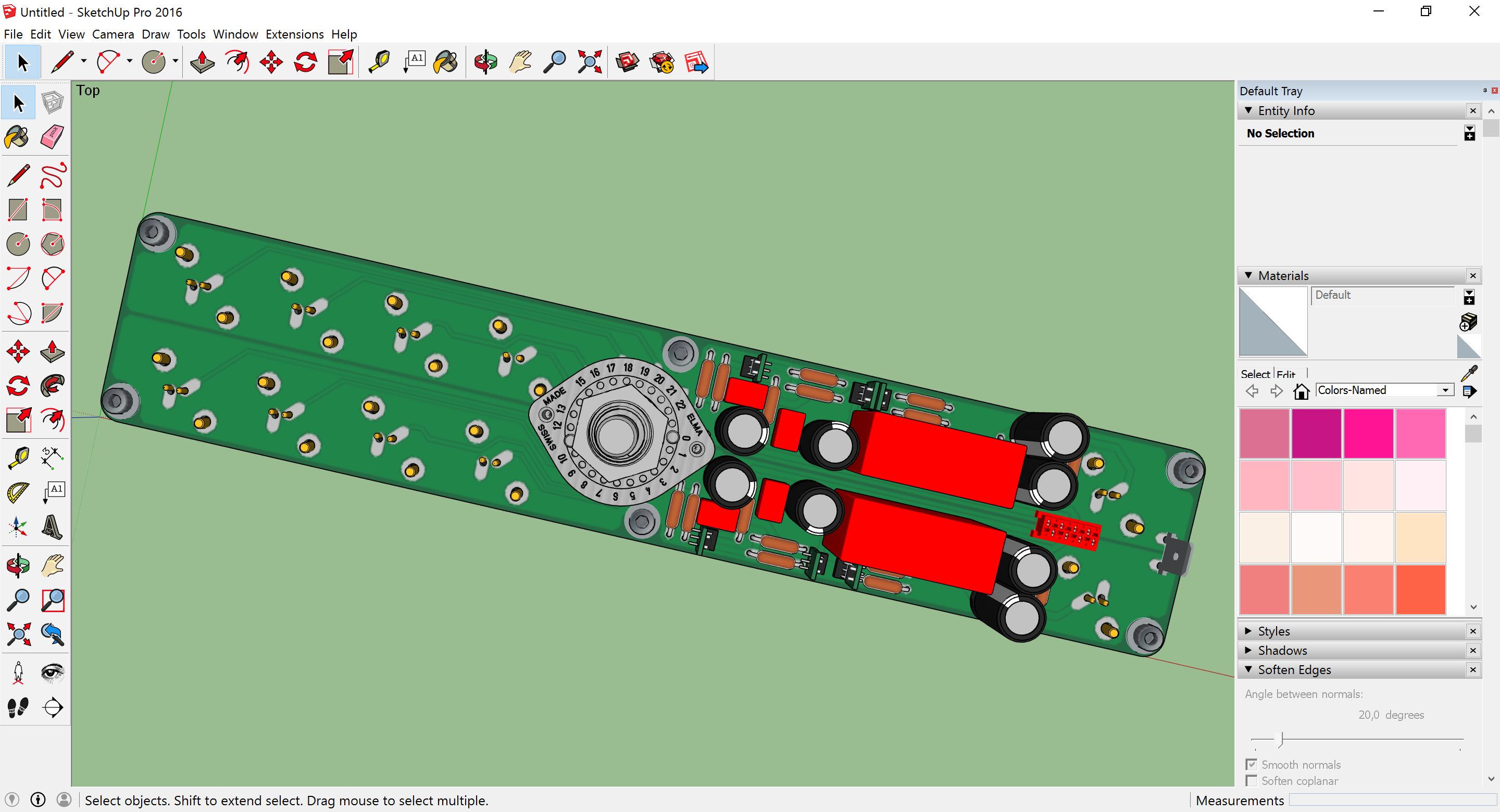

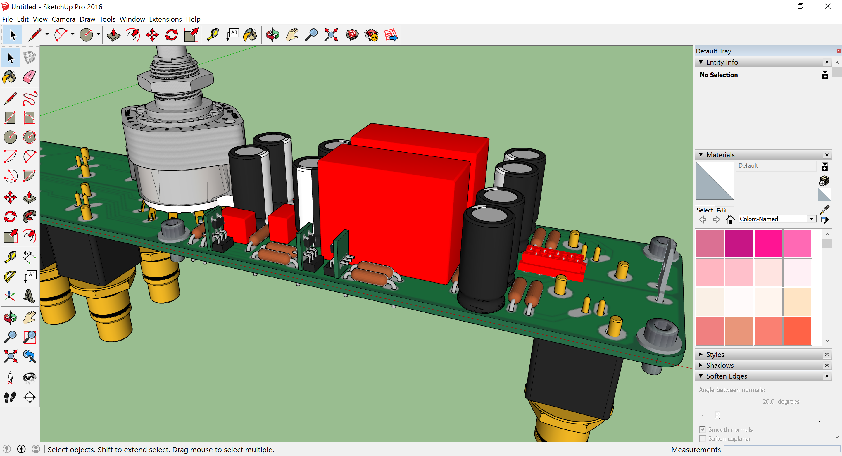

First attempt, potentiometer (attenuator) missing.
Micromatch (red connector) for power supplies.
JP

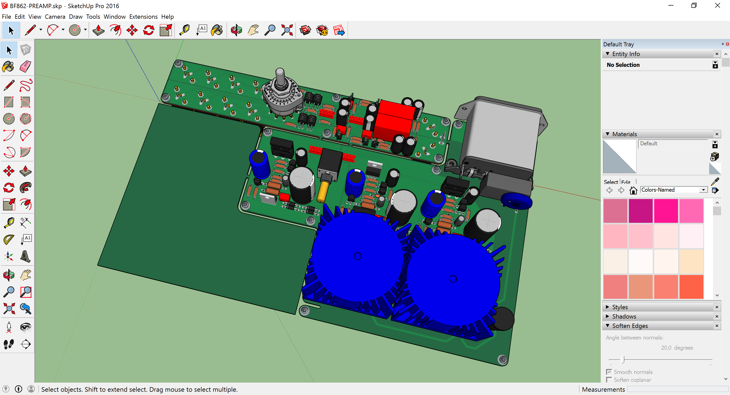

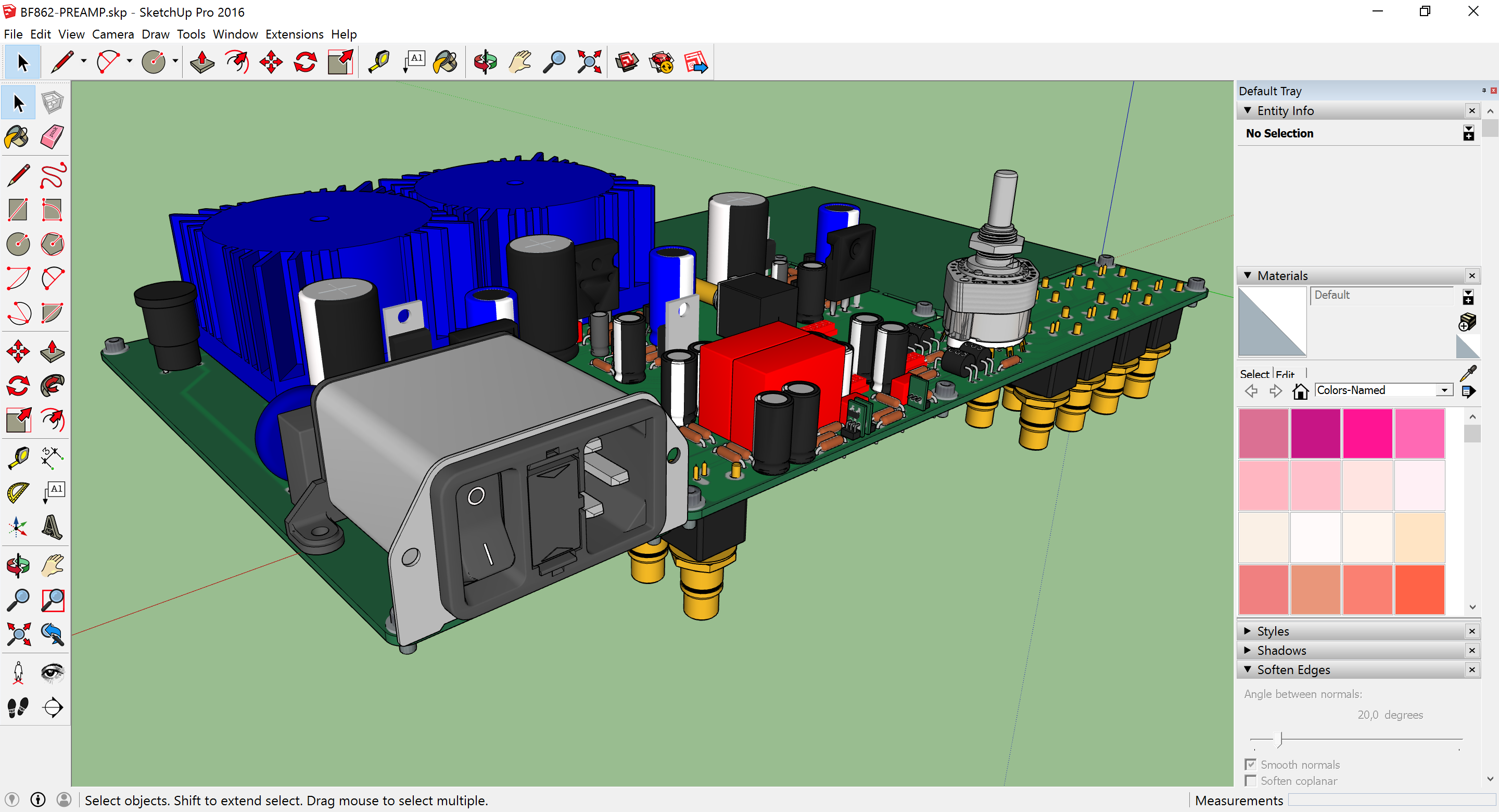

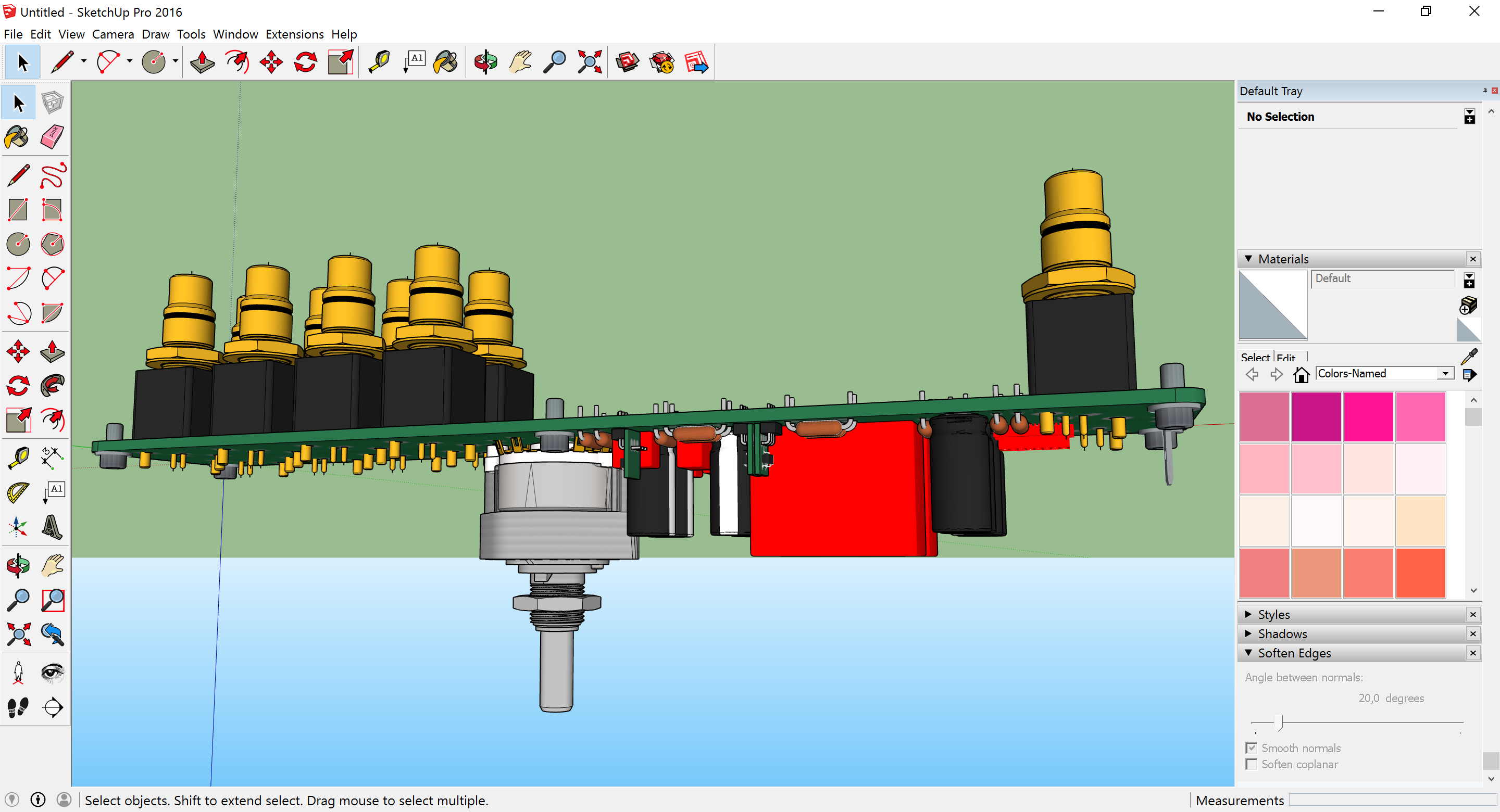

BF862 custom adapter board (panel) not finished yet.
Waiting for ELMA switch correct 3D model (promised by support).
With Lightspeed Attenuator.
Some place on the panel, perhaps CUBIE (1, 2 or 3) including supplies?
JP

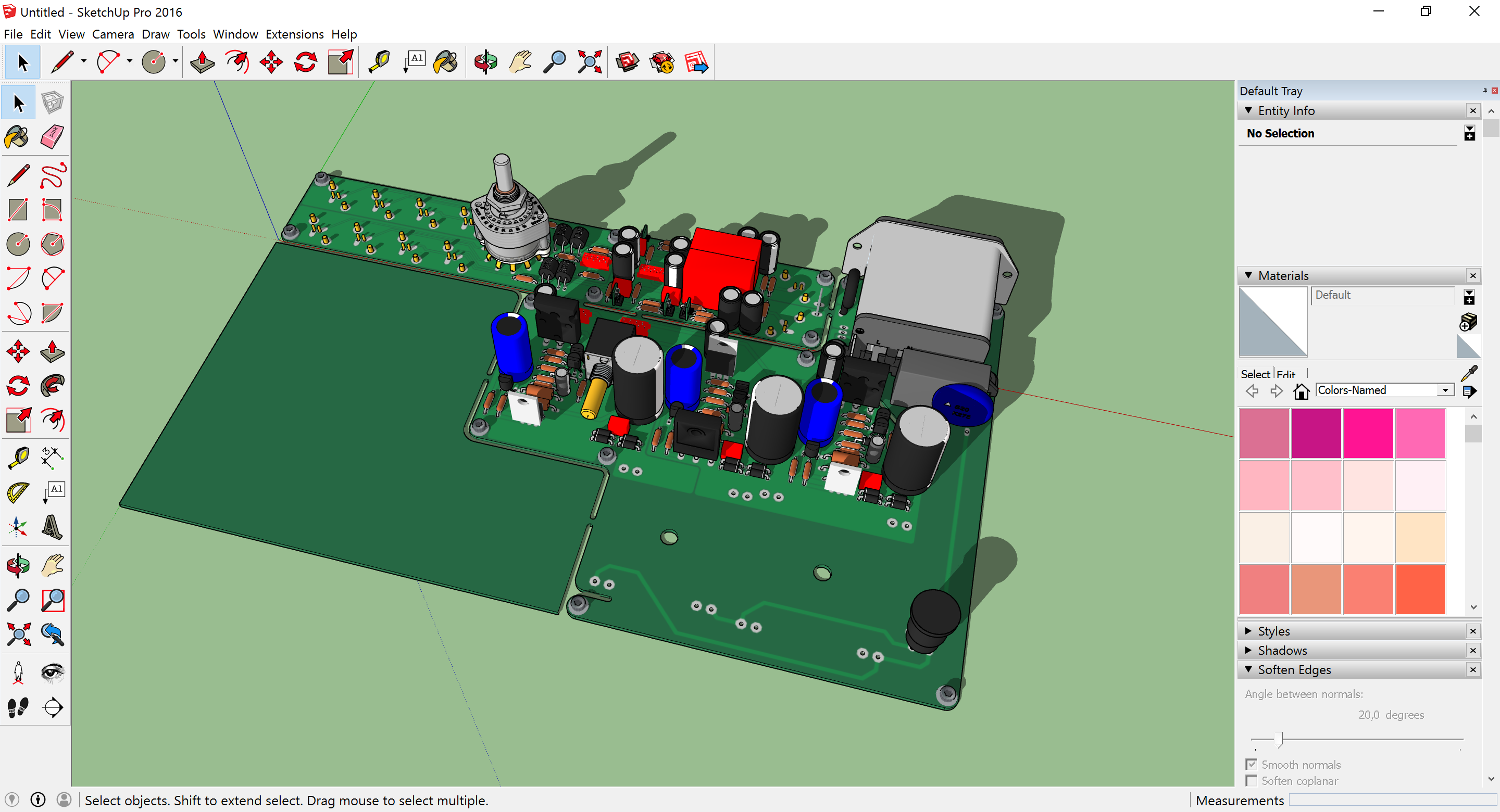

still working on BF862 preamplifier (Zen Mod Iron Pre on ice).
Talema Eagle symbols wrong, new defined, working on 3D models.
Left cm2 for:
- xrk971 BF862 SE headphone amplifier?
Waiting for suggestions.
JP
JP
Good to see that you kept any heat sources (transformers, regulators ect) well away from the led/ldr's, make sure you have vents above the transformers to release any heat build up.
Cheers George

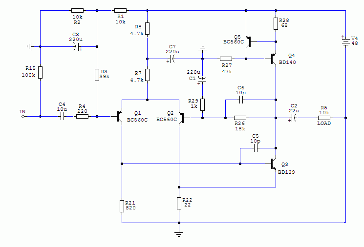

AKSA's Lender Preamp with 40Vpp Output
In the above thread Juma suggested this circuit which looks very good too. I have not had a chance to build Juma’s yet but expect it to work very well like all his circuits do.
644753d1510233865-aksas-lender-preamp-40vpp-output-lemo-gif
But I can confirm that the Aksa Lender Preamp sounds superb and easily puts out 20vpp at 0.002%THD. Here is 20vpp into 7kohm load and running 22dB gain.
