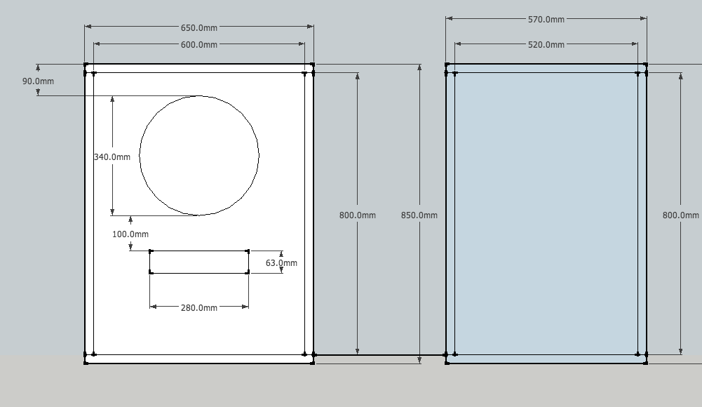

For sure, I'd like to keep the cleat of 25mm x 25mm situated just below the woofer (see picture above). But my question is more oriented on the lateral bracing of the enclosure. I'm wondering if a good idea would be to have a second 25mm x 25mm cleat in this axis. What do you guys think?
The goals are to keep the cab from 'breathing' and to provide the driver with a sufficiently rigid/damped work 'platform' to maximize its electro-mechanical, acoustical efficiency; so yes, all six sides need to be tied together and the driver braced/mass loaded to it.
Look at Dave p10's bracing schemes for what I mean, though all that hole drilling is way too much for me, so I just use closet rod or 2x2 or 1x3 boards, etc., scrap [including chain link fence rail or similar] tied together, then wrapped with fiberglass insulation. All that fancy internal woodworking that's not normally seen is wasted on me, I got better things to do, but do envy their seemingly boundless patience.

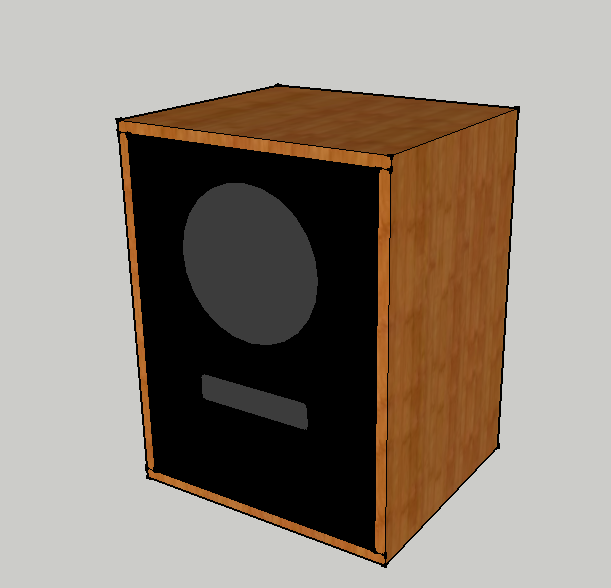

An idea of what these speakers can be.... just an option, other locations for the speakers can be used....
Drawings and 3D view.

Hi everyone,
André is of great help. We are doing some adjustments from this option but I think that we are pretty close from something classical and interesting for me.

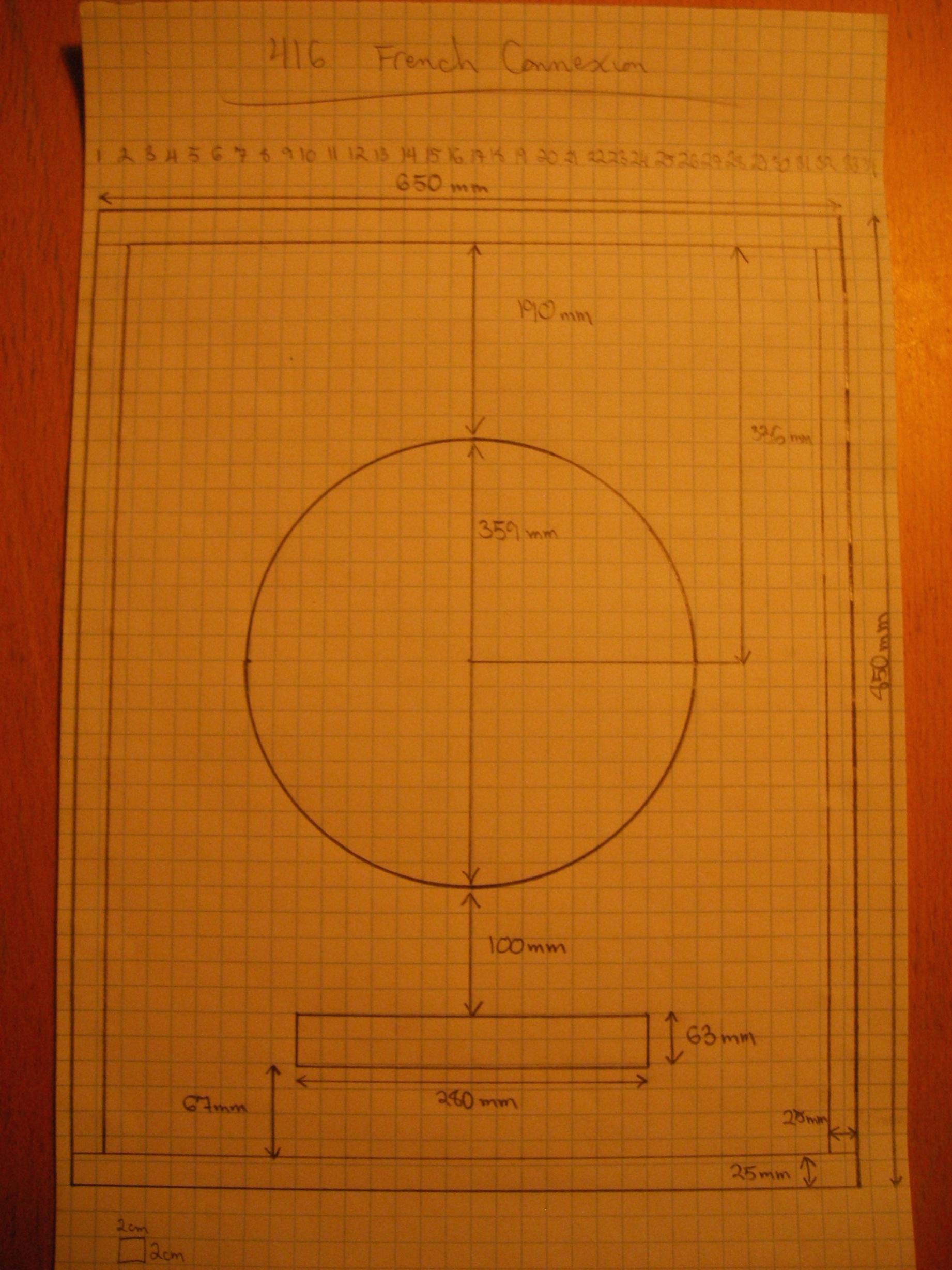

GM, I draw the option you had suggested above. See attached picture.
This said, I prefer André's proportion which put the speaker higher on the baffle. I looks more natural and has André told me, we are keeping emissive source even closer one to another.
Sébastien

I thought you were building a deeper Petite Onken for the 416, not a simple reflex, so while ~0.42 IIRC is the theoretical ideal, there's little difference where it is along the baffle and to the first approximation, minimizing the CTC spacing is a good plan.
That said, when a long horn is one of them there's the matter of how the mounting distance, tilt of it combined with the XO's time/phase offset determines how well the two sum at the LP, oftimes making a short CTC spacing a bad plan: Linkwitz-Riley Crossovers: A Primer

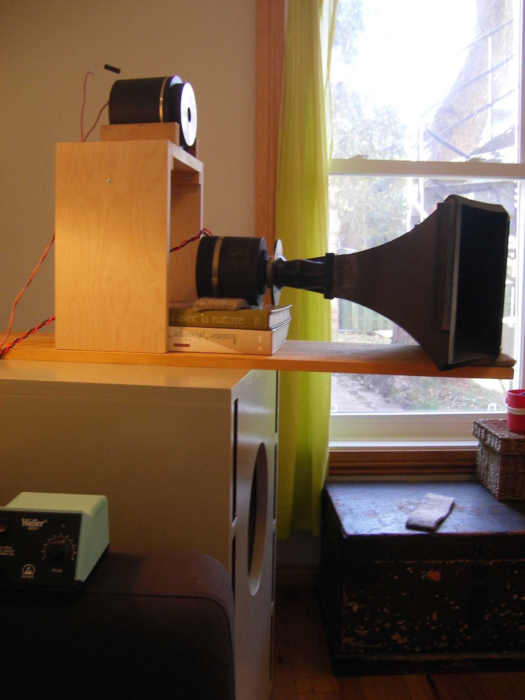

Curious why the cabs appear to be upside down and how you get good integration at the LP with such a wide driver CTC spacing.
GM
It's an excellent question, partially because my father in law added bases that I had not planned on, and because originally I had planned to integrate the mids and highs into the cabinet so there was room for them. Given the later changes that occurred they would not fit. It does bother me, but no fix is in the offing, and as I have shifted the XO points lower over time it becomes less and less of an issue.
I am now crossing at 680Hz which helps with the acoustical center to center issues.
The fact that it works as well as it does might be serendipity. I've measured extensively and I don't think anyone could tell from looking at the graphs where I cross from the woofers to the midrange drivers. I can't hear or measure any obvious deficits either due to the wide CTC. I may be getting away with it because the mids and HF drivers aren't point sources and aren't integrating near the baffle which is obvious during measurement, however at the listening position they are fully integrated. XO are all 2nd order LR, and I do use some mild parametric room EQ, no more than a couple of dB of boost or cut is required. Measured response from 200Hz - 20kHz falls comfortably inside of +/-2dB. Room interactions below 200Hz make LF measurement difficult but oddly the system does not start its steep dive into oblivion until 28Hz. (Below 35Hz most of the radiation is from the ports) The room is cluttered but strangely enough is the best sounding room I have ever had, not a lot of obvious artifacts. I'll give Jim Smith and his book some credit.

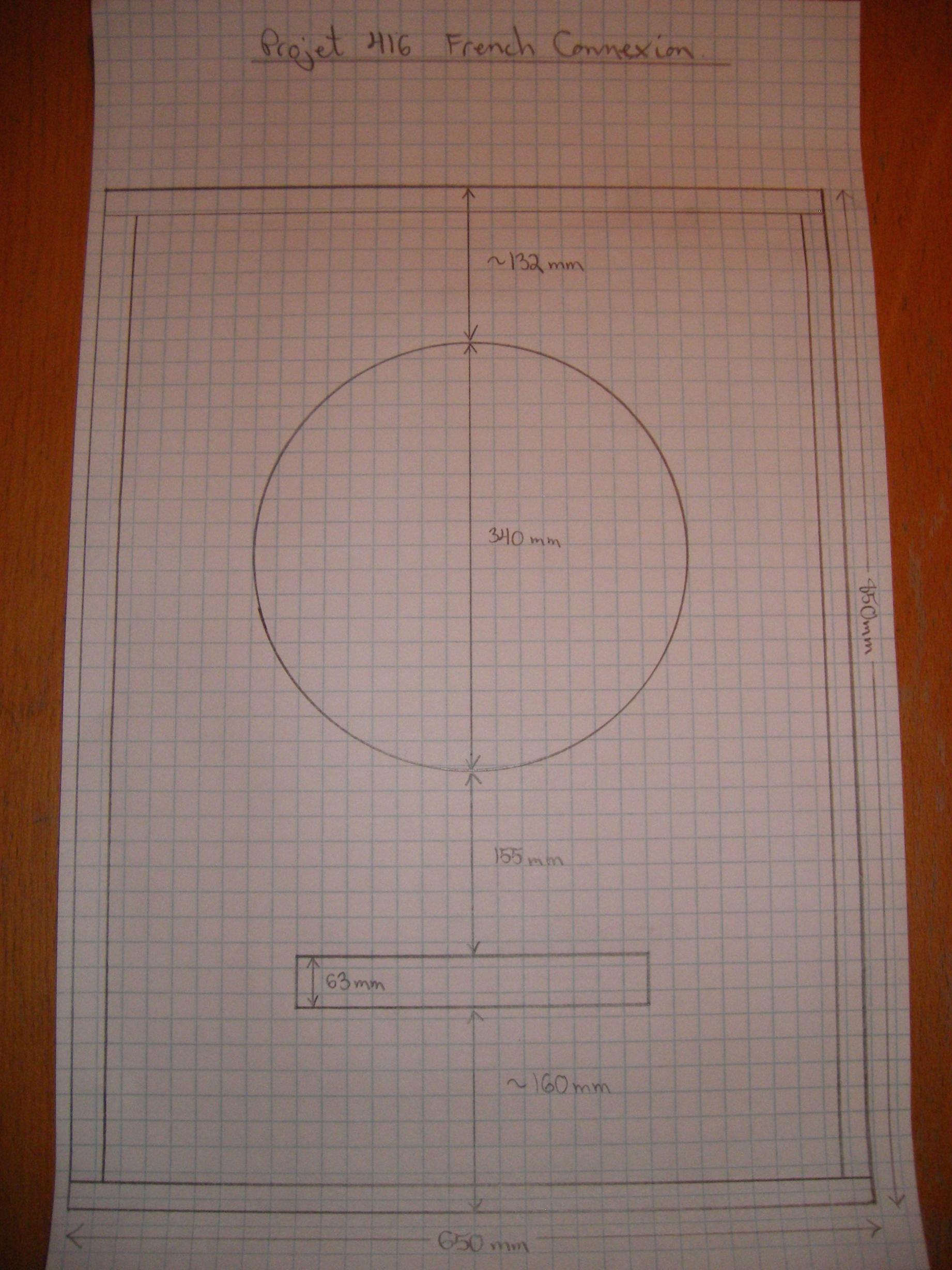

Finally, here's a plan for the bass-reflex cab to come which I really like. In the end, it is between your first suggestion and André's one. This gives a classic look with right proportions to my eyes.
Sébastien

Good morning GM,
...Looks like one of Altec-Lansing's longest 'running' 15" cab designs, the 620, which dates from before WWII as a Lansing Manufacturing utility cab. 😉
Late vertical vent + front tone controls cutout variation shown: http://www.lansingheritage.org/images/altec/plans/1970's-lf-plans/enclosures07.jpg
GM
Thanks for the link, I don't know this Altec cab, but we are aware that we are not creating any new here. It's really a classic design and the example from 620 proves it.
