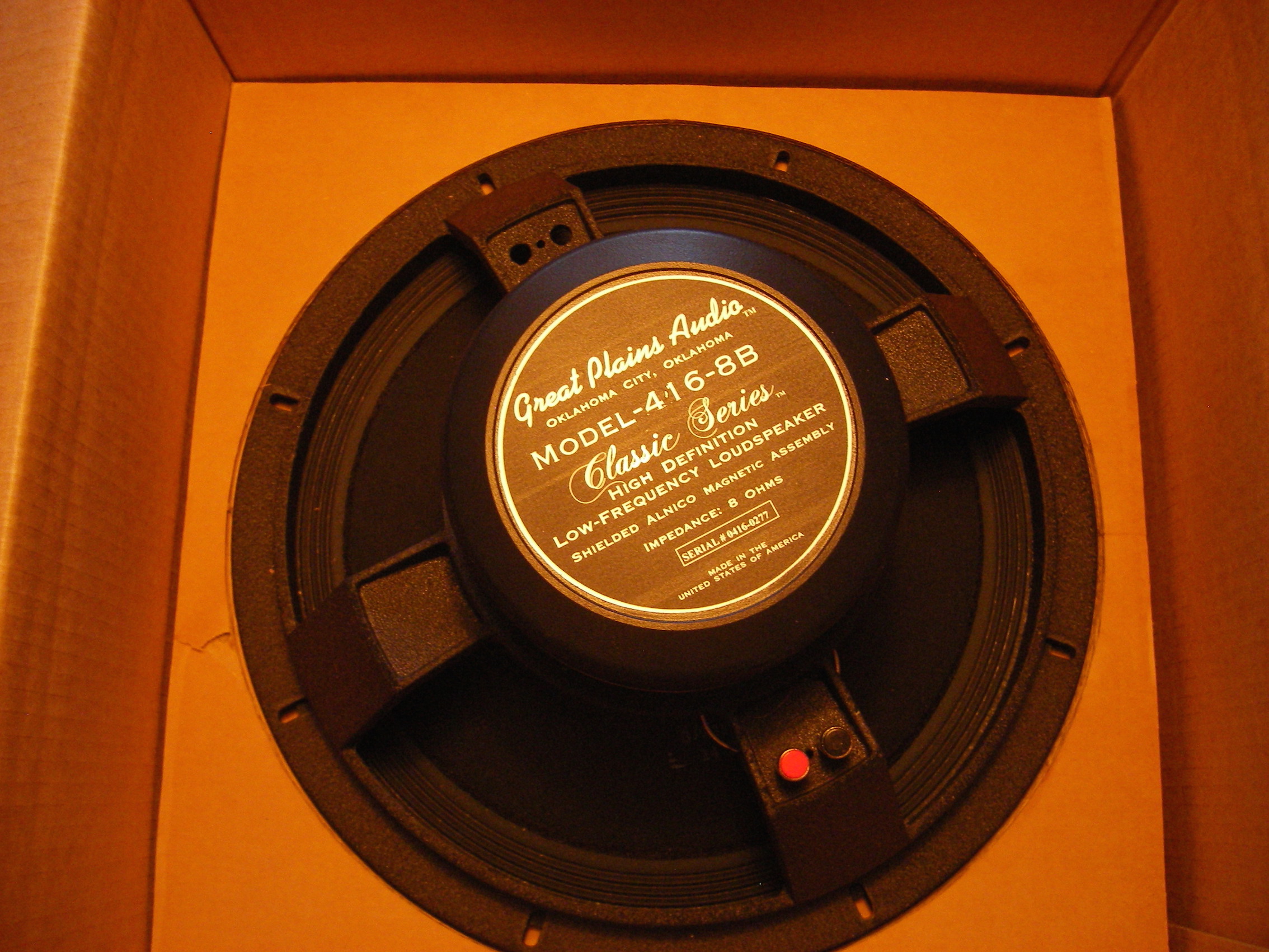

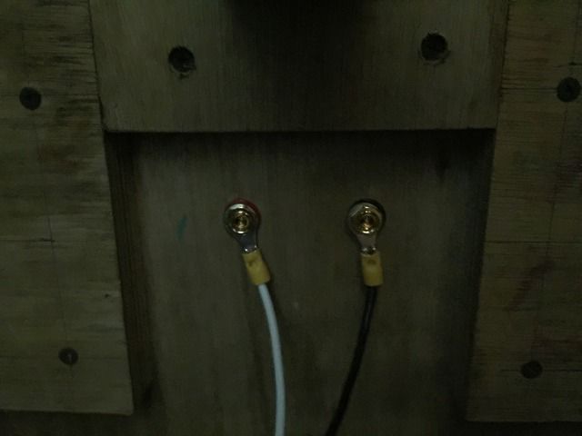

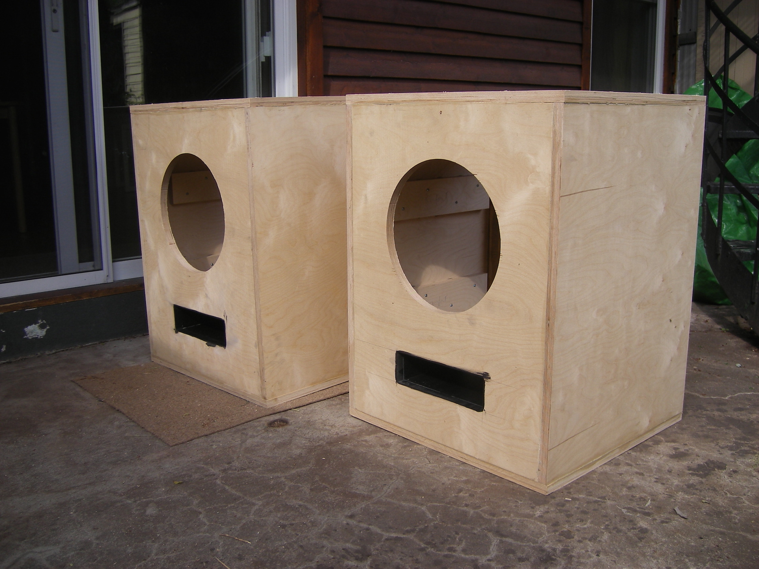

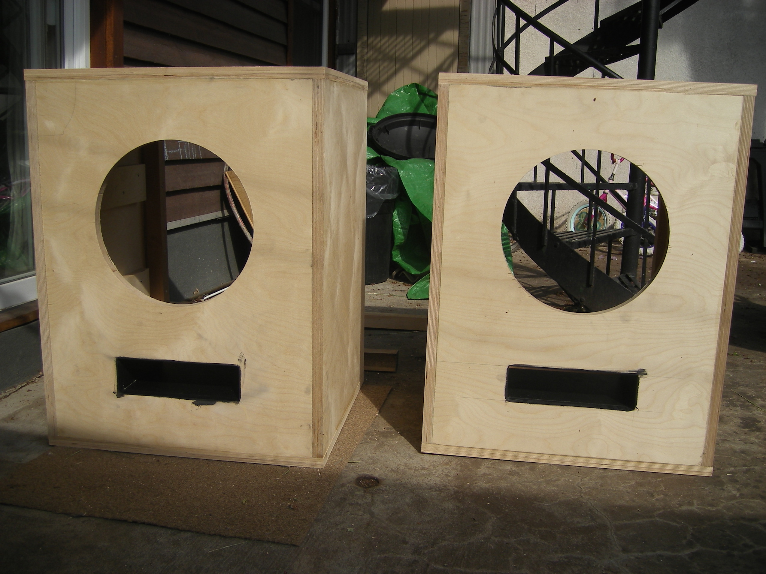

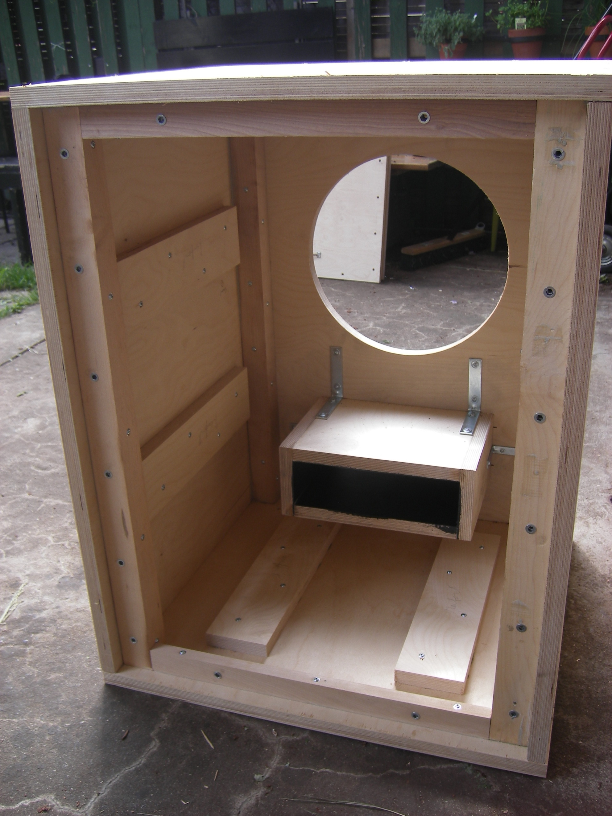

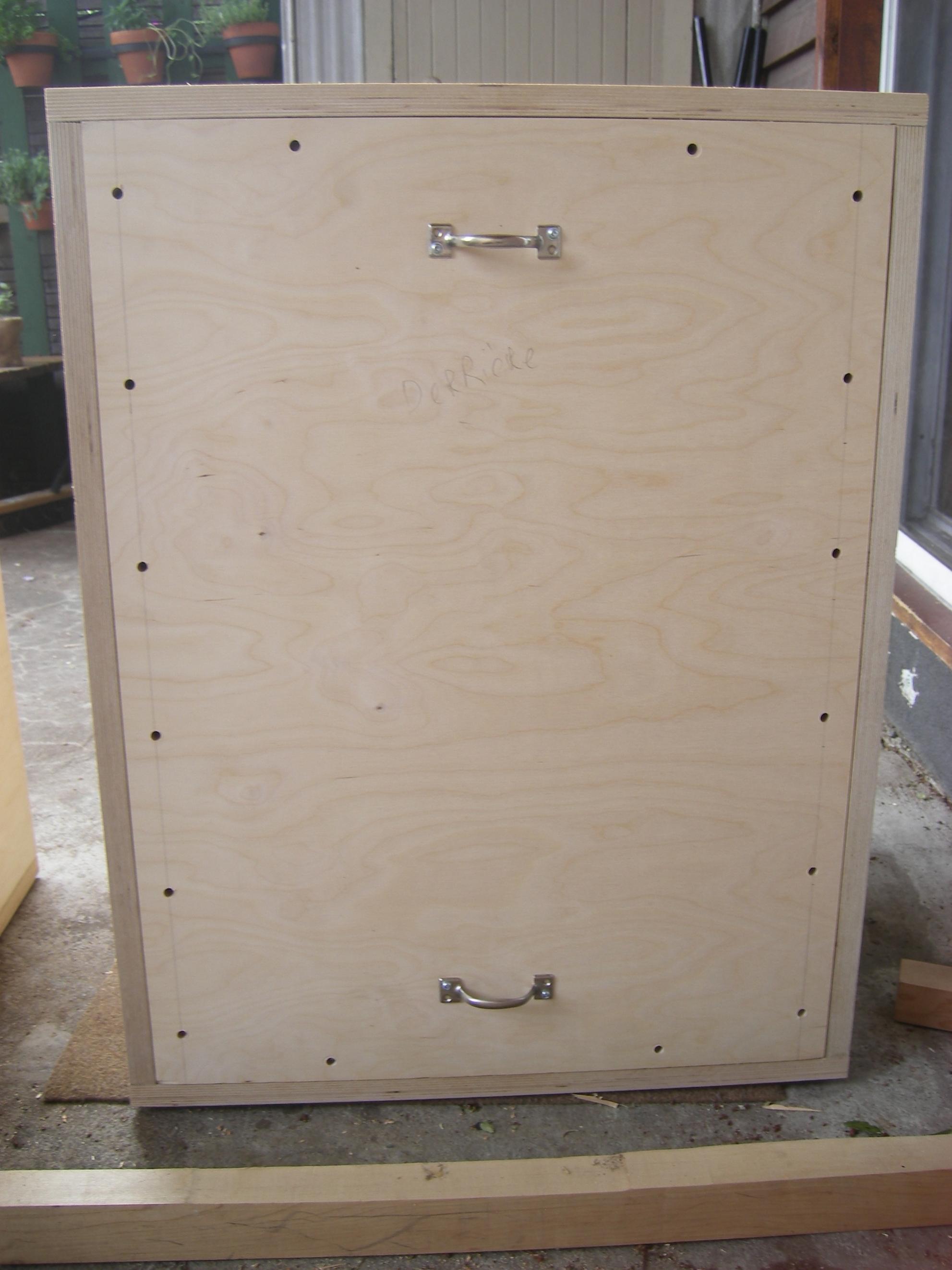

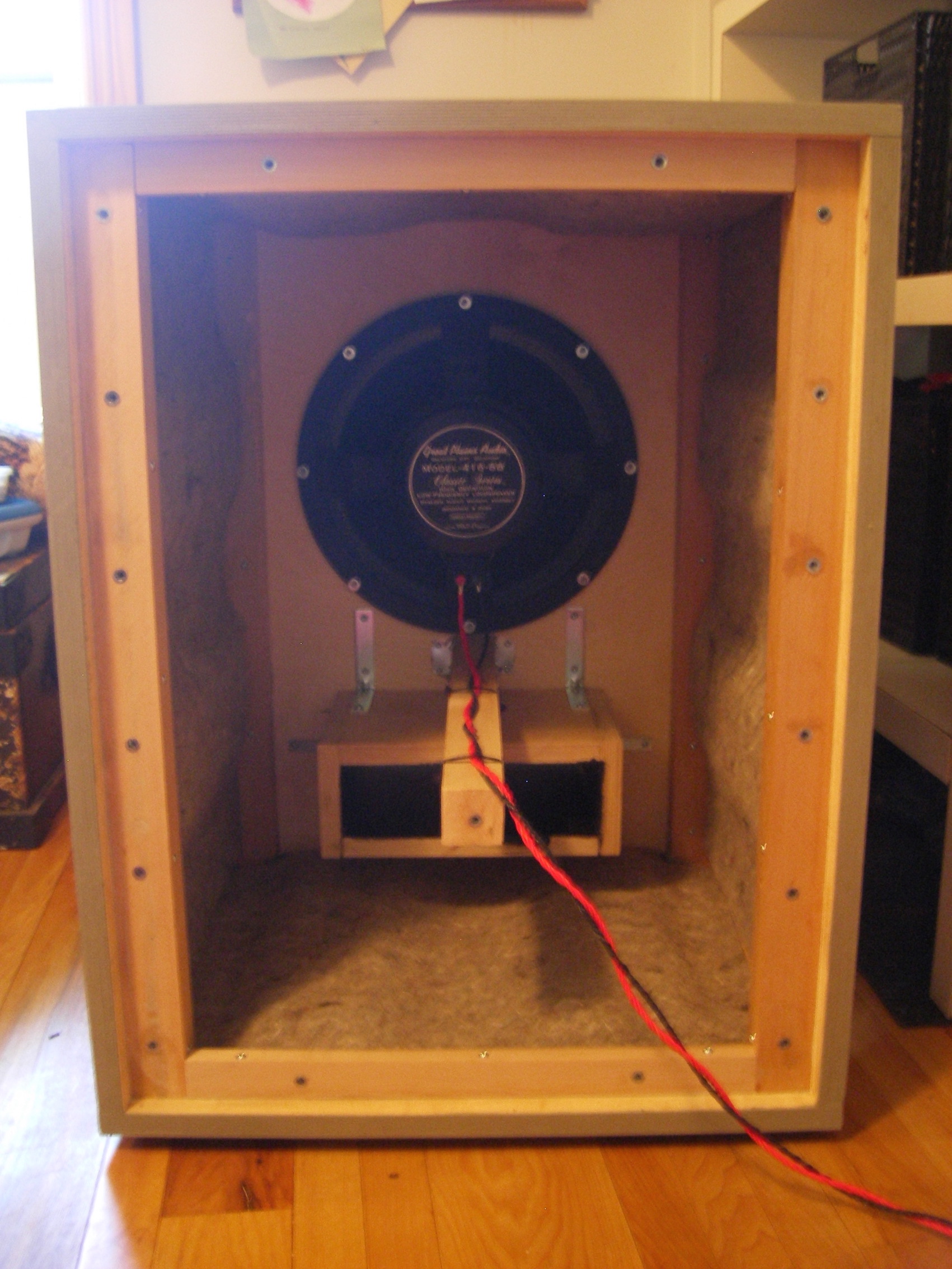

The work really progressed in the last month. I received in April my Great Plains Audio 416-8B. I also had the time in May to start the assembly. Picture don't show it, but I installed felt in the cabs. The port is actually not glued. I made a system which could allow to move it for adjustement. I started with a lenght that Ajmars help me calculate using a Francis Brooke's extremity correction for rectangular port.
Well, speakers are almost ready to be try! I need to sand the boxes, paint them and place the speakers and cables before a first try! I called them "416 French Connection" for inspiration and help Ajmars gave me in the project.
Here's a few pics:

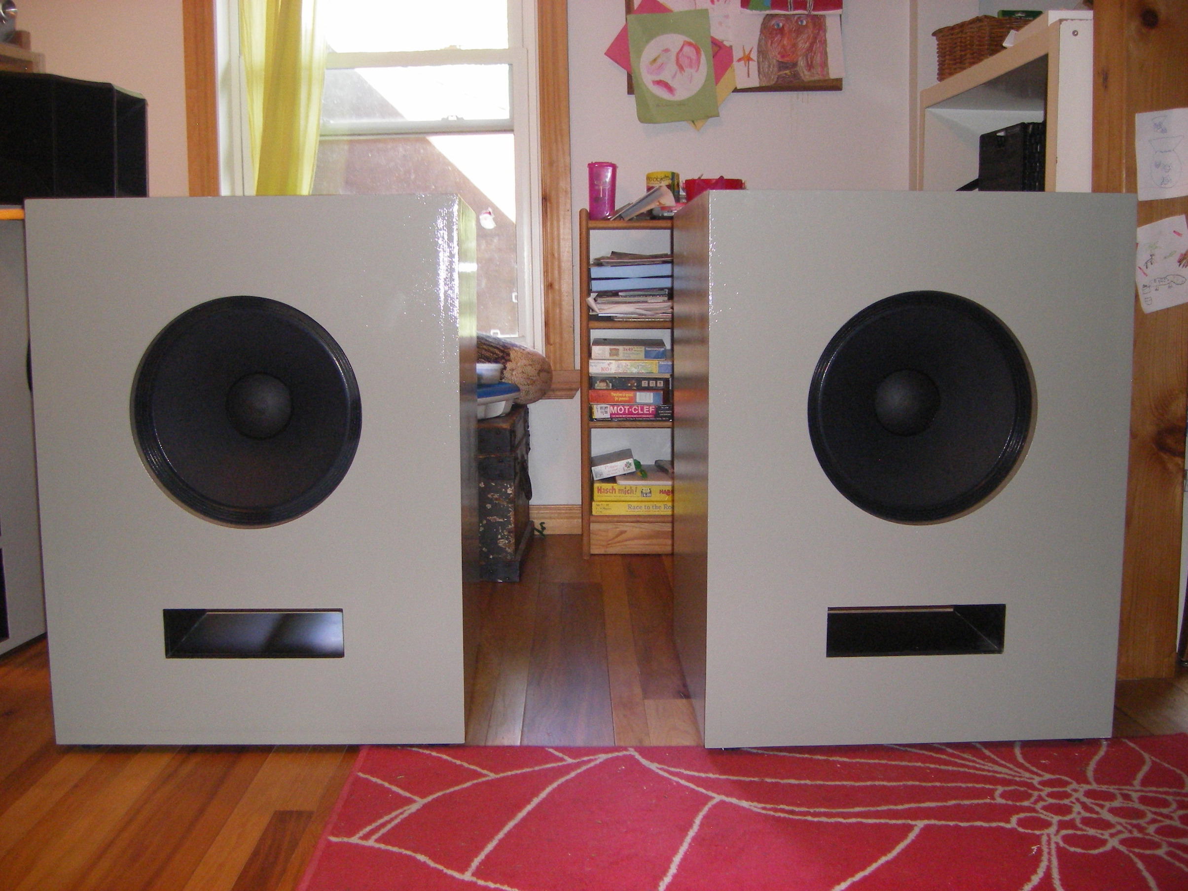

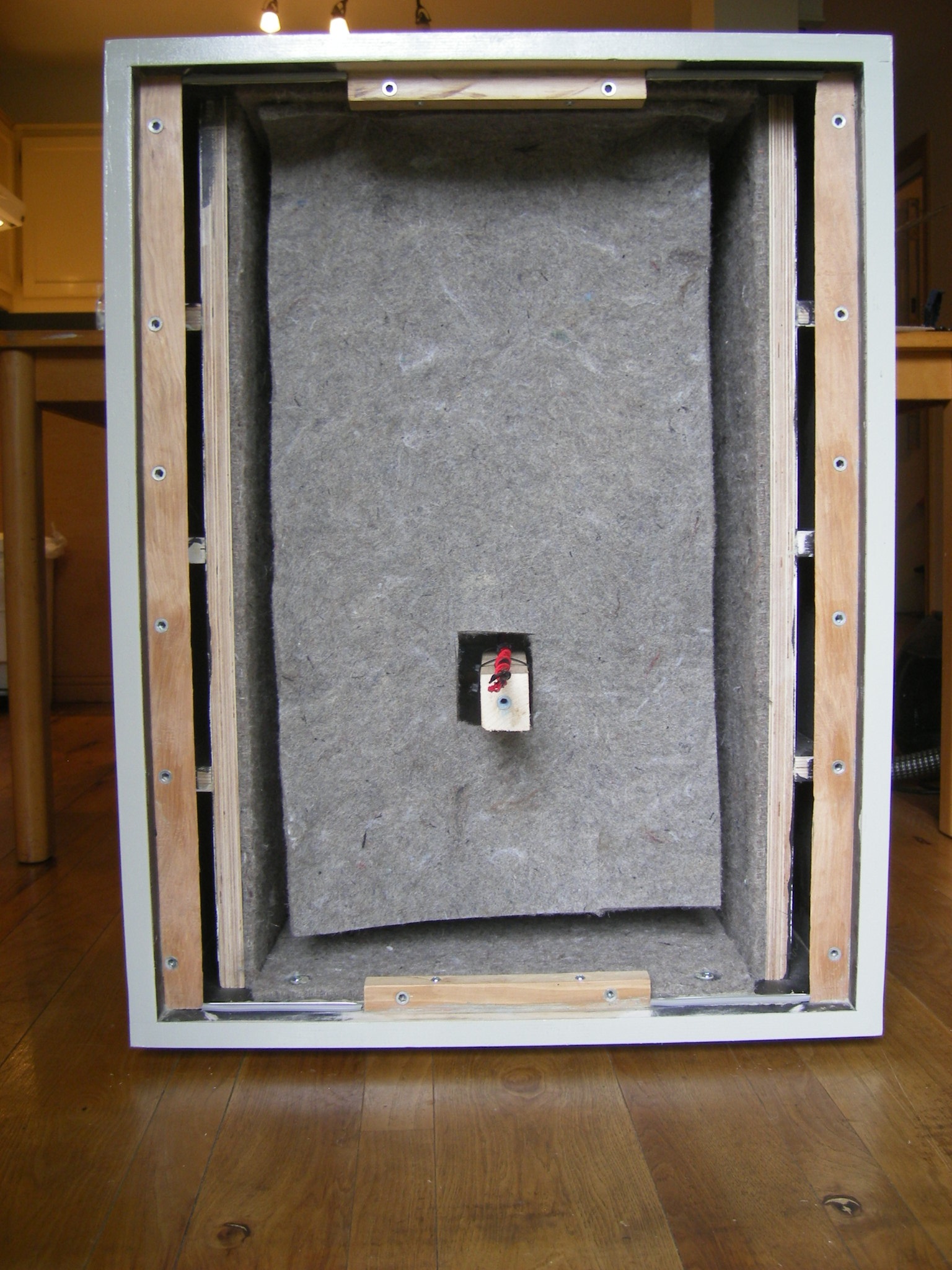

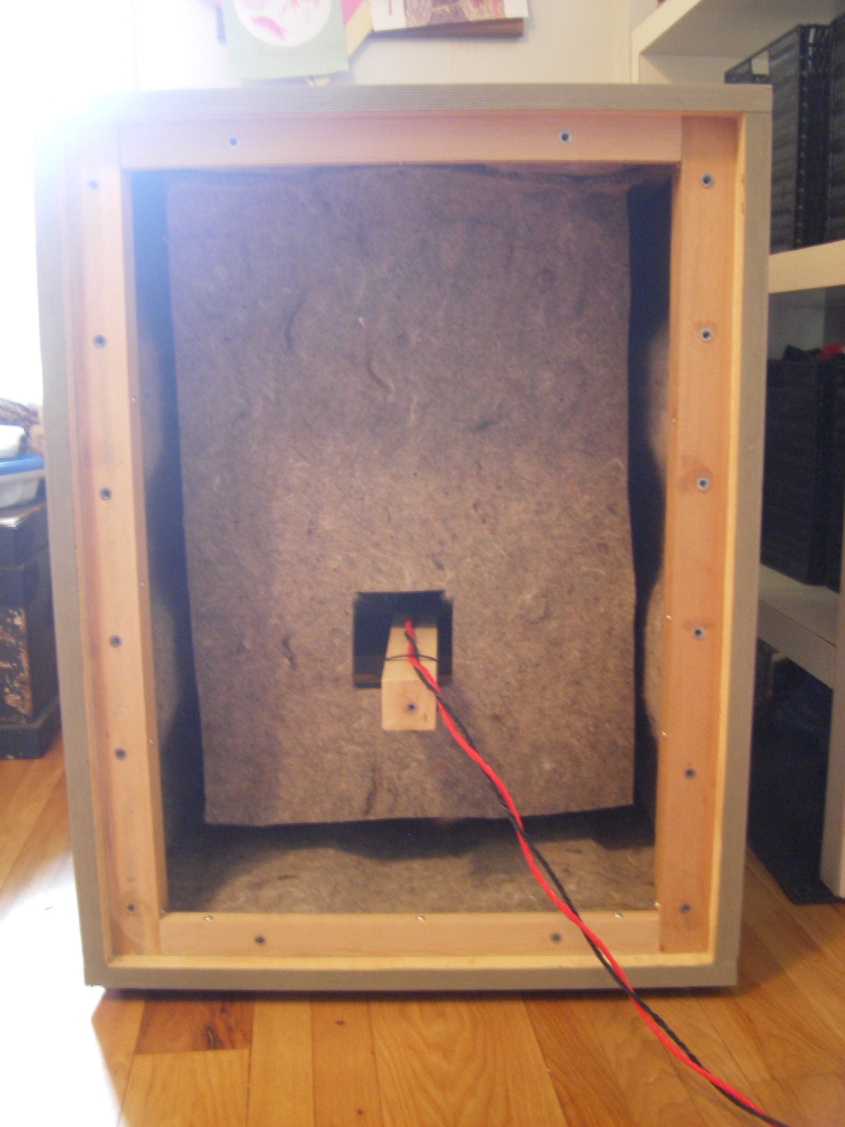

The 416 French Connection are finish since a little bit more than one month. I joined some pictures of them painted. Comparing to the petite Onken, they offer deeper and more extented bass and a bit more dynamic impact, which place them more closer to the kind of impact of a bass-horn cab like a Voice of the Theatre but they are going deeper than the VOTT which the petite Onken already did.
I was wondering if there would be loss in the low-midrange comparing to the excellent GPA 414-8B, but I don't find any. GPA 416-8B has to my ears the same qualities as its little brother and a bit more. I actually cut it around 650 Hz with a second order filter.

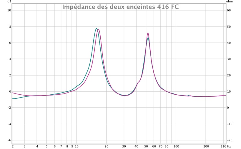

I worked quite a bit to get a good cab tuning and had to play a bit also with internal treatment. I add to the felt 3 polyester pillows and ajust the lenght of the port to 125 mm that was it. You can see on the impedance measure the tuning around 30 Hz.
Sébastien

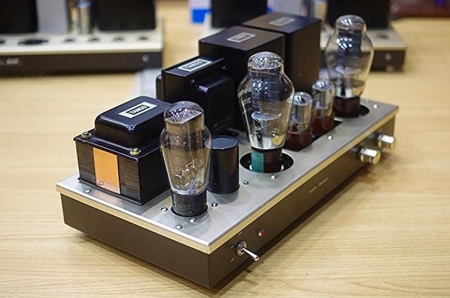

BTW i just want to share some photos of my previous project (June 24, 2016) 360L Onken,
Together with other Big Brother Speakers.
and my newly acquired all Hirata Tango Transformer 300B SET Amp for the 360L Onken
