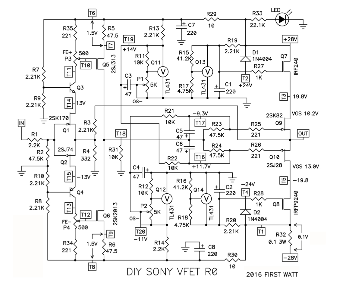

Not so high and likely series regulated, but I have not gotten to that level of detail yet, just setting the stage and generating some ideas while the Tokin SIT are still available. The project queue is two or three amplifiers long at the moment, have to finish a doozy of a tube build first.

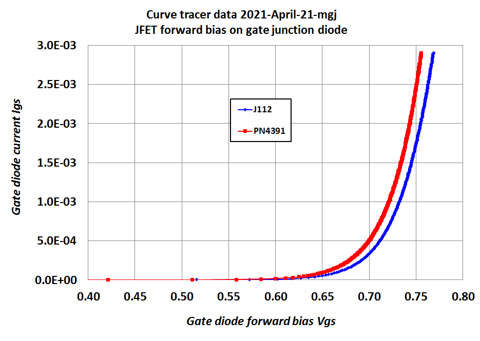

I just wandered into my workshop and put a couple of Nchannel JFETs on the curve tracer. At room temperature, this is how much current flows into the gate of each JFET, when its gate-to-source PN junction is forward biased. Reminder: for an Nchannel device, the gate diode is forward biased when Vgs>0 .
Notice that the two curves are not identical. Different JFETs have different gate diode forward bias behavior. It's not a big surprise.
Also attached is the curve tracer raw data if you want to experiment with it. Maybe you want a semilog plot? I recommend you assume this fixture plus these choices of curve tracer setup options, probably has a "noise floor" around 1E-7 amperes. Thus all reported "measured data" points below the floor, are pure noise.
