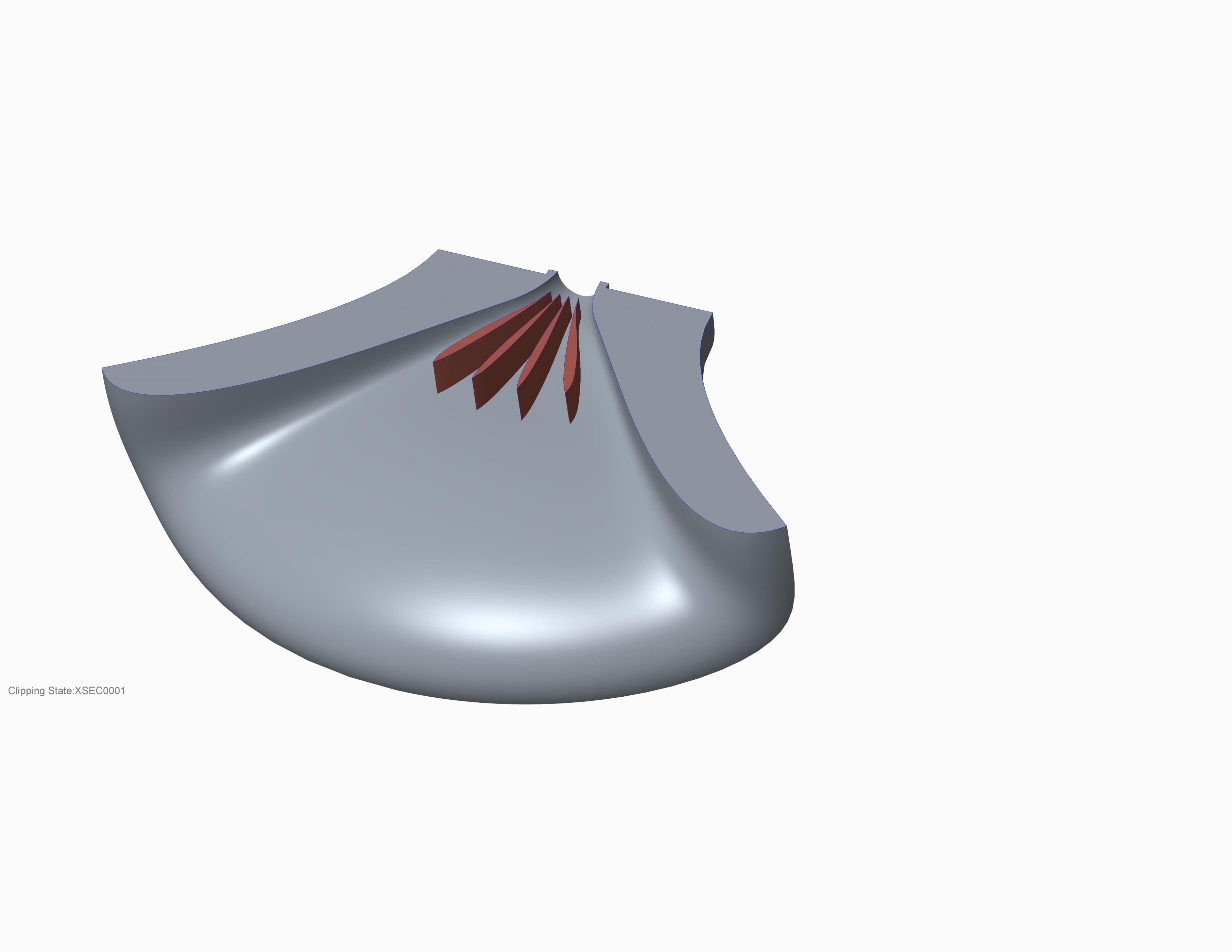

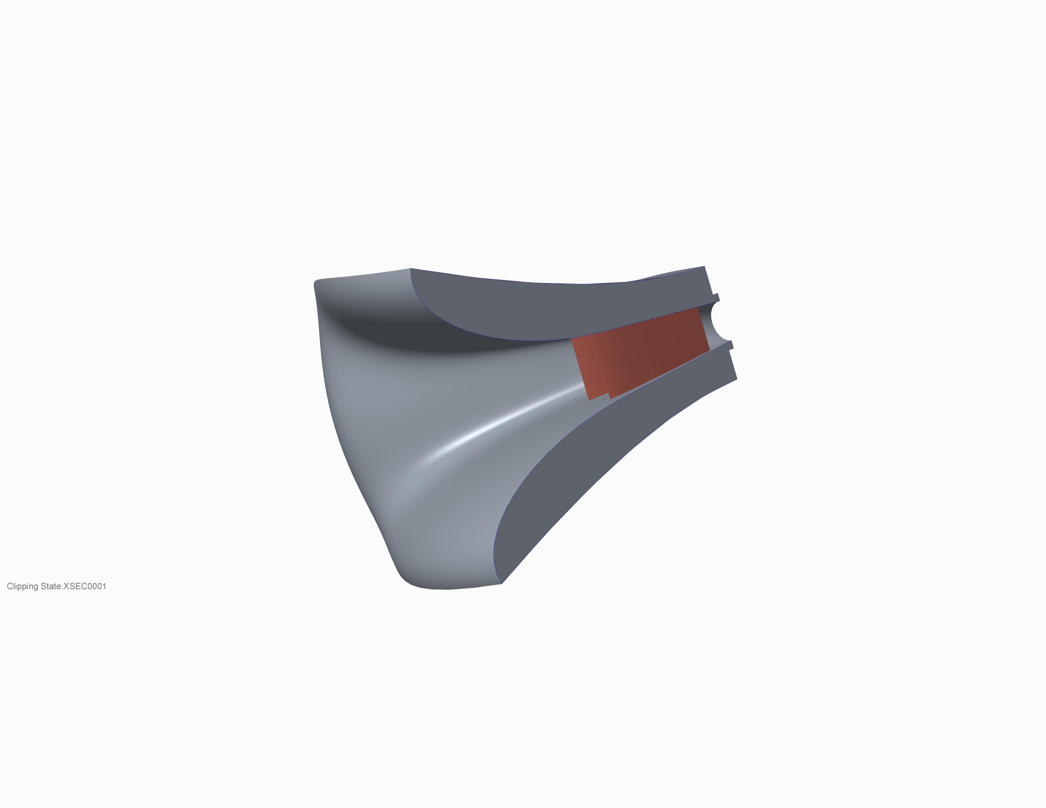

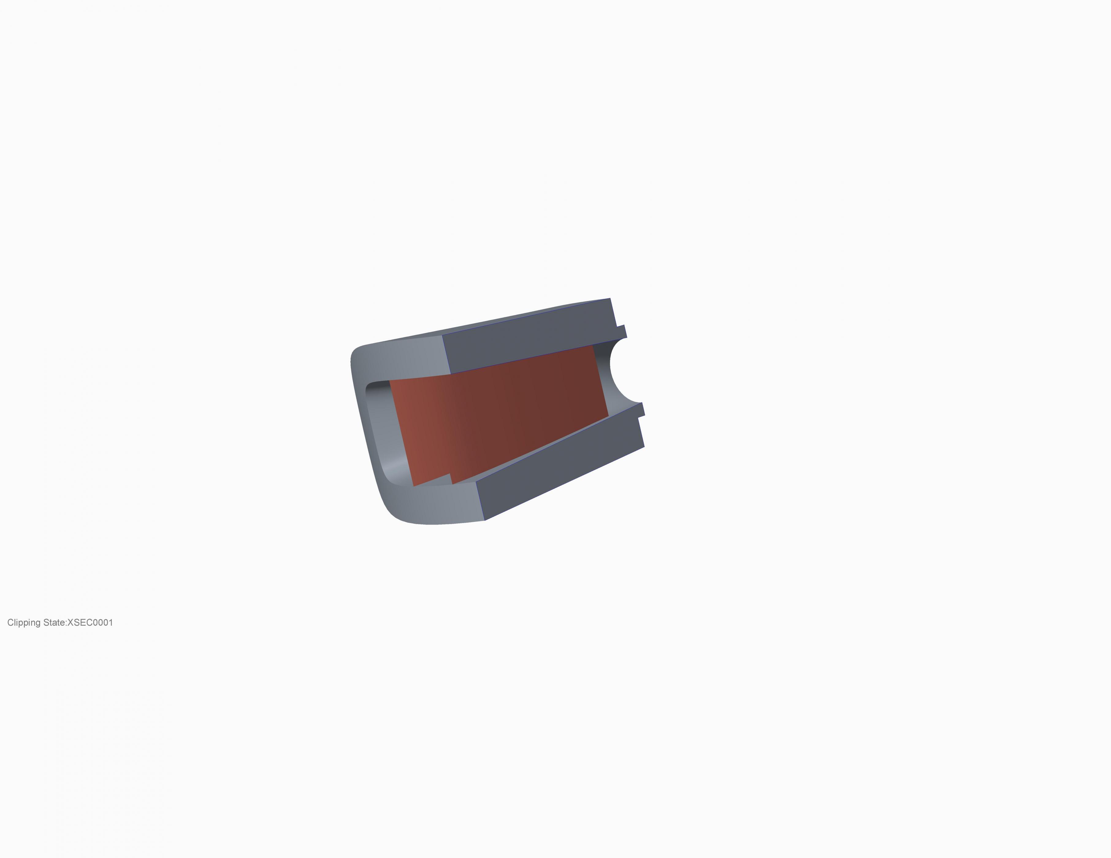

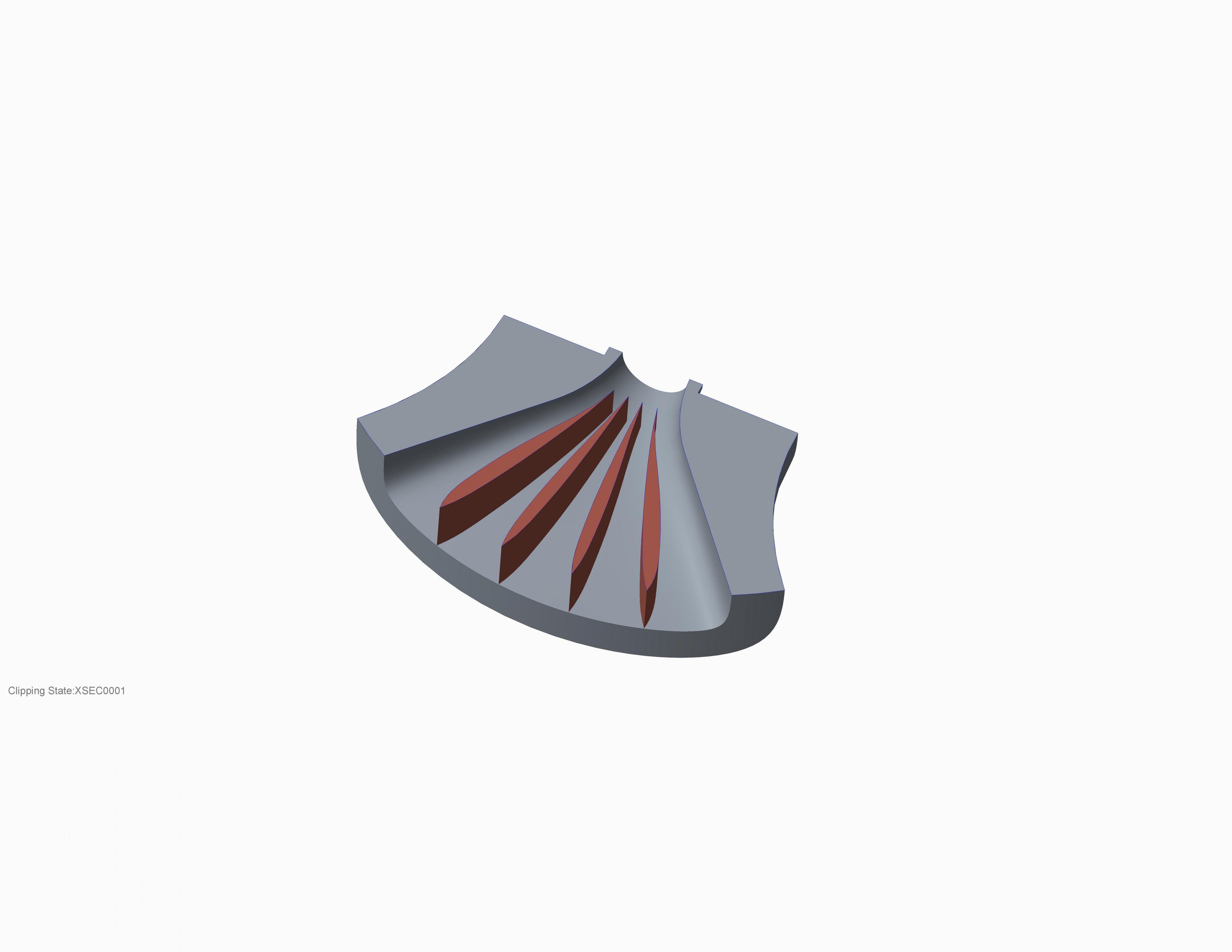

I have had a pair of TH-4001 on loan for some time and i like them. They are of course not perfect but are a good match on many of the parameters that i seek. Eventually they will have to be returned and i need something else. The drivers I have are the TD-4001 and they will stay. I could just make a pair of clones and be happy, but why stop there. The TH-4001 does have some issues that can be addressed, i think that a smoother throat transition would be beneficial, as would a larger mouth round-over. A larger mouth to avoid pattern flip would also be beneficial i think. I will not use the horn below 600Hz so a 300Hz horn will be fine.
INITIAL SECTION
- A smooth horizontal transition from the CD exit angle to the final coverage angle.
- A vertical section that just follows CD exit angle.
- Smooth fins to aid horizontal treble dispersion and give the actual expansion rate.
It can look something like this:
The complete horn can look like below and would end up being a bit over 80cm wide, 40cm high and about 50cm deep. It can be CNC:d in two equal parts that are glued together. This model is actually a 320Hz exponential horn but deviates a bit from that for the last rounding of the mouth.
Comments?
BR,
Anders

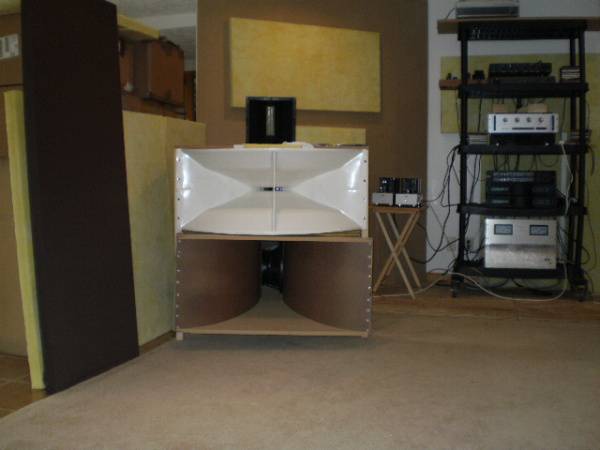

The large wooden horn shown below would do 300-350 cycles with the TAD large format up but was about 2 feet deeper for the 2" throat. I have some radial horns that are 34" wide and 12" tall and two feet deep that have a 220 Hz flare and they will only load the driver to 500-600 cycles.
What you imagine doing and getting good results ? Likely not - the big multicells sound no better, a big radial like the EV "Great White Whales" might be alright for you? I couldn't get good sound crossed below 600 Hz with them.
