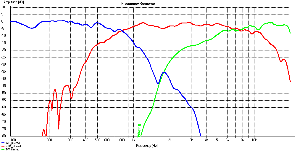

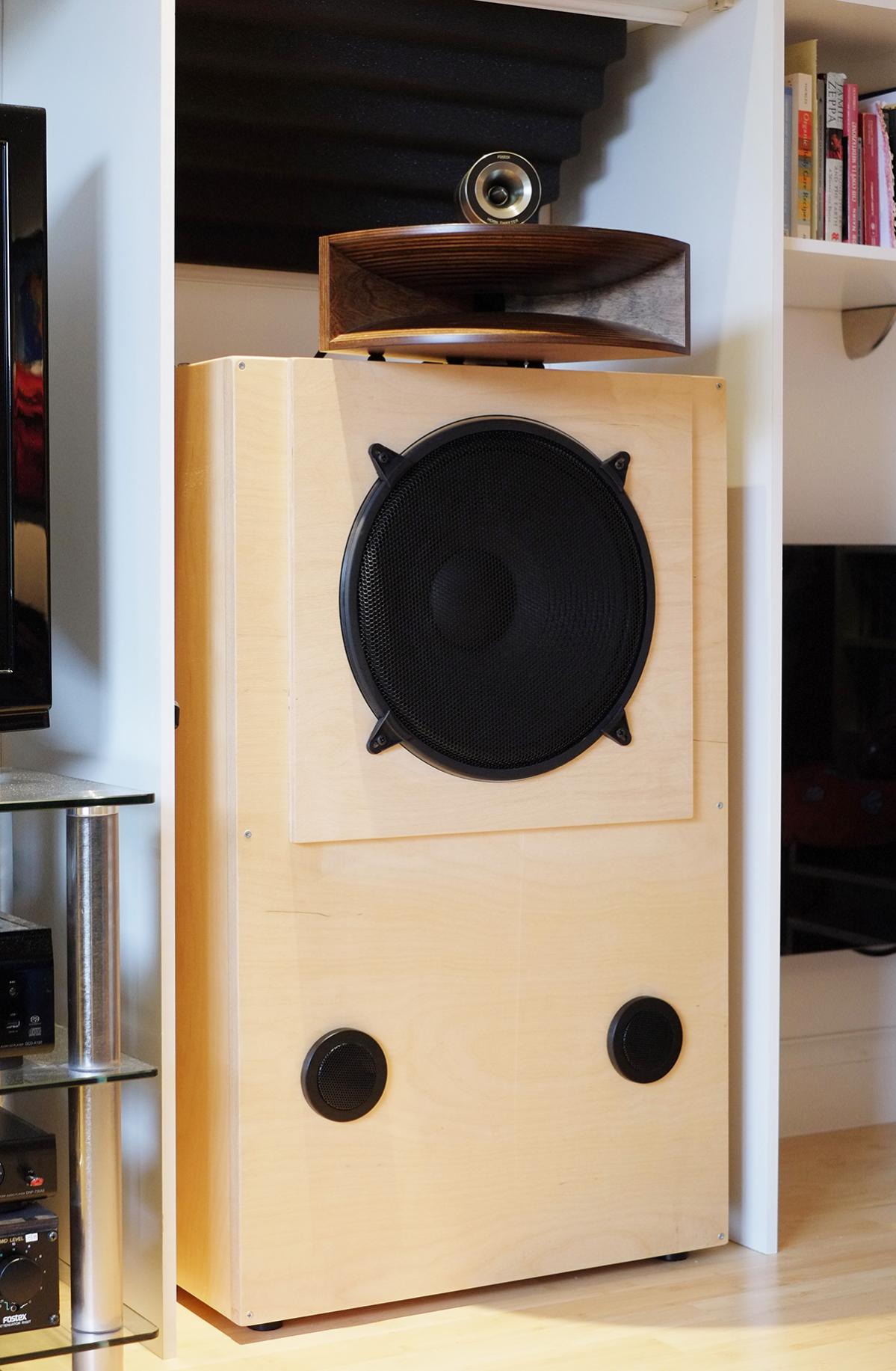

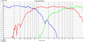

Hi all,
one thing that I noticed in this wonderfully informative and thought-provoking thread is a rather puzzling dearth of actual complete build examples, supported by actual measurements.
In an attempt to buck that trend, I hereby offer my own design for scrutiny, which, even if not fully "beyond the Ariel", still by and large shares the same fundamental principles.
1) DRIVER SELECTION
WOOFER: Fostex FW405N (FW405N | FOSTEX)
This is a modern woofer of recent design, with a hybrid cellulose+carbon fibre cone and a newly developed aluminum die-cast frame based on FEA. Magnet is ferrite, and sensitivity is medium-high at 92.5 dB/W(m) (declared) / 94 dB/W(m) (calculated based on the T-S parameters).
Two features that attracted me were:
(i) its medium-low overall damping (Fs/Qts = 60), which allows to use an overdamped bass-reflex box characterized by very low Group Delay (Vb = 2 * VAS * Qts) and still get an F-3 = 40 Hz;
(ii) its very low mechanical damping (Fs/Qms = 4.0), which in my experience is a recipe for excellent low-level detail retrieval.
By way of comparison, this is roughly the same mechanical damping as that of the GPA 416 (Fs/Qms = 3.4) and the TAD TL-1601a (Fs/Qms = 4.1), and HALF of that of the JBL 2226H (Fs/Qms = 8.0).
COMPRESSION DRIVER: Fostex D1400 (D1400 | FOSTEX)
This is an 'old style' 1" driver with a Ti-alloy diaphragm, half-roll surround and massive AlNiCo magnet. Its internal structure is basically a copy of the TAD TD-2001, with a large back-chamber and an internal conical throat characterized by a low cut-off frequency of 400Hz. These characteristics allow it to perform very well down to much lower frequencies than most modern 1" drivers (at domestic levels, of course, and when coupled with a suitable horn). In fact, its minimum recommended crossover is a low 750Hz (presumably when used with Fostex's own larger H300 horn).
HORN: Fostex H400 (H300/H400 | FOSTEX)
This is where I decided to go 'all Fostex' and try my hand at a 'classic' radial exponential horn (Fc = 455Hz)... but with a few caveats! In fact, this horn differs from e.g. the 'über-classic" Altec 811 in two important ways:
(i) it is carved out of a block of dense high-grade sugar maple plywood (density = 0.67 kg/dm3). This gives it excellent self-damping and prevents the notorious 'ringing' of the classic metal horns.
(ii) its (cast aluminium) throat adapter is perfectly matched to the driver's internal 400Hz flare rate, and operates an extremely smooth transition from the driver's 1" (25.4mm) circular throat to the horn's 35x35mm square throat.
Of course, all this does not change the fact that this is still a 'flawed' design in the other classical ways (calculated based on Webster's equation assuming cylindrical wavefronts, producing some diffraction at the adapter/horn throat interface and at the horn mouth, etc.). But my hope in selecting it was that the two positive points listed above would go a long way in minimizing any unwanted 'horn honk'...
Super-TWEETER: Fostex T925A (T925A | FOSTEX)
A classic 'bullet' tweeter, with an aluminium ring diaphragm and large AlNiCo magnet.
2) PASSIVE CROSSOVER:
For the Woofer-Mid crossover, I got inspiration from the design used by Pioneer in their TAD/Exclusive monitors (EXCLUSIVE model2402), and later reprised by Shozo Kinoshita in his Rey Audio monitors (RM Monitor), and I designed an asymmetrical 6th-order low pass / 2nd order high pass.
The crossover frequency was chosen to be 850 Hz, so as to:
(i) match the horizontal directivity of the Woofer to that of the radial horn (110 degrees);
(ii) stay approx. one octave above the horn's cut-off.
When both the Woofer and Mid are connected with positive polarity and the Mid is phisically set back so as to create a suitable offset between the two acoustic centres, this crossover results in the emissions of both drivers to be in phase over a relatively wide frequency range around the crossover frequency [see actual measurements in FIGURE 1].
This type of crossover is handy in several ways:
(i) the front-to-back offset allows the convenient positioning of the horn-loaded mid atop the Woofer box without requiring any form of delay (digital or otherwise);
(ii) the same offset also happily results in the two impulse responses to be almost perfectly 'time aligned', i.e. both traces leave the horizontal line simultaneously [see IR measurements in FIGURE 2];
(iii) the 6th-order low pass effectively does away with any unwanted resonances at the top of the woofer's operating range.
For the second crossover between Mid and super-Tweeter, I opted for a symmetrical 2nd-order Buttwerworth at ~7.5 kHz, which gives a Constant Power response.
The super-Tweeter is not time-aligned because:
(i) at such high frequencies, the human auditory system's sensitivity to phase is reduced;
(ii) the resulting comb filtering pattern is essentially inaudible since the narrow notches are within the ERB (https://en.wikipedia.org/wiki/Equivalent_rectangular_bandwidth);
(iii) having an intentionally misaligned constant power crossover at such high frequencies results in a smoothed summed response that is essentially invariant over a +/- 30 degree listening angle, since any additional misalignment introduced by moving the head laterally is swamped by the the >360 degree original misalignment.
I realize this design choice may be somewhat controversial, but IMO while it looks bad in a simulation, it actually sounds better than any other option (i.e. better than just going 2 way and making do with the compression driver's response over the top octave, and better than trying to obtain a time-aligned all-pass crossover between the mid and the supertweeter, and then living with the 'hole' in the summed response that is produced off axis).
From a practical point of view, the complete crossover was built using quality parts (Mundorf coils and Jantzen MKP capacitors), and housed in two external wooden boxes [FIGURE 3].
The woofer low-pass section [FIGURE 4] uses a semi-balanced topology to reduce crosstalk with the mid and tweeter sections [FIGURE 5].
Both the compression driver and the super-tweeter are attenuated using variable units by Fostex (R80B/R82B/R100T | FOSTEX), respectively the transformer-based R-100T for the CD and the R-80B potentiometer for the sTw.
The resulting system impedance plot is shown in [FIGURE 6].
The final system's measured in-room response (unequalized and not corrected in any other way) is shown in [FIGURE 7], with superimposed the well-known Bruel & Kjaer 'target' function, as well as a +/- 3 dB tolerance band.
And to conclude, a picture of the full system taken from the listening spot [FIGURE 8].
C&C welcome!
Marco

I feel it's safe to hold the round cross section to at least 15cm across but I'd like to cut this as far as I can.
I'm good with rectangular, so are my walls, naturally the dome isn't. Some choose to make the transition right near the throat, where would be best?One interesting thing is that if this transition is done right, the rectangular pattern will 'hold' for very long distances,
If by that you mean the independence of H and V (and hence a continually changing aspect ratio) isn't bad if the source is transitioned well that way, then that's good.Some folks obsess over this pattern 'distortion', though IME, it's not the rectangular pattern, but the transition section.
I've always felt it best to do aspect transitions either very early or very late, now I'd like to do one in the middle. 😱judging by Dr. Geddes's much more recent 'round to round' WG transition observations about how critical they are, I consider it 'carved in stone' now.

In that particular 2386 horn I never used the TAD and the rest of the 2" drivers I have used are more intended for midrange low treble. I would not use a large format driver past 6K anymore because I have found one inch drivers that handle the treble with a lot less "splash" and sizzle. Some drivers I have found that work great in radial horns is the Community M200 (to 3k), Gauss 4000 (4k) and the EV DH1A (5k) with the aluminum DH1012 diaphragms. I have been told by a very reliable source the TAD 4001 can be used higher in radial horns (the TAD radials) without the up front sound you get in the round horns but never tried it. I'm sold on a separate treble horn with 1" drivers. If you have the TAD drivers I suppose you may be happy going higher.
Just make your mid/high horn the same aspect ratio as your bass horn - and Bob's your uncle!
I'm all B&C but happy at this point. I'm also fairly firm on separate treble but the thought of a single horn two way to 200Hz is shaking my foundation. I thoroughly considered separate horns and each way came out near identical except the mid starts later down the throat.

I want to rephrase this. I have the old plan written down somewhere.. mid entry 7cm from the mount where the mouth is at 12-15cm across, 60-70 degree round OS before that point then hypex T=2 or 3, 80 degrees at 1k, 90 at 700, H out by 500, V out by 350 or thereabouts.I want the horn to have the flattened profile before the smaller dimension exceeds 6cm, but I want the horn to be round until the mouth exceeds 6cm.
If radial then H would be the same.
That's where I was at. The mid horn ended up being the hypex section on its own with a lowish compression ratio. I was going to make a mould so I could do four mouth sections.Just make your mid/high horn the same aspect ratio as your bass horn - and Bob's your uncle!
I read Poohs comments and I must have regressed about a month. Don't worry Pooh, this is just a hobby (though I've been known to help schools and churches). Indecisive is just a state of mind.. I think.
