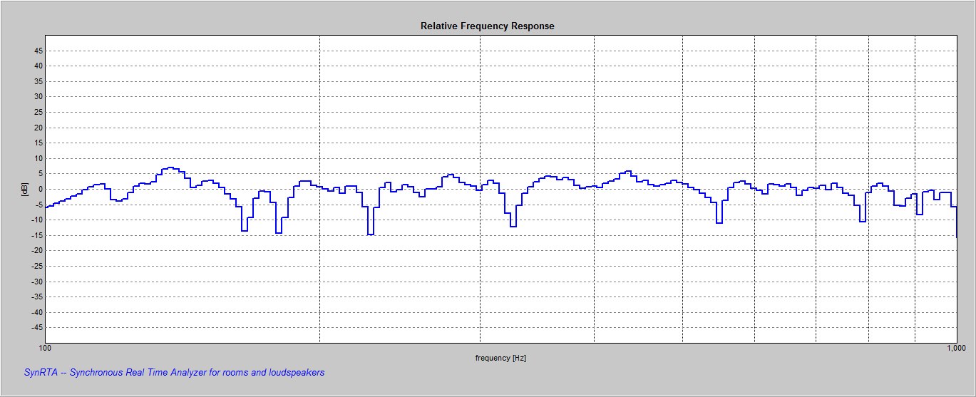

My upper bass low mid horn at 5 meters - listening position no filters 8PE21 - back chamber removed - nice bandwith - time to put these babies together

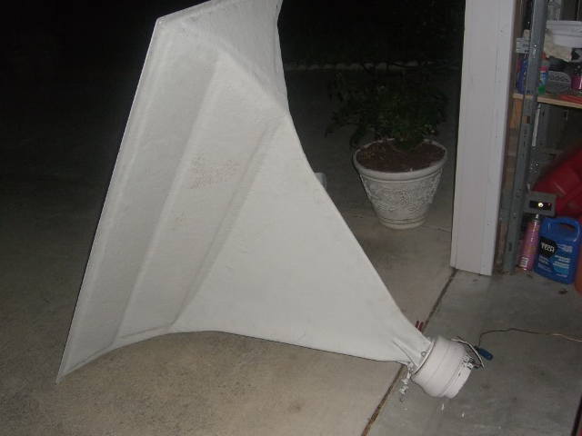

I have several pairs of 811 horns and have used one pair as an on going experiment.
The first thing I tried was to cut the welds on the vanes because some people claimed it would reduce ringing. It didn't do as much as pressing a block of duct seal into the back of the horn bells. I also tried applying damping material to the outside of the throat area up to the mounting flange, which works OK if you don't have the horn mounted. If it is mounted, that provides a greater reduction in ringing than pretty much anything else.
The most effective mod I tried was to fill the internal weld seams with body filler and sand them smooth. This produced substantial audible improvements in the reduction of the sometimes harsh sound of the 811 horns. I switched back and forth between unmolested 811s and the filled versions and the difference was repeatable. I used Model 19s as the test bed.
It's surprizing how large the groove between casting halves is and how much misalignment there is between the halves. There is often quite a bit of weld spatter on the interior as well. I've been told that smooth is the answer for horn interiors so it can't hurt to clean them up at the very least.

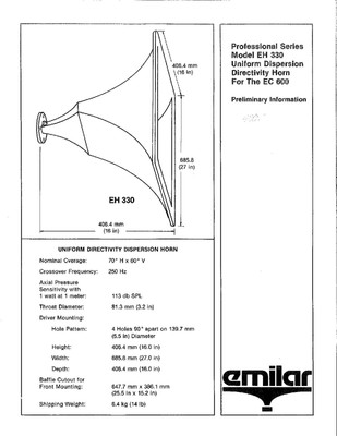

That looks like an EV CD horn with the slotted throat. It looks like the flare changes where these keep constant
Like the Emilar horns in this link ƒ~ƒbƒh�EƒŒƒ“ƒW�Eƒz�[ƒ“
University did it a lot with treble horns
what i'm working with is the EH153 Emilar horn with B&C 8ep1
The smaller EH330 http://i.ebayimg.com/00/s/MTYwMFgxMjM2/z/rc8AAOSw8lBTlmKm/$_1.JPG
When cutting out the vane welds, the gaps ideally need rubber wedges inserted, though most just apply some sort of rubbery silicone caulk. If done to the 511, then the small vertical brace further up the horn needs to be removed and some claim it should be done regardless.
Right, the entire inside of the horn ideally needs to be smooth, sealed to a very low friction; ditto the mouth transition/mounting flange; ditto matching driver, horn throat via align honing, replacing the cardboard washer with a machined one and all with wax paper or similar gaskets, which yields the greatest overall improvement IME.
Note too that mounting the horn to a proper baffle goes a long way to damping the mouth by itself, ditto adding a foam mouth 'extension' similar to the M19's, later Valencias, etc., though I found I preferred somewhat more damping than the more decorative ones Altec used.

I should have mentioned the silicone filler. I did that as well based on a recommendation by you. I eventually cut the vanes out completely and ground them flush. As I was just using this pair as a tester, it didn't seem like a loss at that point. I found no difference in how they sounded with the vanes removed compared to my unaltered 811s. I may do this to a pair of 511s eventually.
I also removed the cardboard gasket and used waxed paper in it's place. The throat in my 802-8Gs have the same exit diameter as the entrance to the horn throat so the thinner no stick gasket was fine. The mating surfaces on both were very flat and I could detect no air leakage.
It's amazing how much better you can make a perennially maligned horn like the 811 sound with a little experimentation and elbow grease.
Interesting. I never went to that much trouble with the 811 or 511, just moved on to the multi-cell horns. Nice to know real improvements can be made.
The most I did was to add a soft edge of foam or beach towels - and that made a slight audible difference and was easy to see in measurements.
I have Model 19s which are already one of the better implementations of the 811 so it seemed like a good idea. I also had several extra 811s and some idle time🙂
