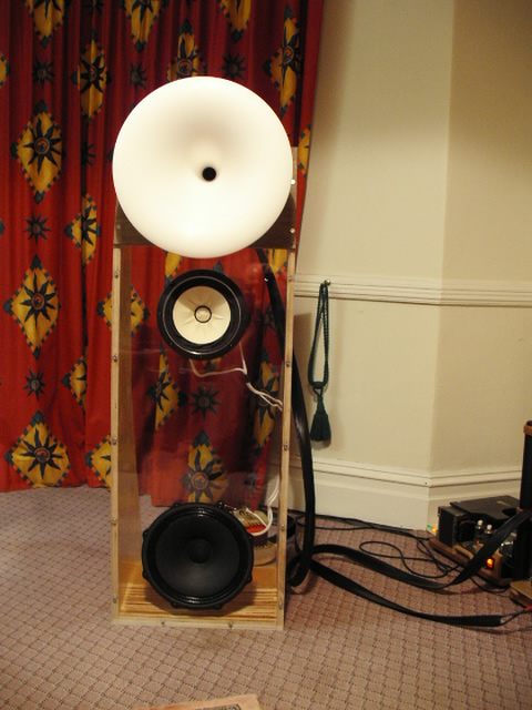

POOH, do you have any more details or links to the system pictured? It's very similar to a design I have sketched up and just wanted to read more about it.

It's a system I built around 2001? lol Deep bass was four 2235 JBL's push pull per channel up to 60 (sand amp), them twin Altec 416 a side up to 200 to Adamson Kevlar 10" compression drivers (MONSTER compression drivers - lol - less the phase plugs) in Sierra brooks 180 flare tractrix horns to 300 flare Sierra Brooks tractrix horns loaded with TAD 4001 (Parallel 6C33 SET) TADs i think crossed in at 600 cycles - the system sounded pretty bad in that hotel room although dome people said it was the best they ever heard LOL - I build for my room, I'll never lug a system to a hotel room again

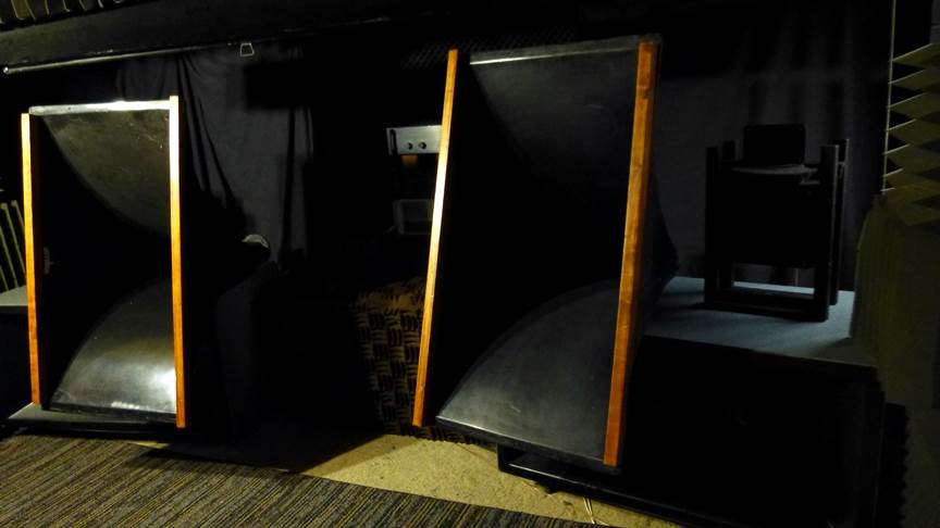

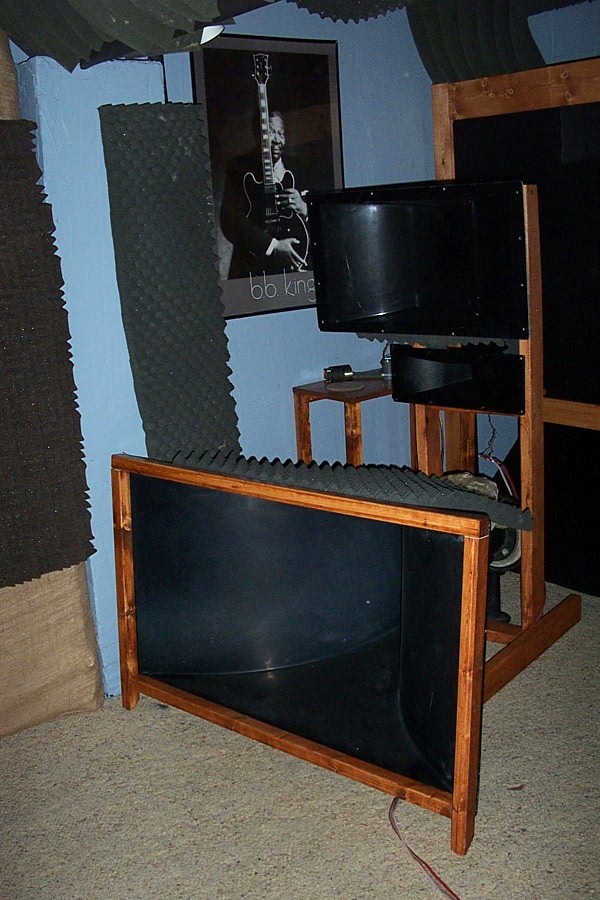

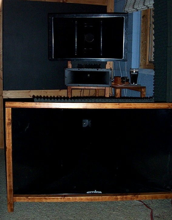

An Emilar EH153, full size 150 Hz horn built for free space, when used on the floor near a wall they go below 100 cycles with B&C 8Pe21, I now have them elevated a bit and cross in around 120.
Here is an old system when I used them with the 6" aluminum phram 3" exit Emilar EC600. The 8" B&C is better by a wide margin up to 1K - the EC600 actually was nearly flat to 3K in these horns 🙂 They are really good midrange drivers - the midrange horn above is the EH330 horn that also had the EC600's in them

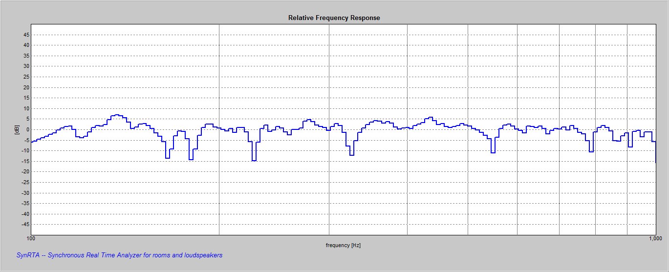

The horns measured at the listening space (15 feet - listen closer now) with 8PE21 no back chamber 1/48 smoothing pink noise
With the back chamber at 12' they are WOW

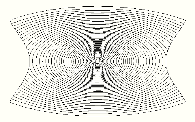

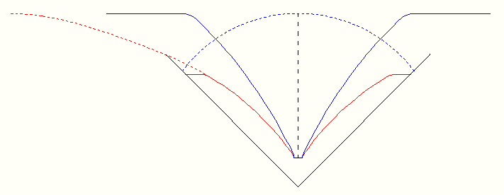

I'm not on the same page yet, give it time maybe, but I've managed to draw the (axial only) version of where I'm at. It's a waveguide only, OS-hypex-(radius-baffle highs)/(secondary flare lows).'Sounds' then like you need to figure out how to 'streamline' an Altec Mantaray diffraction horn.
It fills the goals of: floor-30 degrees to 500Hz, ceiling-40 degrees to 300Hz, sides off the room walls to 700Hz and on below.
Next moves: consider radial mouth, opening out the corners and closing up the throat.

Is it possible than without the rear box : the 1 mm MMS max of this B&C to be the culpritt ? (vs the WOW rear 12' your are talking about after)
What is the back chamber at 12' please ? (rear wall of the sealed cabinet?) : do you have more clearness with it ?

Rear chamber is tuned to 110 cycles, sealed of course. The horn length is 44.5" throat entrance (modified) to mouth axis with a 4" entrance and mouth is 26" by 46" - it's quite a bit bigger than either of those horns. No culprit with xmax 😉

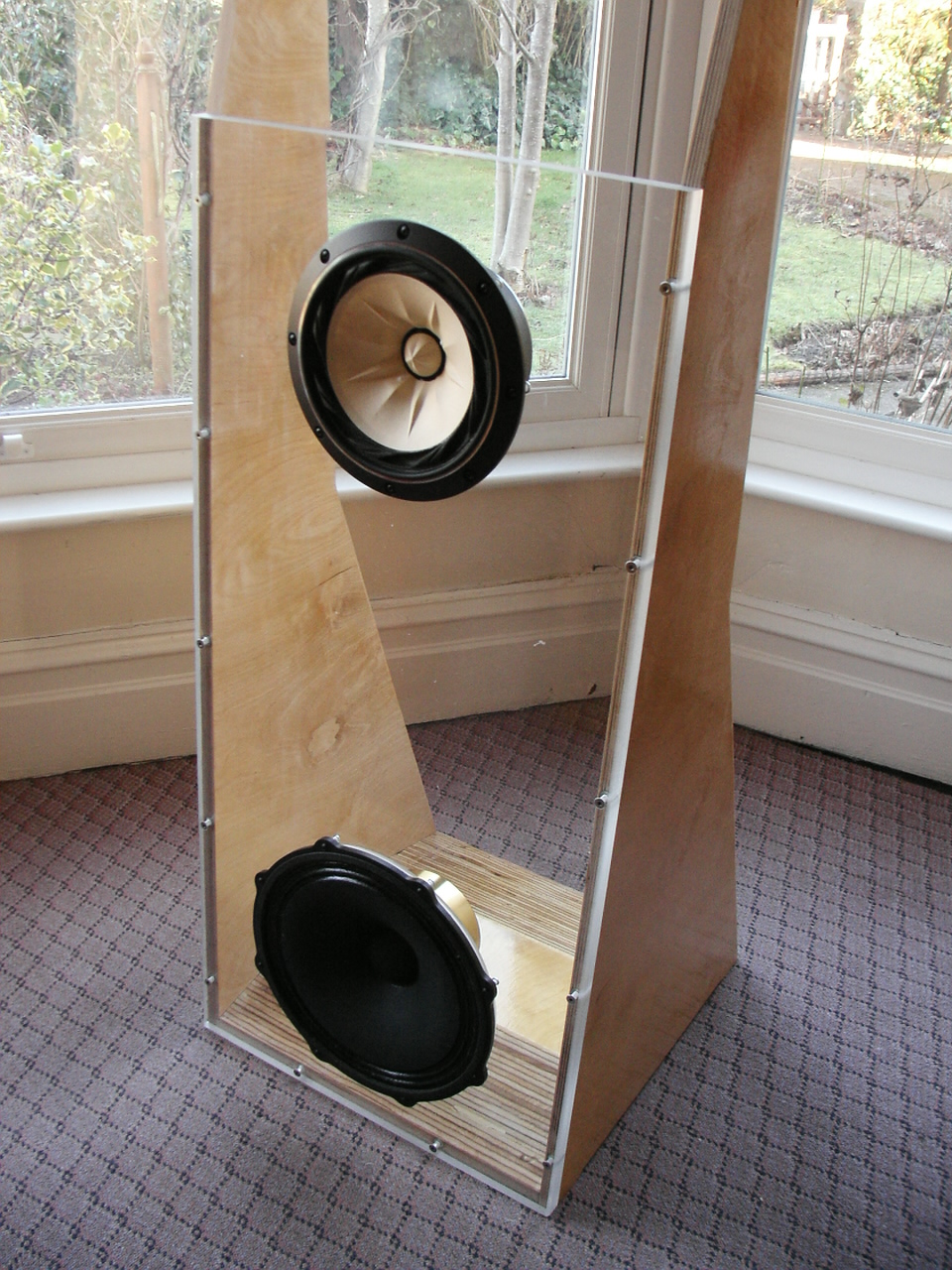

Very good driver, excellent tone. I currently have a pair doing lower-mids on 20mm perspex/birch OB .

Ah, the larger mouth of the Emilar seemed to make it less long on the photograph !
It's a pretty big horn - B&c is sounds very fast dynamic and detailed with great tone. When horn is lifted beyond 1 foot the response below 200 cycles drops - this was some experimenting - they are now coupled to side wall and floor. There is a cabinet behind the 8" it is sealed and tunes to 110 hz

Sounds intriguing - could you post a photo, please?Very good driver, excellent tone. I currently have a pair doing lower-mids on 20mm perspex/birch OB .
I have a couple of shots from a while back of the OB's with Fostex Fe208Ez in place - hope these give the general idea of construction. To be honest I still haven't got the ideal driver in place , the lower driver is a Supravox 285GMF and the upper would really be best as an AER Mk.1 or an Enviee ( Joachim Gerhardt ) for the correct Fs, Q, and sensitivity to work with a 150-200Hz crossover in the series crossover there. The B&C 8PE21 forces the crossover to 350 or 400Hz which is too high.
The OB is based on James Doddington's 'Quasar' OB originally presented on BD-design's forum.

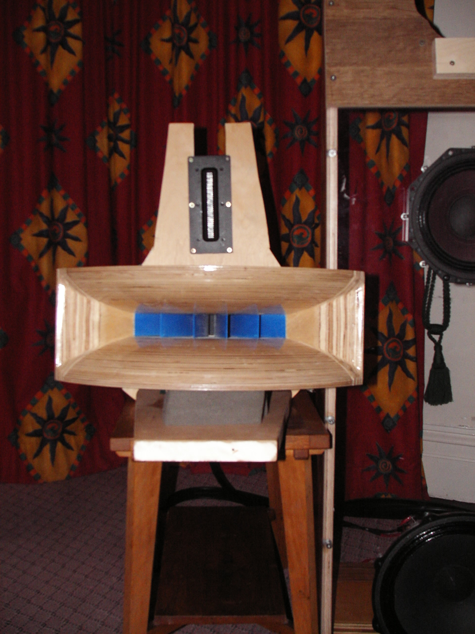

Horn used above, from 700Hz upwards - currently working on the second of a pair of scaled-down A290 Yuichi horns ( 415Hz for 1.4" drivers) - see third picture ( with Aurum G3 ribbon ) .
