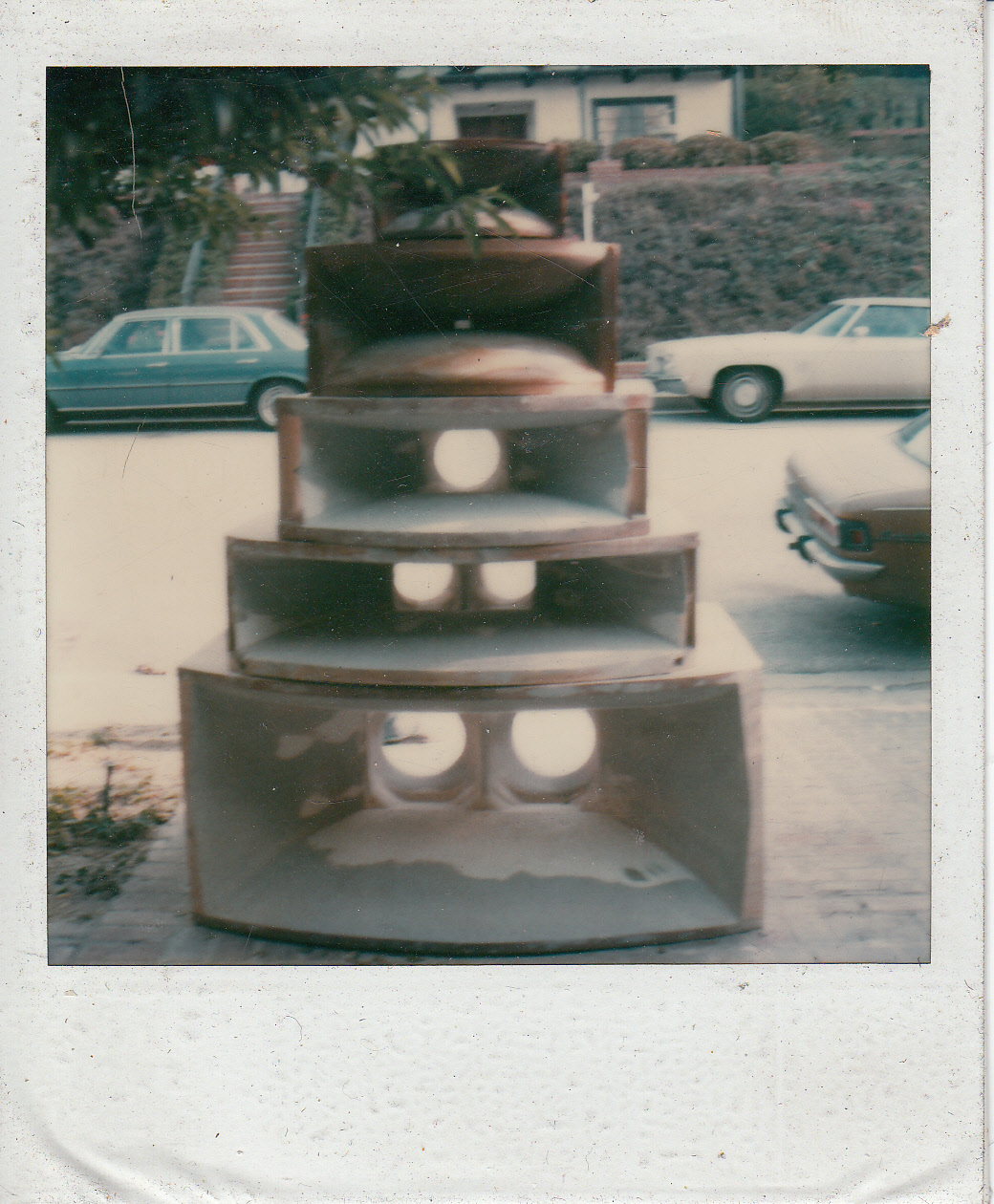

Here is a very old picture of some radial bass horns from 1976 that I developed so far in the past. These were all prototype designs. Dual 15" and dual 10" radial cone loaded with the same early conception. The horns were molded and reinforced with urethane foam. This was when I held a patent for the process of making foam molded horns and the mathematical definition of the sound chamber to load a cone driver, very early ideas that I developed.

Thanks for more good stuff Kindhornman.
Wish I could have been your helper for many years, many years back.
I think this thread knows you know your stuff.
Being able to divert from the horn world to other methods you believe to be close but more livable says even more about your confidence.
