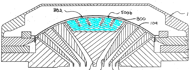

I agree the Radian compression drivers are just so so as far as sound quality. ...........
and also drill a small hole in the center of the phase plug and stuff if with something to change the top end resonance. He was an engineer there a long time ago. ......
Hi Kindhornman,
May something like in the US20080192972 patent ?
regards
ivica

Hi Kindhornman,
regards
ivica
If stuffing the big back chamber doesn't help, how would stuffing that small front chamber help?
