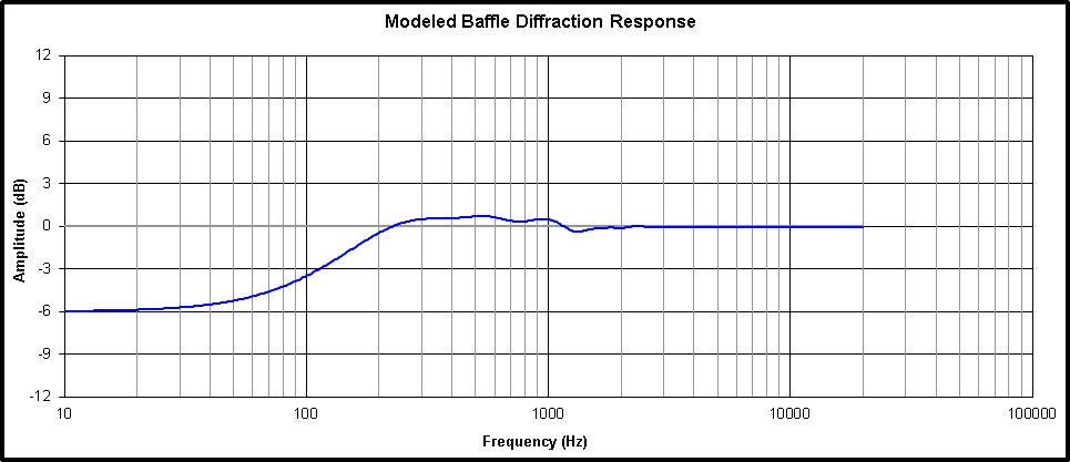

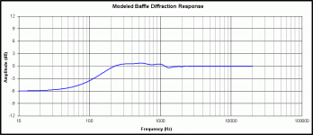

Hello Marco, I did not see - do you use baffle step correction for the bass? Is this speaker over 90 db/w/m sensitive? How do you find the fostex attenuators for fine adjustments?
No, I do not.
As you can see in the attached graph, the wide baffle pushes the 'step' frequency down to below 200Hz (i.e., into the modal region), and the speakers are positioned very close to the front wall.

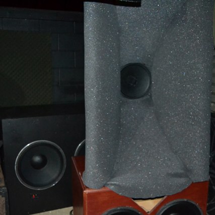

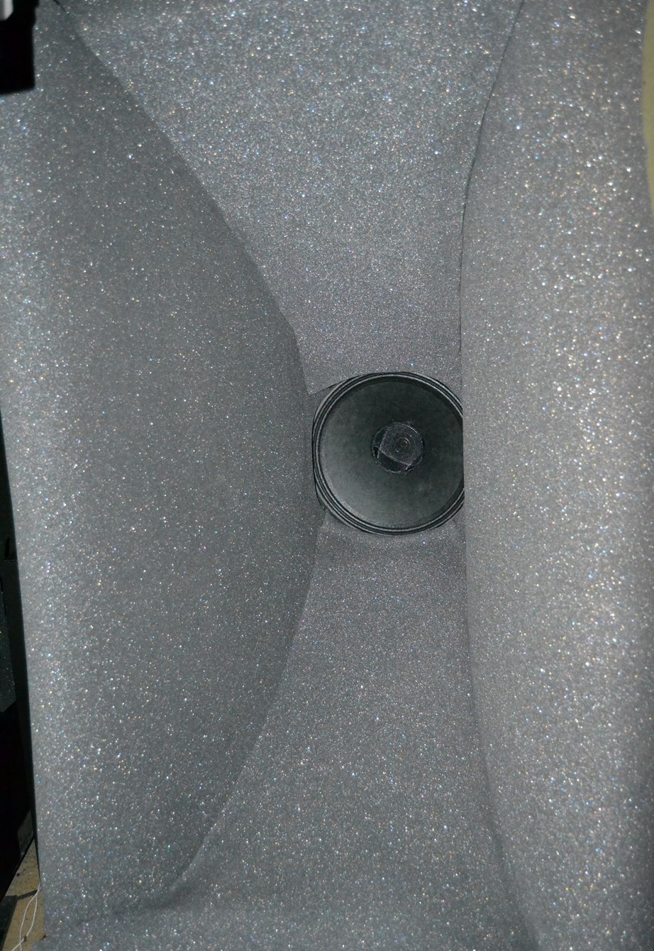

Curious about the horn (if any) in front of the 12" Tannoy and what handles the range above the top of the internal HF horn of the Tannoy.
Coming together, deep bass cabinets are tuned but not integrated with the main speakers or subs yet. From 100 cycles up it's probably the best I have had. The highs are very nice detailed and coherent. No super tweeter needed. With the finished crossover it's more extended than virtually all 1" compression drivers I have. The TAD 2001 may be a bit brighter but I never got it to sound this good. Maybe this weekend. 🙂
