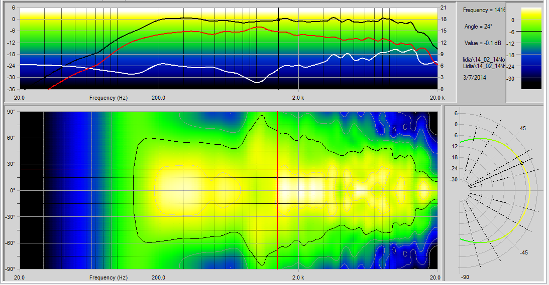

I have built a number of coax systems. They can work well, but not that well. The waveguides are always too small and this causes unrecoverable problems at the crossover. But I will say for simplicity they are impossible to beat. I can post data if anyone cares.
Just put a B&C coax in a flat baffle board (open baffle), use a MiniDSP and you have a pretty good dipole system (that still needs subs.) I cannot think of anything simpler.
Oh yeah, post the data for the Tannoy dual concentrics so we can see exactly how they sound in our rooms, loaded in our horns, with our crossovers, with our amps, with our music and mood! Thanks 😛
Attached - there is also a coax shown in my PolarMap app on my website.
