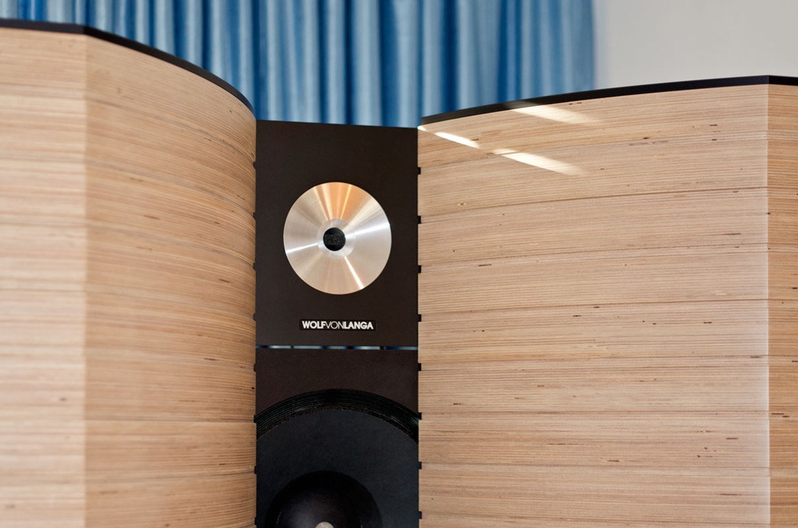

I defer to the real experts here, but I can't help wondering what happens when a coaxial driver is combined with a front horn. The cone portion is correctly loaded, but what of the HF compression driver and the small HF horn?
Although not a coaxial, here's the problem I'm thinking of. Surely this creates multiple reflections?

Lynn with a horn loaded co-axial you would be correct that you would create some strange diffraction patterns. And loading the driver that way also has its own issues with the straight edge over the cone driver. If the cone was used as the horn as Radian does then you could do something that conceivably would work but I don't see that done much. There is always some discontinuity where the cone meets the horn and the difference in angle between the cone and horn that will cause some type of diffraction.

It's a trade off for the many problems of multi way arrays and other designs that can be somewhat lessened or eliminated to where it is inaudible. In an ideal front loaded coaxial driver horn the hf horn can have a pattern where when it crossed it is a little tighter than the midbass horn. Or you could have the hf horn extend out to the mouth of the midbass horn. What I find is except-able in my contraption is acoustic foam on the midbass horn walls and mouth - It works great (without the foam you get reflections) and where the transition between the DC drivers lies (1.5K) the pattern in the horizontal plane are nearly identical between mid and treble drivers when measured in the front horn. As far as the transition from the drivers cone and the throat of the horn that can all be taken care of if designed carefully. One of the most "coherent" systems I have ever heard (close to full range electrostat coherant sound but better in all other respects) was a Danely system where separate cones and drivers are used in the same horn and carefully blended together. What I am listening to now might be better but have no way of comparing except with an old pair of Unity horns I have from Blossom Music center. They aren't too bad but the coax is better. The newer Danleys I suppose are excellent though.
