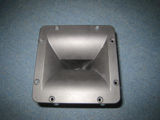

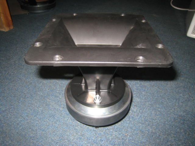

thank you for the answer.
it's a 1" polyimide driver on martin audio horn. not my measurements, so can not provide impedance. (it's not my driver, just consider buying.)
is the frequency response bad because of the driver or the horn?

hi,
can this be fixed? can I use this compression driver with passive crossover? what crossover topology shall I use?
Just a guess, but it looks like the horn is mismatched or too small. It could be digitally equalized, but I'd suspect directivity would be all over the place in the peak/dip region.

lots of thank for the answer, Lynn. I would like to use passive xo, if it's possible.
i'm trying to build a sort of econowave speaker. i have limited experience with speakers in general. my friend is a music lover, and have a Scan-Speak Event TL (18W/8535, D2905/9300), and after that he bought a pair of Final Sound 150i electrostatic panels. (he uses them with 8" Scan-Speak subs.) he (and I) prefers the sound of the panels compared to the TL.
but after that, I listened to 4Pi speakers with 2226h/de250 drivers, and I really liked it. (it took me a day to travel to listen them.) I really loved the effortless sound, dynamics and sound of conga, timpani. i can not go back to ordinary low-efficiency speakers anymore.
