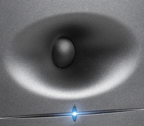

Are JBL the only ones using an elliptical entrance to the waveguide?
That's an elliptical mouth; the throat is round, I think you'll find.
