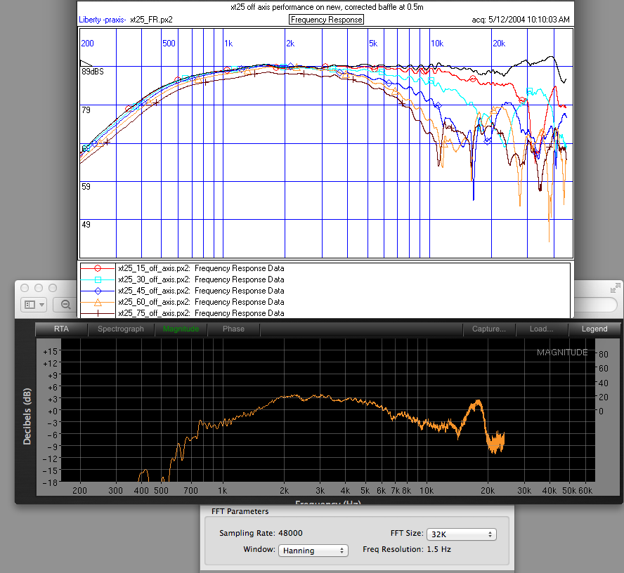

The Vifa XT25 appears to be smoother than most horn/compression drivers, an example of the XT25 and a BMS 4550 on a conical horn (frequency resolution of 1.5 Hz like you wanted) below.
Of course, as you mention, the XT25 in a waveguide does not have smooth response.
Even if the waveguide provides the XT25 10 dB of midband gain, it still is an order of magnitude lower than most compression driver/horns, it will take the full power of 50 watts to achieve the SPL that 5 watts would do with the compression driver.
The directivity of the XT25 narrows to about 90 degrees at 10 kHz, so a 90 degree waveguide will have no increase in sensitivity that high, comparing the BMS 4550 on the conical horn to the XT25 at 10kHz we would see (hear) more like a 15 dB drop in sensitivity (20 dB on the horn used in the comparison which is 115 dB one watt one meter midband).
Once you have messed with the smooth on axis response of the XT25 by putting it in a waveguide, it looses that metric of being "superior", and from a dynamic standpoint, it can't come close to a good compression driver.
Art

The shown response on the waveguide tracks the flat-baffle power response and looks quite smooth to me, with the exception of the one big peak. If you mean that the "lump" response isn't smooth, that's a problem with compression drivers too, they all exhibit that behavior on constant directivity horn/waveguides (but you already knew that). Is it just the HF peak that's bothering you? Certainly one would want to notch that.
For home levels, the need for the higher output and power handling of a compression driver are less key, I'm using a soft dome on a constant directivity horn and getting great results once the power response is accounted for, for my rear-firing section of my speakers.
Unlike many contributors in this post, peaks don't bother me, I just equalize them out 😉.
The upper graph in #8761 is a stock Vifa XT25 on a flat baffle measured at .5 meter that I found when Googling that driver.
The lower graph is a BMS 4550 compression driver on a Welter Systems Maltese horn on a 1 square meter flat baffle about 5 feet off the ground pointed skyward outside at two meters.
As far as I know, ra7 has not posted any graphs of his XT25 on a waveguide, but he wrote it "gets a huge boost, about 10db in the 1-4 kHz range".
Neither graph shows his observation, they were just presented to show relative smoothness between a compression driver/horn and the tweeter he uses, without a waveguide.
Art

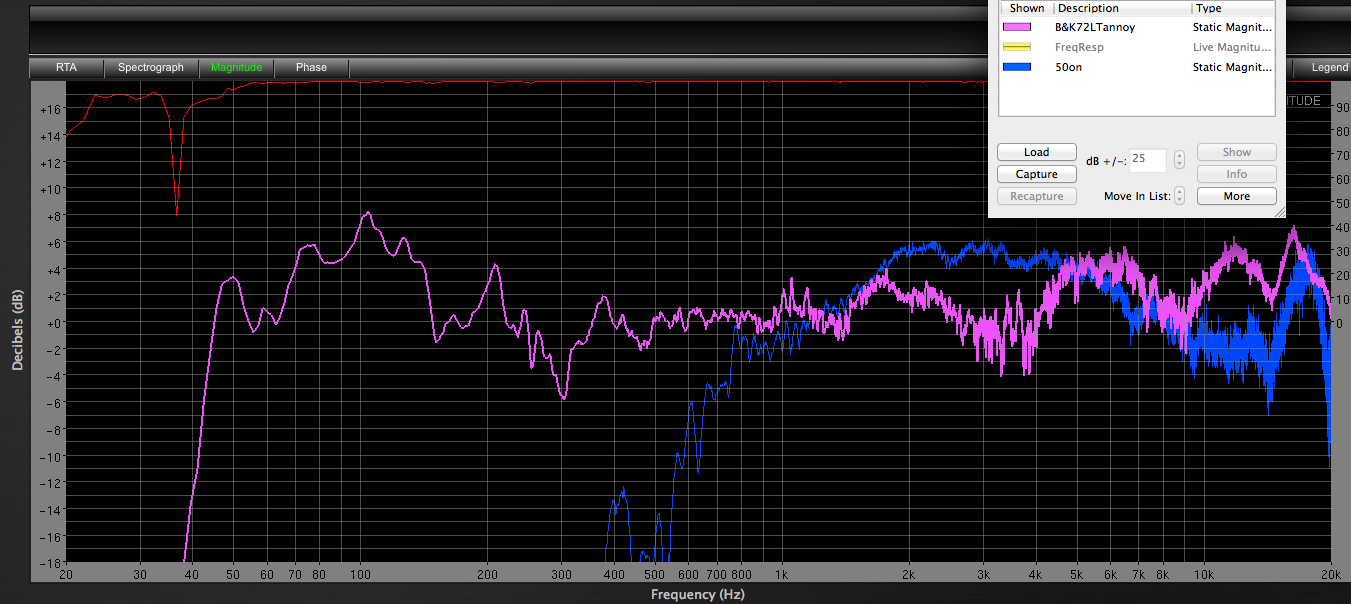

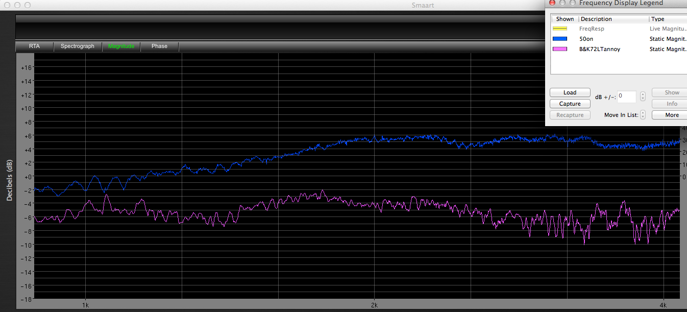

"Small", another relative term when it comes to resonances. I don't hear the .5 to 3 dB resonances in a "smooth" horn driver, but when they are large enough, like 6-12 dB, then I may detect the difference in an A/B test.
The Vifa XT25 may be smoother than the Vifa dome tweeter in the Tannoy PBM 6.5 I use in my control room.
The same BMS 4550 from post 8761 and the PBM 6.5 are both shown below with no smoothing, 1.5 Hz resolution.
The horn/driver is "smoother" in the critical 1-6 kHz range, the dome tweeter smoother (but less flat) above 6 kHz.
At any rate, some of the drivers I tested were less smooth, all equalized relatively flat, you can listen to them and report back if you are in agreement with Toole.
My ears are not golden enough to tell them apart until driven in to distortion.
http://www.diyaudio.com/forums/multi-way/212240-high-frequency-compression-driver-evaluation.html
Recordings of six drivers using different diaphragm materials and size, phase plug designs, and magnet structures, all on the same horn are there.
Art

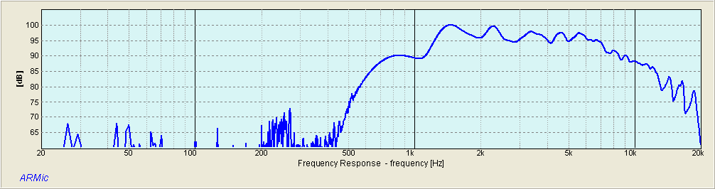

hi,
can this be fixed? can I use this compression driver with passive crossover? what crossover topology shall I use?
Pretty rough response on the low end but you might be able to improve it with impedance compensation- without knowing the devices, test conditions, or impedance plot, you're asking the impossible.
Impedance compensated damped 2nd order is what I usually use for similar devices, though.
