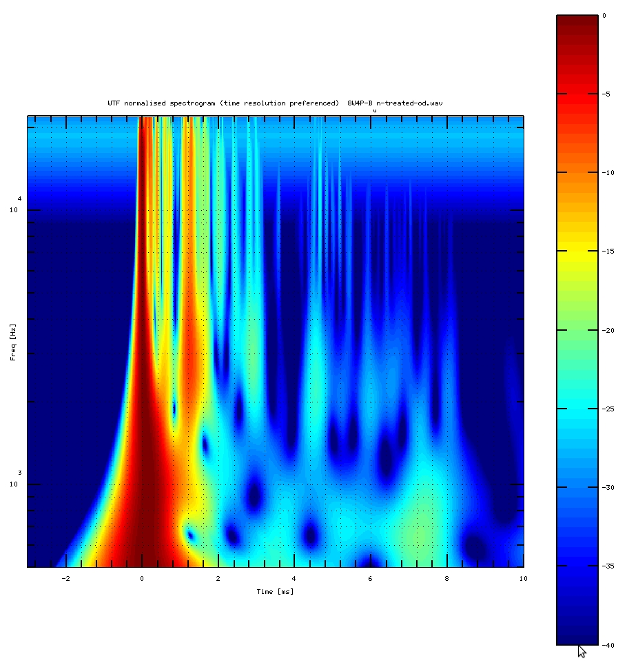

Made me think of migeO's work with wavelet analysis. What he provided gives a very clear picture of why even individual drivers can be confused sounding. The repeated patterns within the first 4ms are clearly shown. I suspect wavelet analysis could find and help in the elimination most horn difficulties too.
Bud

The idea is that since we are interested in a wide bandwidth, time is not the best ruler to measure with. It is why Group delay is not that useful, at 20Hz everything takes 1000 times longer than it does at 20,000Hz so “time” doesn’t show departures very well.
Wavelets and some other approaches say ok, let’s plot the departures based on how large they are compared to the wavelength or period of one cycle.
Viewed that way, a given thing (lets say a perfect 4th order decade wide band pass) has the same appearance at any frequency (like the impulse responses would be identical but different lengths in time proportional to the frequency). The same issue is present in the cumulative spectrum display; the proportional version is Cumulative Burst decay or STF which treats wavelengths or wave period as equal.
