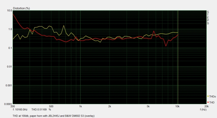

Question for ra7-
What microphone was used for the distortion measurements between horn systems and cone & dome systems?

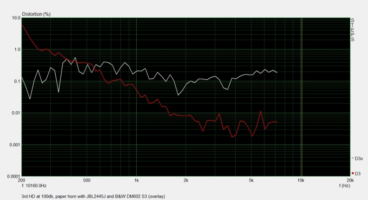

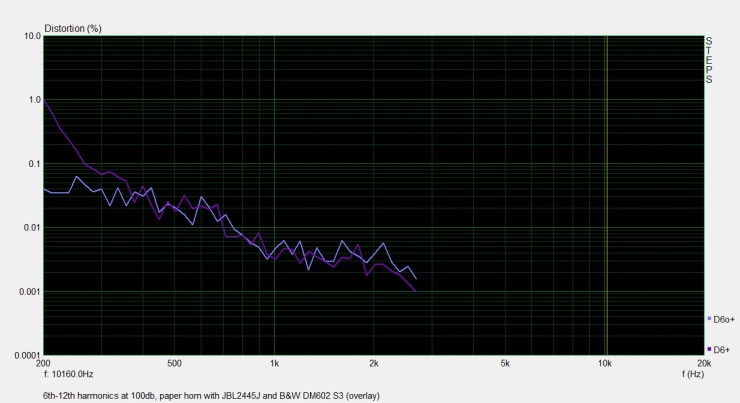

I was using the Dayton Audio EMM-6 with the calibration file. It may loose its linearity at higher SPLs, but 100 db is easy.
Anyway, attached are the measurements that compare the B&W to the 2445/tractrix combo. All measurements are outdoors at 2m and 100 db. They show the comparison for THD, 3rd and higher orders combined (6th to 12th). There is some difference in the 3rd harmonic distortion, but the clincher for me is the higher order comparison. Little to no difference at all.
