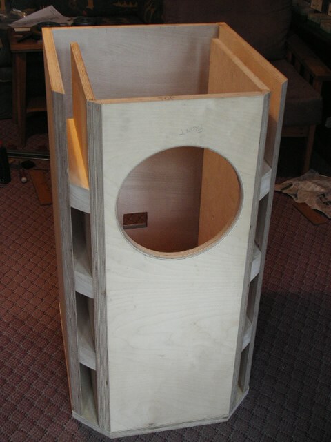

Just thought Gary and Lynn might like the attached pic of my first Jensen bass unit for the combination . I know it took me a barely finite amount of time to do this, but I'm quite proud of the woodwork !
I got some autoformers for the 288-H's from Dave a while back, and it was nice to find the horns sounded the same with or without the autoformers .
Good effort Dave!
Mark
Wow! Now that's classy! Very impressed with the quality and beauty of the cabinetry. Gary and Mark are doing impressive work. Still meditating on the resistive-vent alignment suggested by Planet10 for an Altec 416/TD15M type of driver - a scaled-up version of the Fonken. Out of curiosity, Mark, what are the cabinet dimensions?

You asked a few days ago about the Onken/Jensen cabinets I'm making .
The design is basically the standard design as given on the Supravox site :
http://www.supravox.fr/kits/jensen.pdf
I looked for a while at alternative alignments but could see the inevitable trade-offs of low-end extension . I'm not intending to add any further bass complexity due to space considerations . I'm hoping it will be an OK trade-off with the nice Supravox 285GMF which have very light cones .
The current philosophy will be to drive these bass speakers from a Pass F4 driven from a valve linestage or a pick-off from the driver of the SE amp that will be driving the Horns and G3 ribbons . I'm hoping the Class-A and feedbackless nature of the F4 will help integration between bass and mid sections . I should at least get the same sort of spatiality from the F4 as a valve SE amp .
Mark
