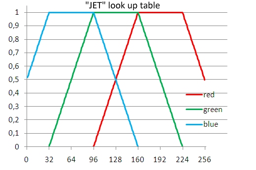

Hello Panomaniac,
There is some convention for the choice of the colors in such wavelets graph or spectrograms, constant spectral decay graph...
The most used "look up table" (assignment of the red, green and blue component for a given pixel value) is called "Jet" (e.g. Matlab).
See attached graph for a 256 values look up table.

Thanks Jean-Michel. I understand the principal of the JET color scale, but I don't like it!
Maybe it's just me, but it does not present a clear idea of levels at a glance. And shouldn't charts be clear and easy to read?

The choice of such color maps or color LUTs as JET is mainly due to the fact that in a scale of grey the mean human cannot see more than something like 8 levels of luminosity.
But when it comes to colour the mean human can see more than 64 different colors.
So the mean human will visually retrieve much more information in a wavelet graph using a Jet LUT than witha grey scale.

Hey Jean-Michel. Thanks for the color map. Some of those would work better for me, no doubt!

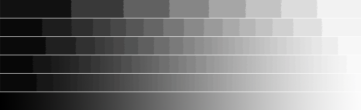

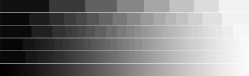

Perhaps you mean 8 bits? That's 256 levels. We can certainly see more than 8 shades of luminosity. About 200 levles is generally regarded as minimum needed for a smooth scale. Below is a little chart I made, it has strips with different values of black to white. From top to bottom there are 8, 16, 32, 64, 128 and 256 levels. Depending on you video card and monitor, all but the bottom strip should show steps.

The visual test to see how much should be the difference between 2 grey shades to be perceived should not be done on such bar scales but on more complex pictures.
Here is a test:
http://ophtasurf.free.fr/illusions/illusion_adelson2.jpg
If you say the luminosity of cell A is different than cell B you are plain wrong. A and B have the exactly same intensity...
In that following example, the intensity is constant all along the horizontal bar:
http://upload.wikimedia.org/wikiped...n.svg/800px-Gradient-optical-illusion.svg.png
As you can see, our vision is very weak concerning its ability to perceive a diference between 2 grey shades.

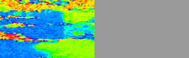

In an extreme case: look at the attached gif picture. On left the picture in RGB color table, on right the same picture shown in grey scale...

These are old tricks, and they are just that - tricks. To say that the eye can not distinguish more than 8 shades of gray is just wrong. It can, very many more. Can it be tricked into thinking that 2 similar shades of gray are different? Or the same.? Sure! Your examples show this very well. But it's not relevant to the graphs at hand.
You'll get no argument from me that color carries much more information. My point, which I must not have made well, is that the color scheme in Elias's graph is visually misleading. As yellow appears brighter to the eye then any of the other colors, the yellow areas appear to have a "higher" value. They do not. In fact it's the dark red color that represents the highest values. Unfortunately for the sake of visual clarity they don't look "higher".
That's why I suggested that another color scheme might better represent the levels to the eye. Or grayscale, which would not suffer the misinterpretation of levels. Yes, the eye can be tricked in grayscale, but so can it be in color. That's the point. The eye of course has limits in distinguishing levels of gray. But it's far, far finer than 8 levels.
