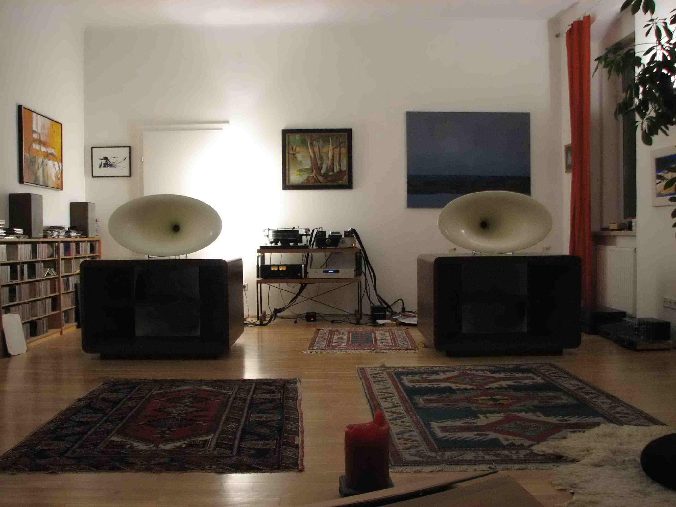

I found this interesting: Haigner Alpha.
haigner.com
http://home.tele2.at/haigner/download/haigner_alpha_horn.pdf
I think we've seen similar mid-treble horns before, but the mid-bass horn is a bit different.
While it is rather large, it's also quite aesthetically pleasing IMO. 🙂

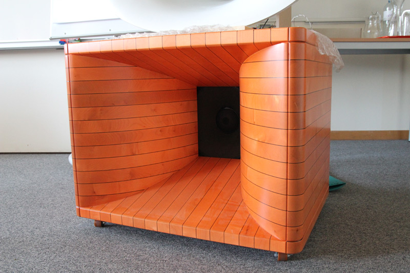

Here is another mid-bass horn from Haigner (gamma) (..3 pic.s, the last pic on the page is one of them with their soon-to-be owner):
The Audio Eagle - The Vienna Vibes Audio Fest
