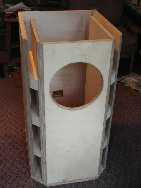

Just thought Gary and Lynn might like the attached pic of my first Jensen bass unit for the combination . I know it took me a barely finite amount of time to do this, but I'm quite proud of the woodwork !
I got some autoformers for the 288-H's from Dave a while back, and it was nice to find the horns sounded the same with or without the autoformers . Good effort Dave !
I'm off on hols to Austria now before tackling the final work on speaker no.2 ....
