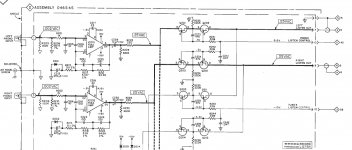

The C35 preamp circuit looks similar to the Herald R-88a op amp circuit which I think sounds fine on my piano source component test. I have a Steinway console between the speakers for reference to CD source reproduction.
That's pretty hard-core. I believe Frank McIntosh used to also test his gear by directly comparing live instruments to recordings played through his amps.
What, I have to figure it out myself??
Seriously though, I see there is LT Spice for Mac, so I could give it a try. Its rather amazing that SPICE is still the go to simulation software. Hasn't it been around since the 70's?! Nice to see that LT is keeping it available.
Sorry, yes I did truncate the schematic. I cut both right before the opamp out feeds into a pair of transistors/jfets. The Mac schematics are HUGE! Included is a more complete story.
Thank you very much! I will definitely check the opamp handbook before trying my hand at anything.

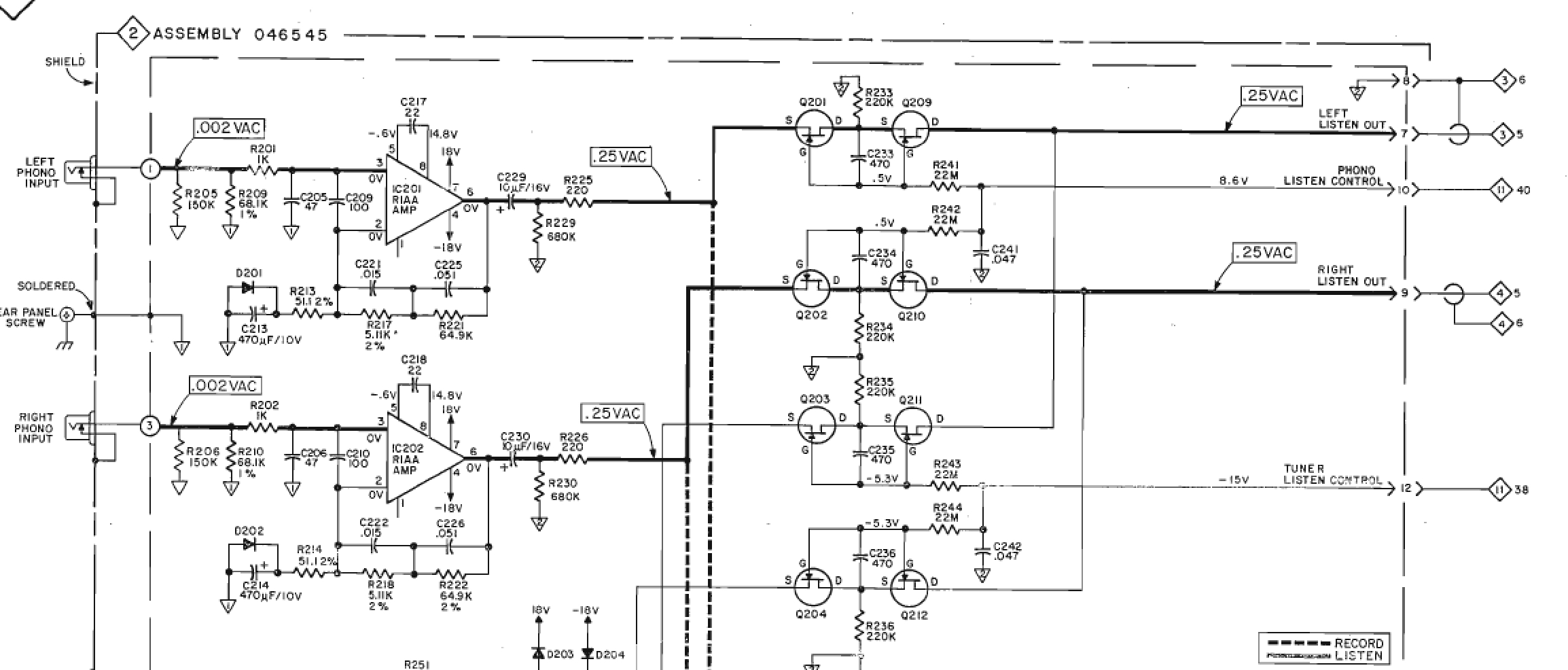

use LT SPICE or something similar to know for sure...
...did you cut those schematics a little prematurely? it's been a LONG time since i looked at those, but I "thought" they had a passive LPF after the opamp somewhere...
... at any rate, you can go to the analog devices website and download the opamp handbook (i think it is chapter 6).

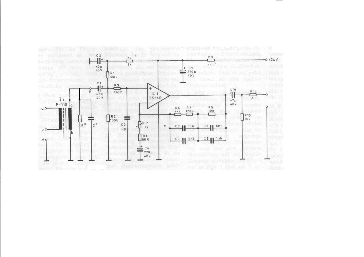

a ne5534 driving 51.1 ohms at high frequency? Doug Self used 220 ohms in the 2012 pre-amp.
if you want to drive that 51.1 ohms load it should be buffered it like they do in the LT1115 design with the LT1010 buffer example.
try to simulate these circuits first to verify if they are worthy. anyone sim that LT1115/LT1010 circuit yet? not even 15 minutes worth of effort.
I doubt the Bews implementation drives 51.1 ohm, or maybe that is how they arrive at fuzzy distortion. iirc my ne5533 design used the example out of the signetics datasheet or there app manual. I used big yellow philips polystyrene caps.

rsavas makes good points, one reason why i said "not state of the art".
you can ease this problem to some degree by adding a series resistor and adjusting the passive LPF at the back end.
another thing to watch out for in these designs is the opamp running out of open loop gain so your riaa accuracy drops at the high end (along with increased distortion). again, some of this can be compensated for to some degree, but you're starting to leave the realm of "simple".
maybe peruse this link from andy_c: Andy's Active RIAA Phono Equalization Design Page
for opamp preamp designs, you can never (ok, ok, never say "never" 🙂 ) go wrong by adding a buffer.

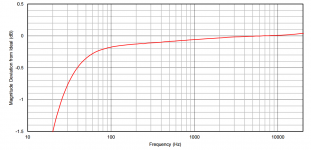

Speaking of buffers, anyone check out the P8 volume control buffer that Apex (Mile) posted in his threads some time ago? I keep track of these things you know 🙂
i sim'd it up and it is measuring absolutely no thd. not a blip in the fft plot. Anyone care to try it for yourself & explain why it is so good? It measures less than the simulator measures its own source, how can that be?
See attached. You will need to sort out the models, but I am using Bob Cordell's models for most of them. I'll gather up the models and post them too, just need to re-name them and put in the install dir lib cmp folder.
The pitchfork buffer is a great example to use for the low Z MM phono eq, looks to be almost the same as P8
I guess you can call this my spice pre-amp sand box. the plr mc pre is also a nice ckt as well. anyone have a favourite to add to my collection?

rsavas:
i'll admit upfront i didn't look at the models.
are the pnp and npn device models "kinda realistic" complements or "exact" mathematical complements?
exact mathematical complements will often show unrealistically low distortions in simulations.
mlloyd1
mlloyd1
I have no idea, need to ask Bob Cordell i guess 🙂 I am far from a spice model expert!are the pnp and npn device models "kinda realistic" complements or "exact" mathematical complements?
Hi rsavas: I assume you're referring to R213 in the C34V Mac schematic? Is the NE5532 much different than the NE5534? I ask because the Phillips application data sheet for the NE5532/3/4 series shows the NE5532 with 49.9 ohms with lower capacitance to ground.
5532 is internally compensated, 5534 requires and external compensation network. 5534 can have the off set voltage nulled out, which is important for dc instruments but not for audio.

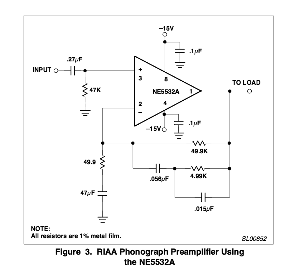

No sweat... The NE5532 is able to deliver 38mA of current, according to it's datasheet. With a 50 Ohms load, that means it's able to put out a 1.9Vpeak (about 1,3Vrms).Hi rsavas: I assume you're referring to R213 in the C34V Mac schematic? Is the NE5532 much different than the NE5534? I ask because the Phillips application data sheet for the NE5532/3/4 series shows the NE5532 with 49.9 ohms with lower capacitance to ground.
I don't think most RIAA applications will need that level of output.
yup that is the ckt, same as I have in the application manual too. now that I think about it some more i think this the way I made it back in college. It worked fine, as far as i could tell. is it right, at that time I did not question it as I trusted their better judgement on how to apply their device vs a green tech. to me now it does not look like it is the best way to do it, but I could be wrong. Using Doug Self's example, he did not do it as Signetics had done.
they say in the app note that they used a ne5532 because it has many advantages,
it is lower cost and the not so obvious advantage is related to the thermal tracking and consistency of parameters of both amplifiers integrated on the same monolithic chip. to bad no more ne5533a as it was the best solution then lower noise than a 5532 and it was a dual 5534.
since 5532 is internally compensated for unity gain, at least 34dB of feedback exists for a 10MHz gbp. lab measurements showed less than 0.01%thd into 600 ohm, less than 0.005% into 10K, separation better than 70dB at 100,1k,10K. unweighted noise greater than 70dB, A weighted better than 80dB.
Using this reasoning,
these days I would choose a polymer ecap for the 47uF feedback cap. if you use a 5534 you could eliminate the feedback ecap and use the offset null pot, but that adds cost and you have to do the adjustments.
that app manual is available on line
https://ia801904.us.archive.org/19/...415016/1979_Signetics_Analog_Applications.pdf
see page 209

the ckt is fine and my concerns are alleviated.No sweat... The NE5532 is able to deliver 38mA of current, according to it's datasheet. With a 50 Ohms load, that means it's able to put out a 1.9Vpeak (about 1,3Vrms).

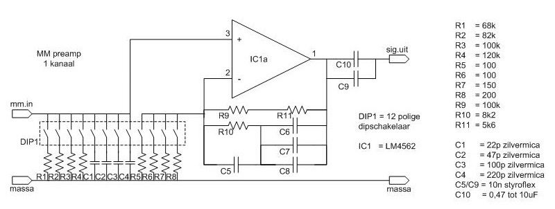

Or use two 5532's and implement a DC-servo...if you use a 5534 you could eliminate the feedback ecap and use the offset null pot ..

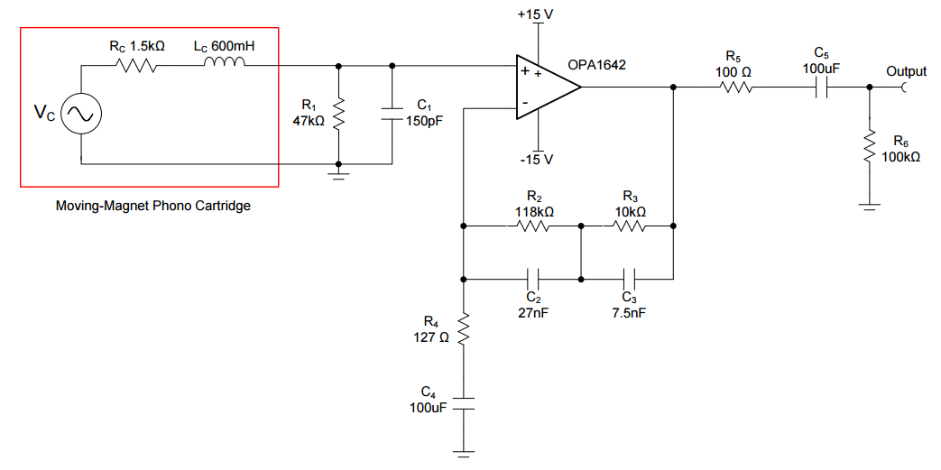

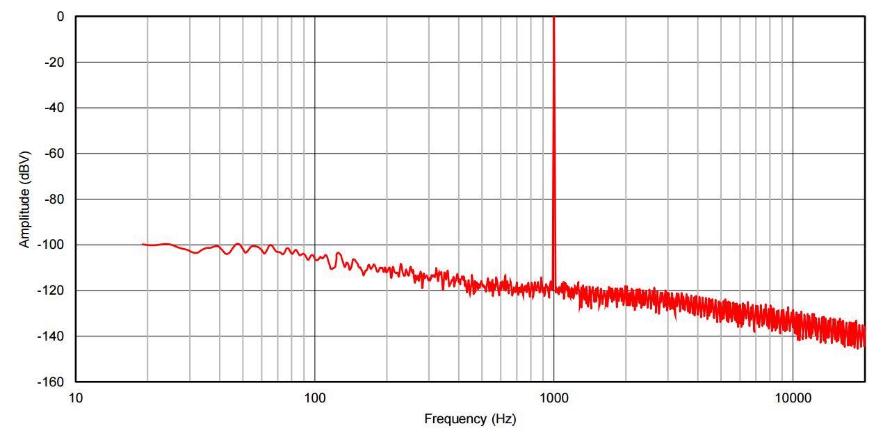

Thought I'd through a more modern Burr-Brown option into the ring. The OPA1642 makes an excellent single stage MM phono pre-amp. For MM cartridges there are two major noise considerations that most people ignore and simply look at broadband noise spectral density. First, input current noise of the op amp is really important because MM cartridges are highly inductive. For example, the Shure M97xe has an inductance of 650mH. At high frequencies, the input current noise multiplied by the cartridge impedance may be much larger than the input voltage noise. Second, low frequency noise (both voltage and current) is critical because the RIAA gain curve is highest at low frequencies. For these reasons, the best choices for MM phono preamps are op amps with front ends that use, JFETs, super-beta BJTs, or BJTs without input bias current cancellation. The OPA1642 is a JFET part (consider it an updated OPA2134).
opa1641 is an excellent choice, I would certainly use it over a ne5532a in this app unless you have a ton of them to use up. wonder if one could actually hear a difference? i guess i will have to make one up and find out for myself, stick my head beside the speaker.
i suspect that Doug Self only used ne5534a in elektor pre-amp 2012 MM design because it is avail in dip-8. he did say to me, putting a j310 in front of a ne5534a will improve the noise by a few dB. I thought that there are better choices than a j310, so more improvement could be made if using a lower noise device like a bf862. wonder if it would make any noticeable difference, well until you drop the needle and groove noise pre-dominates.
