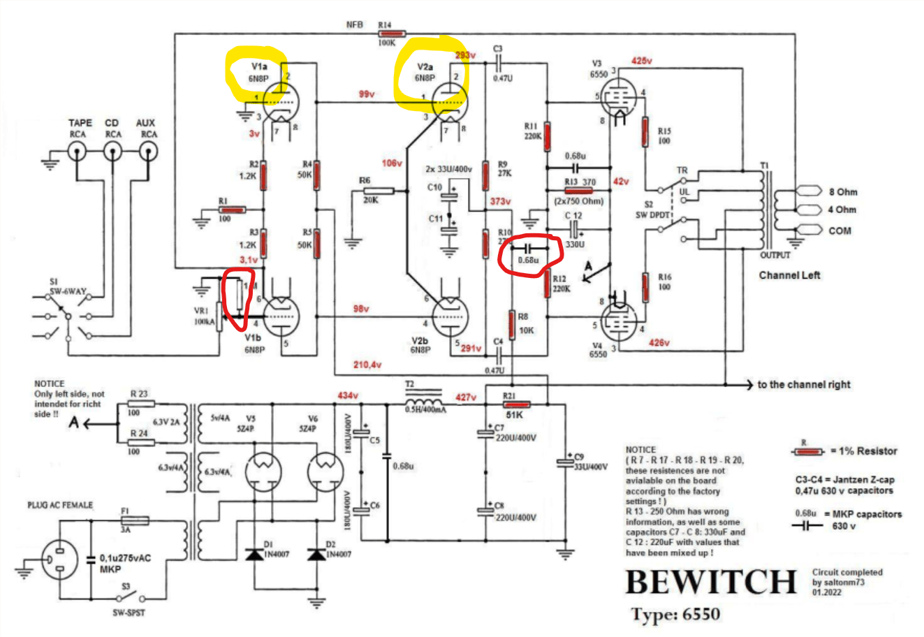

Heading back to the main topic of this thread: the awesome BEWITCH 6550 tube amp from China...
I have spent the last few years trying to improve this amp - with good success.
I saw the interesting posts by saltonm73 and posted some questions about his mods a few posts ago. But it seems saltonm73 has quit this forum - no reply to my questions and no finding him in membership.
So, I would like to ask other learned members here...
(I have included the schematic provided by saltonm73 and circled the areas of interest...)
Why add a .68uF capacitor between C3/4 and C5? What does it do and how does it impact the sound of the amp?
Why add a 1Meg resistor across the volume potentiometer? Is this simply an attempt to gain more usable adjustment of the pot?
Why run the 6SN7 in the first tube position - instead of the (original) 6SL7? I fear that this will mess with the overall amplifier Gain and NFB structure.
I look forward to all expert thoughts. Appreciated.

hf bypass for electros, its use is contested...discussed here to death, search for the posts of member Eva....Why add a .68uF capacitor between C3/4 and C5? What does it do and how does it impact the sound of the amp?
to prevent problem of possible tube saturation when the pot failed as an open circuit, a good practice imho..Why add a 1Meg resistor across the volume potentiometer? Is this simply an attempt to gain more usable adjustment of the pot?
the lower mu tube will result in lower open loop gain and is not good for stability, it is possible to get rid of gnfb this way, just use it in triode mode or do a OSchade feedback from plate of 6550 to plate of driver tubes, 120k 2 watt is okay try...
Many thanks @TonyTecson for your prompt answers to my questions above.

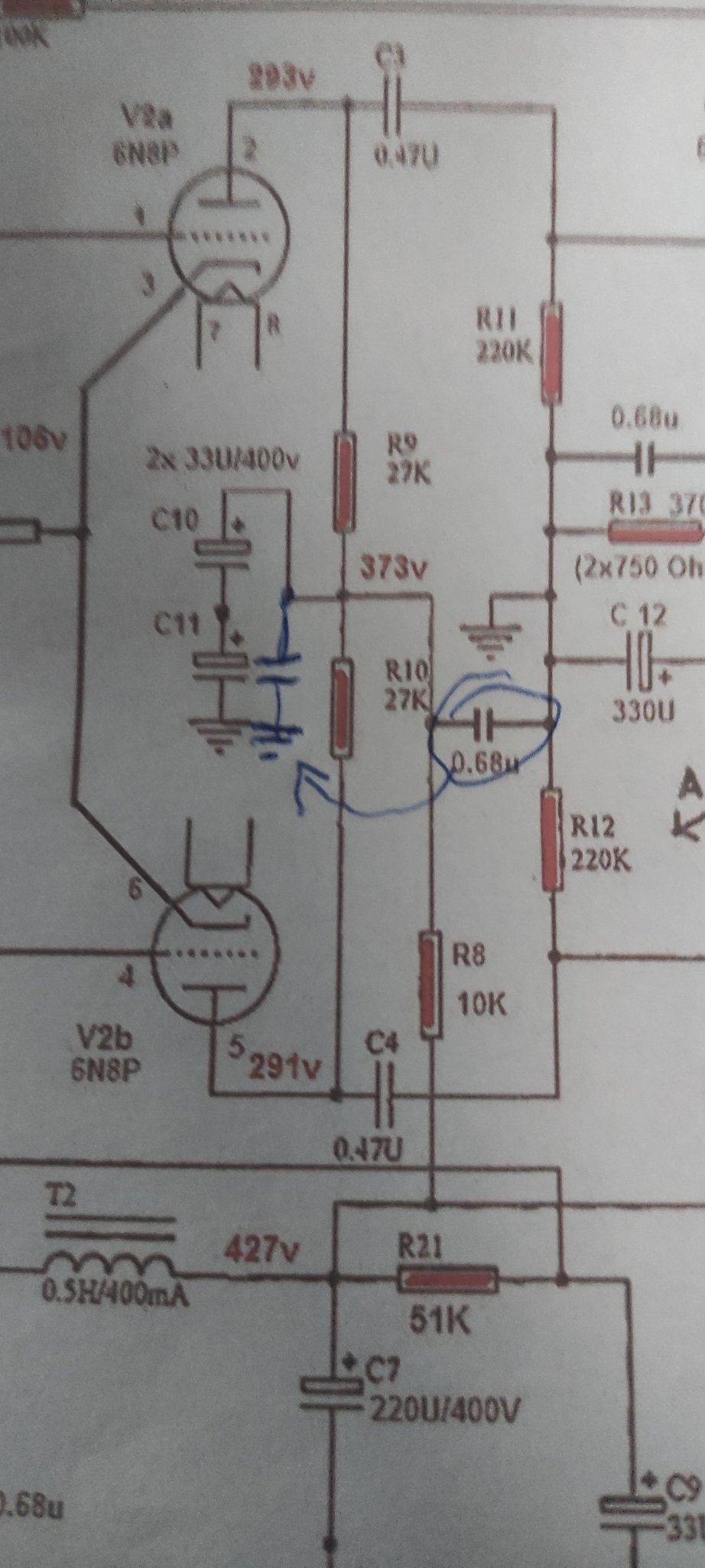

I understand the principles of capacitor bypass and have in fact bypassed my own C3, C4 and C5 on my BEWITCH 6550.
But the position that saltonm73 has installed his .68U (circled in red above) suggested to me that perhaps more was happening - than simply bypassing the C3 and C4 caps.
Regarding swapping the first position preamp tube from 6SL7 to 6SN7 - the lower gain 6SN7 generally considered to provide superior sound quality - is this something I could simply try with my triode only BEWITCH with its present stock circuit values? Or will the 6SL7 circuit need to be changed to support the incoming 6SN7?
Presently, the "OSchade feedback" you mentioned above is an unknown to me, so I'm keeping it simple...

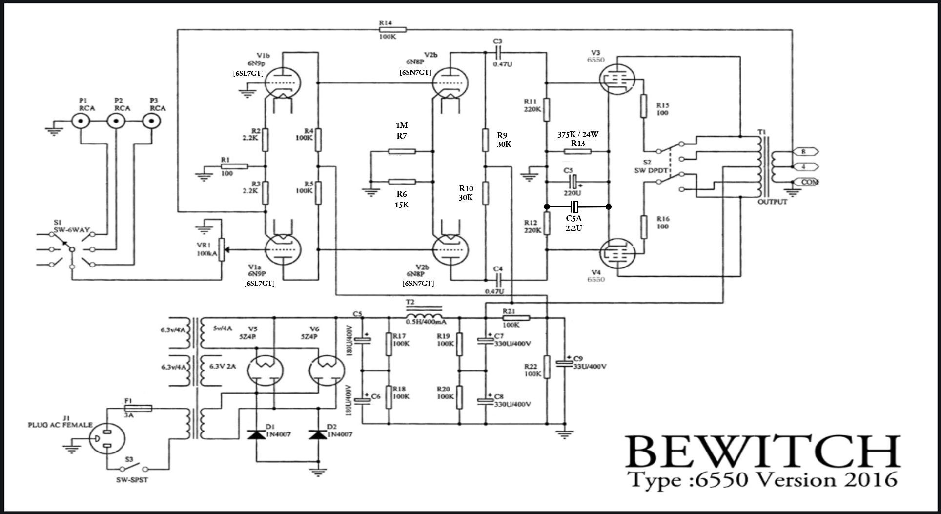

For reference, I have added a schematic below, of my current BEWITCH 6550 triode only circuit, with many values showing what the factory had installed - as opposed to the original 2016 schematic. My mods are also shown - being slightly different from saltonm73.
if that were mine, i will do two things, fix the switch to triode mode, ditch the global feedback resistor...
i am not really happy with the triode, ultralinear selector in there...

Hello SONDERKNZ
Sorry that I'm only getting in touch here now, in Germany Sunday and Monday were public holidays and we were out with the family.

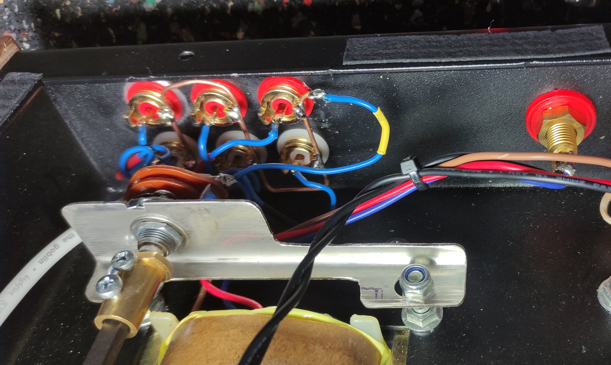

that bridges with the additional .68 uF MKP (if you look closely at the assembly on the pictures) the two capacitors C10-C11, which are also missing on the original Bewitch circuit diagram but are present on the board!

if using the 6sn7 in the first hole and 6sn7 in the next one, removing the feedback resistor will give you some surprises, you may even like it...
running the kt88 in triode lowered its "plate resistance" significantly so that you may get away with global negative feedback....i will not hesitate to try it...

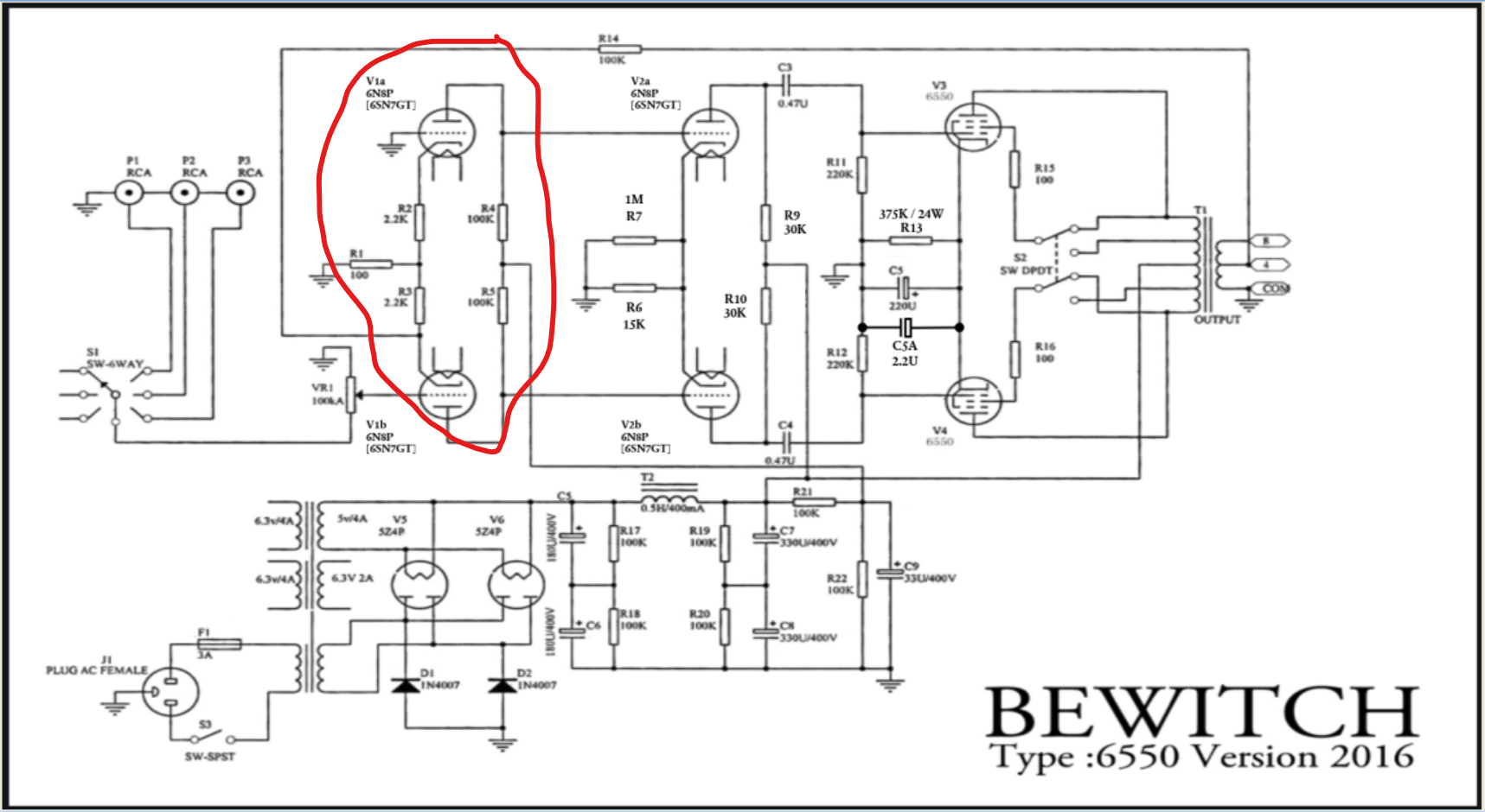

I completed a bit of testing today, with interesting results.
My "normal" configuration for this amp is 2 x 6SL7GT tubes in the first hole and 2 x 6SN7GT tubes in the second hole. The output tubes are 4 x 6550.
TEST 1: I simply "swapped" the 6SN7GT and 6SL7GT tube positions and had a good listen.
The sound was less good and sounded rather homogenised. Not terrible, just less good and less enjoyable.
What this test did show me though, was that either the 6SN7GT or the 6SL7GT could operate (somewhat) without injury in either hole 1 or hole 2. No too brightly burning tubes, no offensive distortion and no problems. Probably not optimised, but no injury.
TEST 2: I removed the 6SL7GT tubes and installed 6SN7GT tubes in all 4 preamp positions, including two new NOS tubes.
Again, there were no too-brightly burning tubes, no offensive distortion and no problems.
The sound change was quite dramatic. A greater sense of space and detail than any tube configuration I have yet conjured with the BEWITCH. The "sparkle" I have been chasing in the tops seems to have arrived.
But on the downside, dynamics are down, versus my "normal" configuration and there is a bit of unwelcome hardness in the tops. It is not as easy to enjoy the music as my normal configuration, but I feel that this 4 x 6SN7GT configuration holds great promise in terms of extracting a bit more detail from the BEWITCH.
I have left TEST 2 configuration running for the moment, understanding that the new (NOS) tubes may need a bit of time to settle down and make friends.
I suspect that the support circuitry previously optimised for the 6SL7GT tubes now needs to be revised for the 6SN7GT tubes.
I do not have the knowledge or experience to determine the correct values for the resistors in question - R1, R2, R3, R4 and R5.
Also running 4 x 6SN7GT at the front end of his BEWITCH, I see that saltonm73 has simply halved the values of R2, R3, R4 and R5.
On this basis, I will try the same approach - unless others have alternative suggestions.
I look forward to your thoughts.
I have attached below, an updated schematic of how my BEWITCH with 4 x 6SN7GT now exists. Please note that the switched have been removed and the amp ONLY runs in triode.
I often see on other circuit diagrams that the capacitors are bridged with an additional foil cap!saltonm73,
those 0.68ufd caps were placed there to cater to some fad, not really necessary
So do you think that at this point bridging the capacitors (c10-c11) with a 0.68uF cap is superfluous and would not help?
@saltonm73
Nice job there!
I particularly like the way you have brought the volume pot to the input, keeping the input trace as short as possible. Smart move, but not always easy to achieve, mechanically.
That said, I guess your "The Goblin" input feeder still needs to stretch across the connect with the PCB.
In any event, it looks like progress.
Like everything else on my BEWITCH, the (factory) input connectors are like the Rock of Gibraltar - absolutely rock solid. I'm not sure why yours were so loose and flimsy.
Question: Given that the BEWITCH has a simple passive preamp - and the fact that you have lowered the gain by opting for 6SN7 tubes all round - which reduce the original level of Gain - do you run your BEWITCH with an active preamp?

saltonm73,
A 0.68 uF capacitor across an electrolytic: Either it Improves the sound, Or it does Not Improve the sound.
The only way to know for sure is to do a very carefully controlled Double Blindfold test setup, using lots of different kinds of music recordings.
Any other test method is suspect at best.

As I mentioned (see a few pages back) I looked at several modifications from various sources on the net and considered which ones would work well for my Bewitch 6550, my changes to the circuit are based on Lampizator modifications@saltonm73
Nice job there!

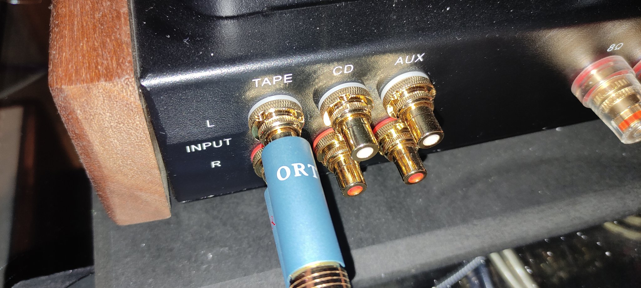

my Bewitch is either operated alone, or amplifies the incoming signal via an Adcom preamplifier.
The factory-installed RCA jacks were actually a disadvantage that did not have a reasonable contact, this problem also existed with some RCA cables of different price quality, so I exchanged them without further ado, maybe you have other RCA jacks from other manufacturers installed in your Bewitch than mine!

only if you want it to....your money, your amp your choice....I often see on other circuit diagrams that the capacitors are bridged with an additional foil cap!
