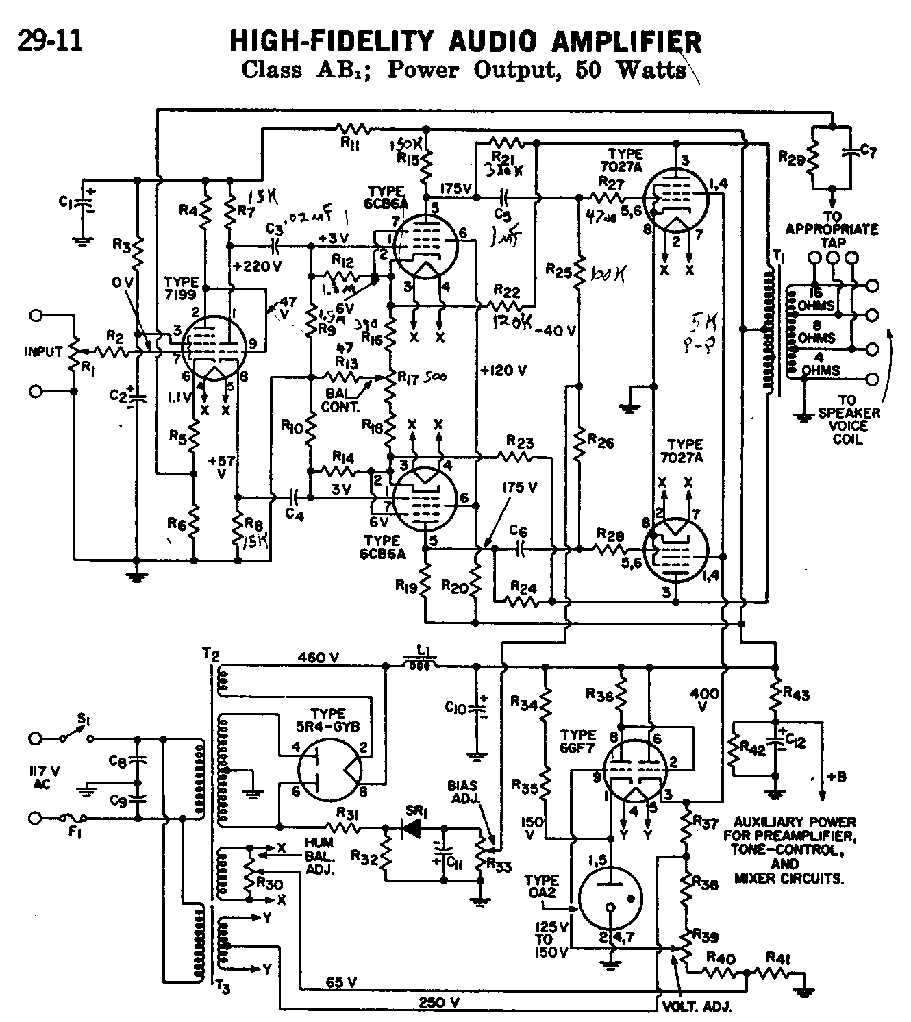

Take a look at the last page of the Heathkit W-5M user's manual.
It shows the increase of harmonic distortion at low frequencies, if the DC push and pull currents are not equal . . . Even Though there is plenty of global negative feedback around the output transformer.
It is known that global negative feedback around the output transformer does not fix low frequency saturation, it makes it Worse.
That is true for both push pull, and for single ended.

a reason to avoid GNFB...It is known that global negative feedback around the output transformer does not fix low frequency saturation, it makes it Worse.

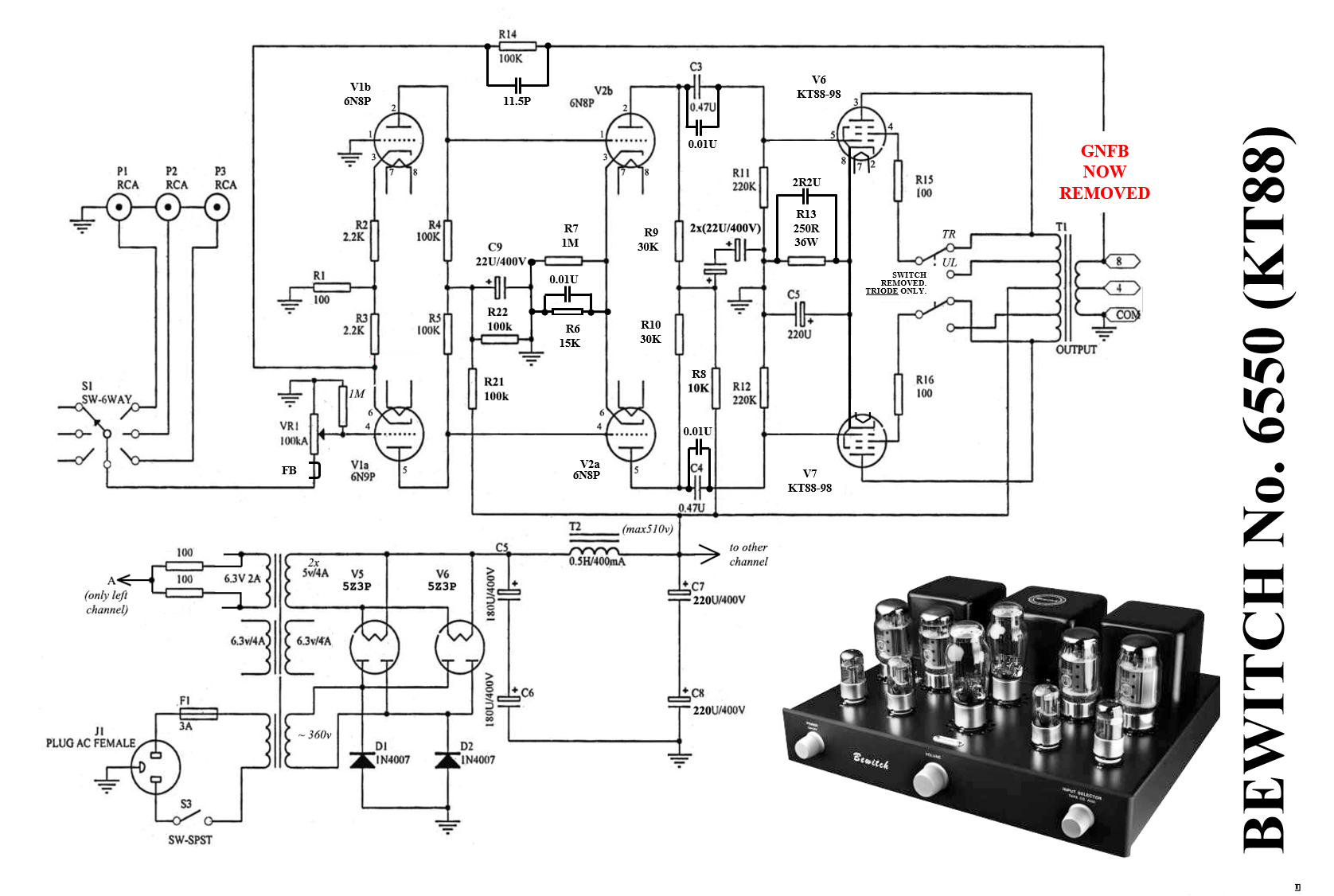

Just unpacking this a bit as some of these ideas and comments seem to be conflicting with what I am hearing.
With factory levels of GNFB - tweaked with a tiny 11.5pF bypass cap - the BEWITCH 6550 amp produces some of the deepest, tightest and most pleasing bass that I have experienced.
Changing the 6SL7 (position 1) and 6SN7 (position 2) to ALL 6SN7 PLUS lifting GNFB completely, the amp remains utterly silent to full volume and produces wonderful mids and tops. But the (still) deep and weighty bass is now plodding and spongey.
Should I blame the OPT?
Perhaps the circuit just needs to be optimized for the 6SN7 now sitting in the (formerly) 6SL7 hole?
Here's the current schematic...
(Please note that I regularly switch back and forth between NOS 6550 (Russian) to new build SHUGUANG KT88-98 output tubes as they have their own distinct sonic signatures...)
If the output transformer bass was super wonderful with the original tube types and tube placements,
and now the bass is not good anymore when you removed the global negative feedback.
In that case, I would not blame the output transformer.
You did remove the negative feedback. That raises the output impedance (lowers the damping factor).
I bet the lower damping factor changed the sound of your woofer.
no, i just want to point out that you have hit your bottleneck, and the output transformers were always the bottleneck..
you can run the next 6sn7 with a tad more plate current, but this helps the highs more....
get yourself a better output transformer....

Food for thought?
Post # 214 does not have any Schade negative feedback.
It used to have global negative feedback from the output transformer's secondary, but that was disconnected.
Now it does not have any negative feedback other than UL mode, or Triode wired mode (a switch to select the mode).
No global negative feedback, and no Schade negative feedback, lowers the damping factor (depending on the woofer and cabinet design, the woofer 'cares' a lot about damping factor).
Appreciate all the thoughts.
Plenty of food for thought…
Just a quick note that the UL/TRIODE switches were removed long ago.
This amp operates in TRIODE only!
This makes perfect sense to me.
