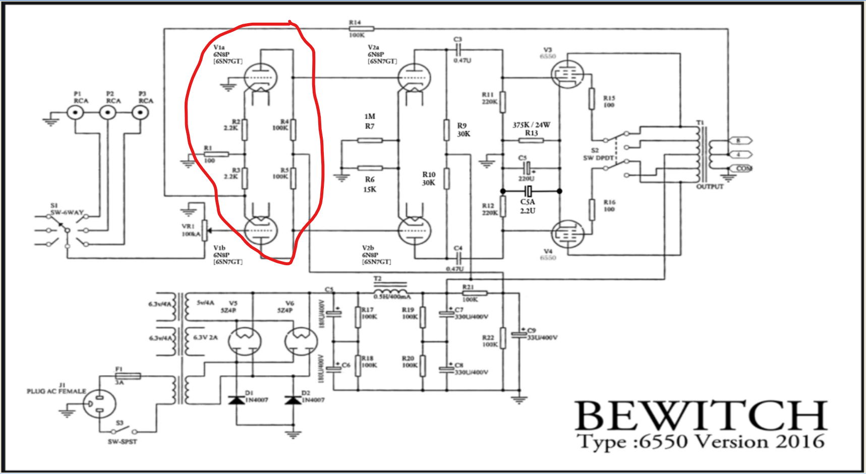

Also running 4 x 6SN7GT at the front end of his BEWITCH, I see that saltonm73 has simply halved the values of R2, R3, R4 and R5.

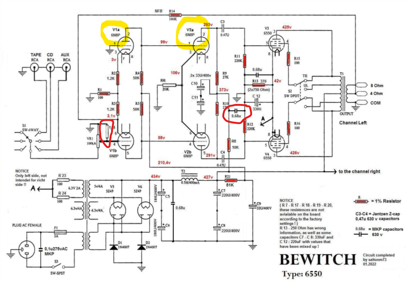

I have attached below, an updated schematic of how my BEWITCH with 4 x 6SN7GT now exists. Please note that the switched have been removed and the amp ONLY runs in triode.

(I have included the schematic provided by saltonm73 and circled the areas of interest...)
Why add a .68uF capacitor between C3/4 and C5? What does it do and how does it impact the sound of the amp?
Why add a 1Meg resistor across the volume potentiometer? Is this simply an attempt to gain more usable adjustment of the pot?
Why run the 6SN7 in the first tube position - instead of the (original) 6SL7? I fear that this will mess with the overall amplifier Gain and NFB structure.
I look forward to all expert thoughts. Appreciated.
i can not see why the cathode degeneration resistors at first hole is 1.2k, even 100 ohms is big enough imo..why degrade tube transconductance of a tube not known to have high gm to begin with...?
highs are affected when not enough drive current is available form the driver tube to swing the grid of the 6550,
so increasing the current to say 10ma from 5ma will double the current available to swing the grid with its grid cap and stray caps at high frequencies...
but then thing go messy quickly as the 6sn7 will have lost plate voltage in this way, perhaps the 10k dropping resistor is changed to 1k, and voltage drop at this point is 10 volts instead of 50 volts previously...

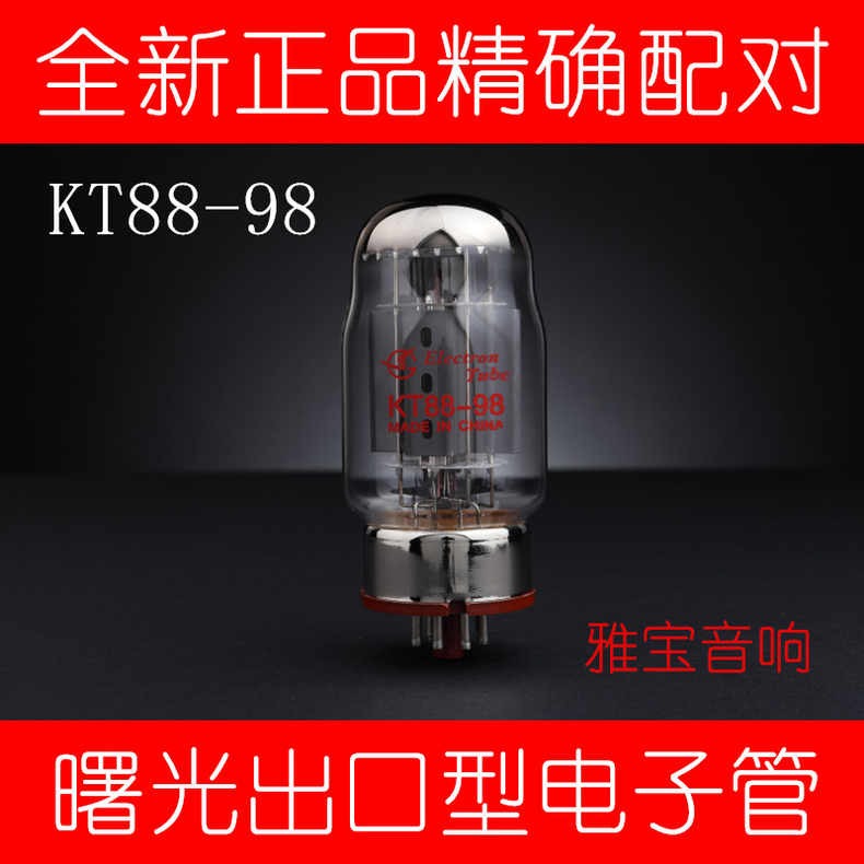

Instead, I have ordered new-make Chinese tubes - and this time, they will be the KT88 variety, which are not identical to 6550, but close enough for it not to matter. Reportedly, BEWITCH transformers have no problem dealing with the slightly higher plate demands of the KT88.
What the KT88 will sound like - compared with my present Soviet NOS 6550 - remains an unknown.
Let's see...
SHUGUANG Electro Tube KT88-98
A matched quad of KT88 - including hand-delivery to my doorstep within 72-hours - all for $US 90.00. AND including a 1-week right of return, something that I hope will not be necessary.
(China is VERY affordable, for most things...)
Evidently, Shuguang is one of the oldest tube manufacturers in the world and is said to make the lion-share of all new-make vacuum tubes, including other brands.
I shall report!

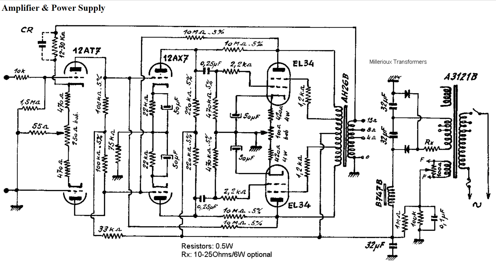

I understand that the BEWITCH 6550 circuit is based upon a 1950s design that was granted a French Patent. The designer was one PIERRE LOYEZ.
Attached is his (alleged) original schematic.
Based upon previous investigations by others, it seems there is far more going on in this circuit than meets the eye... certainly far more than I can understand.
For anyone wanting to follow the rabbit-hole, here is a previous discussion on this forum.
Understanding the complexities of the BEWITCH 6550 circuit...

replying to post #189, indeed, there are a lot of things going on in the feedback department with that circuit, OShade, then cross grid feedback and then global negative feedback, way too much complexity for my taste..
the Mullard 5-20, even the Radford 25 are not so overly complicated and yet delivered the goods as far as i am concerned...
i love the psu part of the below schematic though for its elegance and simplicity...
