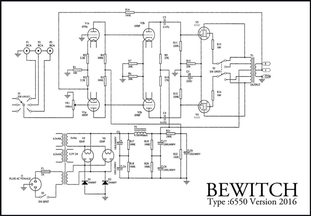

Most SOUND IMPACTING Resistor positions?
Through this learning journey, I have read a lot of discussions around whether or not different types of resistors sound different. I appreciate there are wildly disparate opinions.
My experiments below - with this BEWITCH 6550 amp and in our system - easily revealed to both my wife and I, significant difference between CARBON FILM and METAL FILM resistors in the GNFB position - R14 - given same values, wattage, etc.
On this basis, I am keep to experiment and learn more, so I wanted to ask for opinions from those with more experience.
QUESTION: Which resistor positions are seen as most impacting on sound quality?
I have provided the original schematic for reference to this circuit, bearing in mind that some of the factory-fitted resistor are materially different, from those on the schematic. This amp is so quiet and well-behaved, that for any changes, I intend to stick with the current factory-fitted resistor values - and simply try different types of resistors.
I am thinking that R15/R16, R11/R12 and R9/R10 are the critical SOUND IMPACTING positions, but very happy to be corrected here.
Recommendations invited.

My 2 cents about the modifications:
- Still the worst thing is the fixed bias using a Electrolyte Cap. The issue here is the absorption voltage given from the Electrolyte Cap. The get ride requires a negative voltage. I did this on my SLM-100 and the sound was more clear, no more echo's...
Removing Plastic covers from Capacitors - diyAudio
@HpW
Are you suggesting bypassing the Shared Cathode Resistor(s) with non EL caps instead?
It's labelled R13 and it's in parallel with C5. This is the "shared" cathode resistor.
Ohm's law says we need to double the resistance to get the same voltage drop with half the current, so make R13 250R into two 500R resistors, each with their own cap, one set for each output tube. In a stereo push pull amp, that's 4 sets.

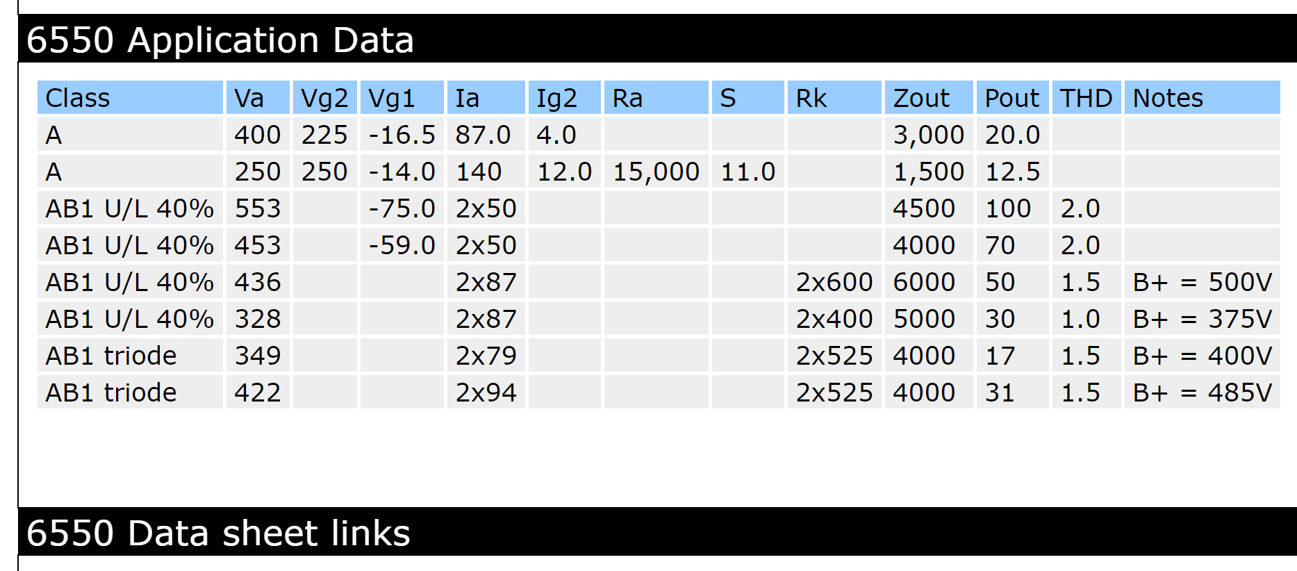

I have read through this entire thread many times and drawn some conclusions on how this Shared Cathode Resistor arrangement can be split into Individual Cathode Resistors.
Below I have shared the 6550 tube datasheet, relating to "triode" operation, which is our preferred sound on the BEWITCH amp.

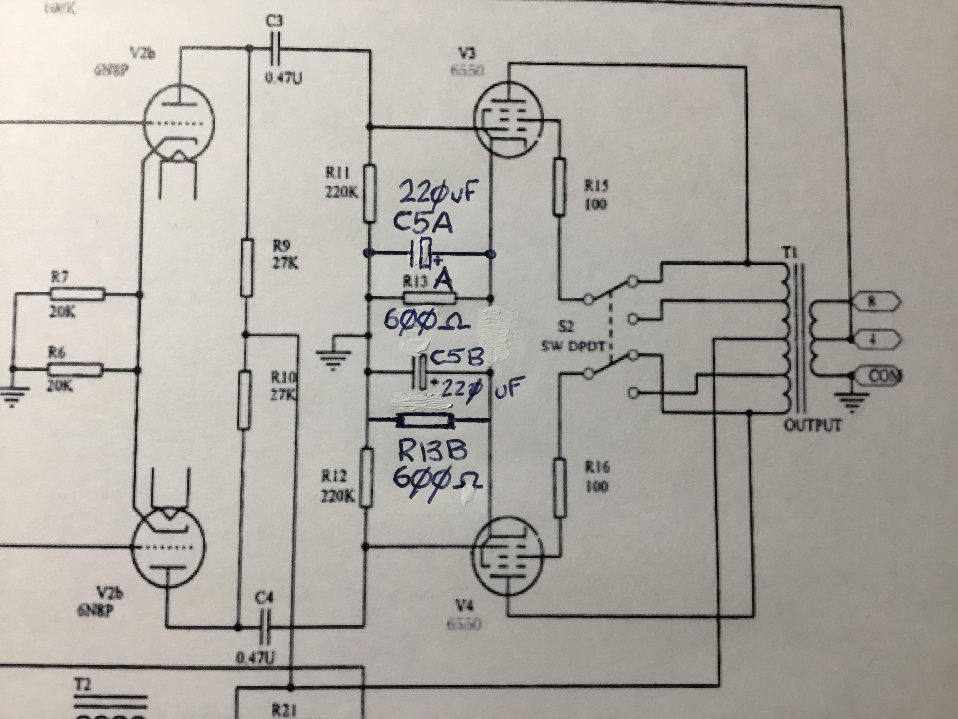

I have also attached my schematic workings on how I understand this upgrade should look like.
I'm hoping you and/or others might be kind enough to check my workings, before I progress further. Appreciated.
you can get rid of that triode ultra linear switch and fix that to triode, so one less to worry about..
measure the cathode voltage on the 600ohm bias resistors, to get 60ma cathode current, you should be able to measure 36volts more or less....if your tubes are perfectly matched, you should be able to get equal readings..
SONDEKNZ,
I like your latest schematic, that shows the use of Individual Self Bias R and bypass C networks on the output tubes.
The input stage provides relatively balanced DC voltages to the phase splitter.
(schematic in Post # 109).
But the parallel 20k resistors in the splitter cathodes is a less than ideal current sink (10k).
That means the amplitude of the 2 phases is not equal (creates 2nd Harmonic Distortion at the amplifier speaker output terminals).
The Global Negative Feedback reduces that 2nd Harmonic Distortion (but that means it has that distortion to correct).
Measure the DC voltage across the parallel 20k resistors.
Depending on that voltage, there may be quite a few Constant Current Sinks that have a very low burden voltage (minimum voltage where they still are a Constant Current Sink).
Using one of those CCS instead of the two 20k resistors, will eliminate the 2nd harmonic distortion of the phase splitter. Then the Global Negative Feedback will not have to take care of it (on less job for the feedback to do).
Well, there is another possibility, the input stage is not AC balanced. The signal only comes from one plate. And that tube has 2nd Harmonic Distortion, which is not cancelled by the other input tube.
Perhaps the amp was designed for the first stage 2nd HD to cancel the phase splitter 2nd HD.
The way to find that out is to Triode wire the output tubes, and open the Global Negative Feedback loop (disconnect R14 from the output transformer secondary).
Then measure the 2nd Harmonic Distortion. If it is very low, then probably there is some 2nd HD cancellation by the opposite action of the input tube and phase splitter tube.
If the 2nd Harmonic distortion is high with the Global Negative Feedback removed, you may want to try a low burden voltage CCS in the cathodes of the phase splitter.
Thanks TonyTecson.
Good thoughts about removing the TRIODE/UL switch to leave the amp hard-wired in (our preferred) TRIODE operation.
Another benefit is that I can get rid of the delicate switches and switch wiring that need to be removed each time I lift the PCB.
If I hard-wire for triode operation, I would conceivably reduce the proposed 600-Ohm 6550 Individual Cathode Resistors down to 525-Ohms, as per the 6550 Datasheet recommendations for triode operation.
Perhaps even 500-Ohms - as the current Cathode Bias is approximately 375-Ohms; a half-share of the original shared 750-Ohms. I am keen to keep the sound the same, if possible.
Does this make sense?
