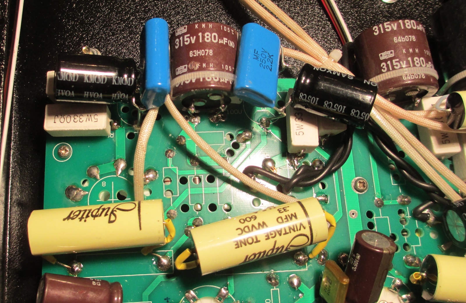

About 3 years ago, was at the same place wondering the same. I bought the Bewitch 6550. Stock sounded pretty good. But like you found the Lampizator website and decided to try his mods. one of his mods was removing all the GNFB. I tried that but sound was too uncontrolled, so put about half the GNFB back in. Then did all the resistor changes, cap changes, etc.
The coupling caps made a pretty big improvement. Originally had Jupiter Vintage Tone caps in, then replaced them with Jupiter copper foil caps.
The amp is very sensitive to ground hum, so if you remove the input connections, make sure you get a really good hot solder connection on the ground wire.
Of all the China hifi amps I have tried, its one of the better sounding amps. The other is the Music Angel EL34 amp. If a person hot rods that amp, it makes REAL music. One of my favorite tube amps, at its rated power output.

You are welcome. I did the upgrades in stages. First did the coupling caps, installed Jupiter vintage tone. then replaced them with Jensen Copper foil caps.
After that tried experimenting with the GNFB. Lampizator says he removed it all (lifted one leg on the GNFB resistor) I tried that but got too wooly sounnding and lacked definition. I finally soldering in a stereo pot with shielded leads so I could adjust GNFB while listening. I ended up at about half of the original GNFB the amp came with stock.
Next tried the lampizator mods where you change the plate and load resistors to enable 6SN7s in all the four octal sockets across the front. and went one step further by installing MILLS Wire wound resistors in place of the carbon film resistors that came from the factory.
If I were to rate the sonics improvement on which mod made the most significant improvement in SQ (sound quality). The top 4 choices would be the coupling caps, reduction of GNFB, selection of better quality input tubes, installation of Shuguang KT-88-T power tubes.
The other changes made small improvements but those were the biggest improvements mentioned above.

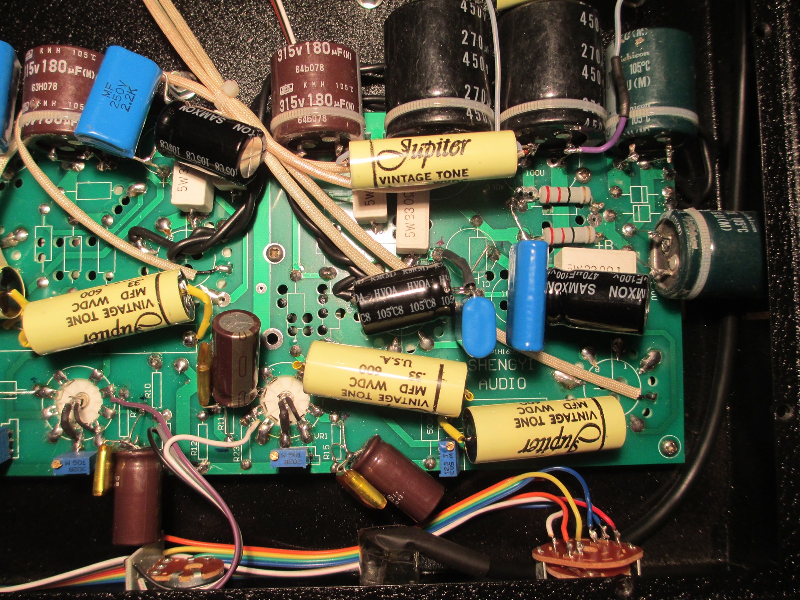

I'll add some photos of the music angel. With not too power hungry speakers, and Shuguang 6CA7 fat bottle power tubes, it has one of the best glue bond joints between your rear and the listening chair (ability to keep you listening for extended periods) of any amp I have tried.
the Key on the music angel is to add bypasses to the electrolytic cathode caps (amp is cathode biased not fixed bias). and the coupling cap upgrade made a huge improvement.
Looking at your photos below, it seems you also applied this tweak to your BEWITCH. Compared to the MUSIC ANGEL amp, did this tweak deliver a worthwhile impact on the sound of your BEWITCH amp?

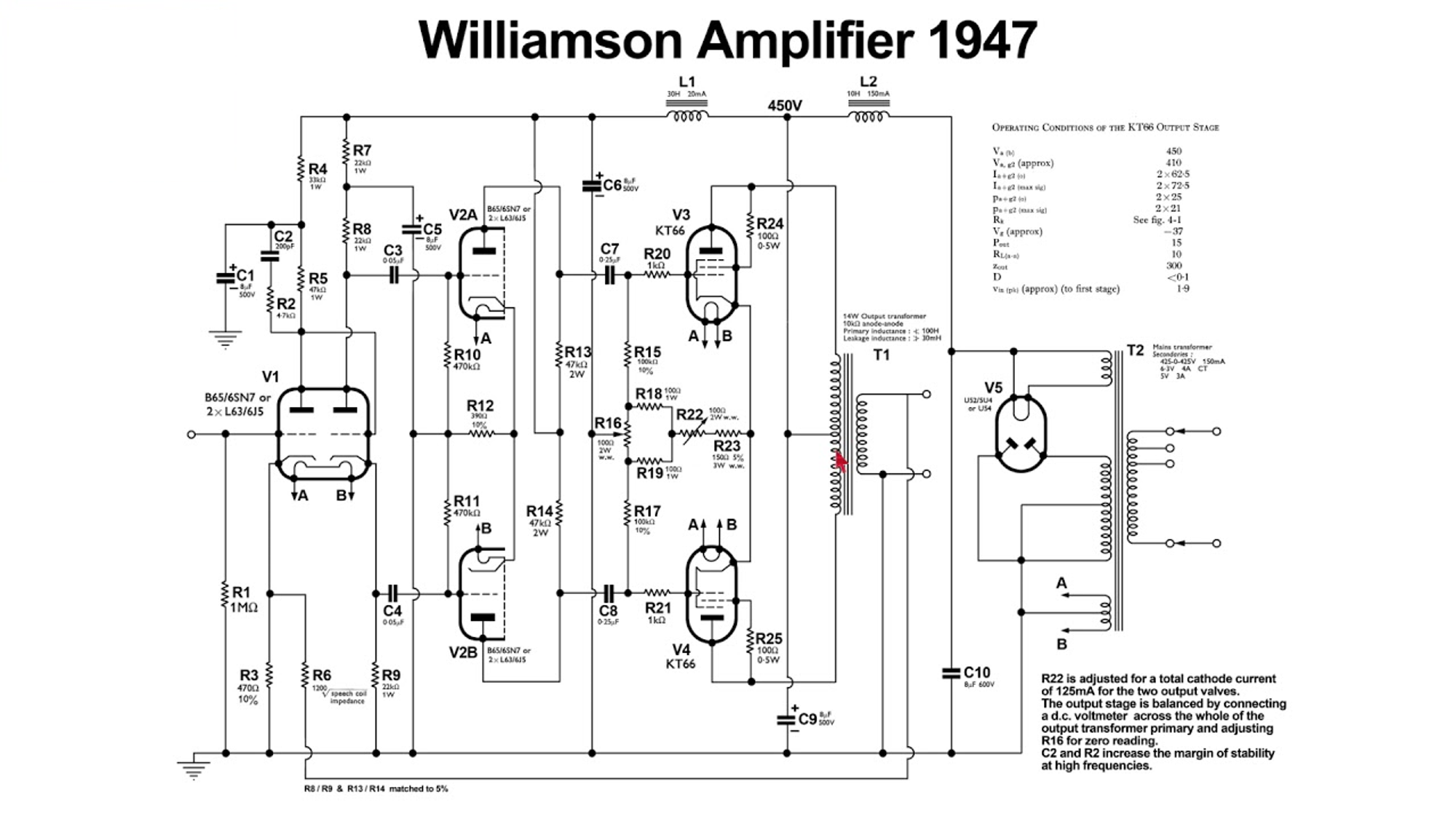

CLASSIC WILLIAMSON IDEA: Try removing Common Cathode Bypass Capacitor???
I read with interest johnss' post about how much his EL34 MUSIC ANGEL amp improved, as a result of bypass in EL caps used in the Cathode Bypass Capacitor.
So I was thinking to try bypassing the Common Cathode Resistor Caps on the BEWITCH, with some no EL caps.
[Johnss' photos give me some ideas about what cap values to try...]
After a bit more research on this subject however, I discovered that one of the time-honored amp circuits of the past - 1947 Williamson Amplifier - very successfully used common cathode bias resistors... But with no bypass capacitor at all!
Evidently, the Williamson circuit sounds better this way.
I'm wondering if removing the Common Cathode Bypass Capacitors altogether - from the BEWITCH circuit - might be an interesting experiment?

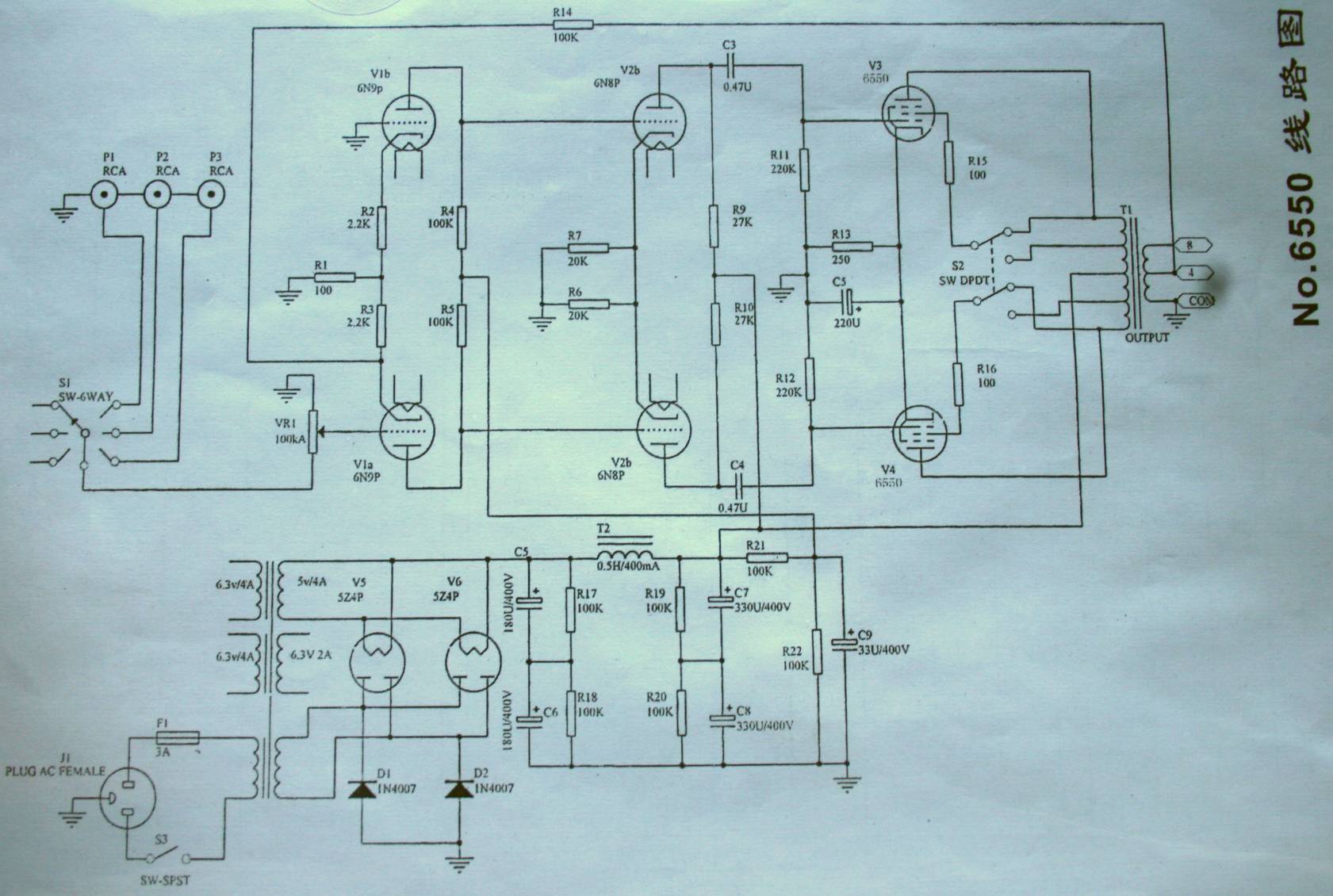

REPLACEMENT RESISTOR POWER HANDLING: Advice please?
As described below, I have had a range of new 2W resistors arrive, for the purposes of further tests on the GNFB position - which currently sits at 100K, ex factory.
Although the schematic calls for 2W resistors, I have noticed that the new 2W resistors that have arrived are considerably smaller than the resistors that came with the original factory built amp, in those positions.
Perhaps the factory had a bin full old 3W or 4W resistors they wanted to use up? Maybe they thought 3W / 4W resistors sounded better in those positions? Who knows?
QUESTION: Will a 2W resistor in the GNFB position on this circuit, provide adequate power handling?
COPY OF CIRCUIT: To Support Previous Question...
In the hopes that someone can answer my previous question about resistor power handling in the GNFB position, here is another copy of the original circuit.

.....QUESTION: Will a 2W resistor in the GNFB position on this circuit, provide adequate power handling?
Are you asking for math help?
Self-biased P-P 6550. 35-45 Watts dead clean, maybe 80 Watts gross distortion.
The NFB is taken from a "4 Ohm" tap.
The 100k (or larger) NFB resistor has a small resistor at the end. But basically it is in parallel with the 4 Ohm 80 Watt load, sees the same voltage, will dissipate 4/100,000 the power.
80W * (4/100,000) = 320/100,000 = 0.003,2 Watts.
A 2W part is 625 times bigger than truly needed. We usually go 2X or 10X more than "needed" to ensure low stress and long life. 600X is quite generous, but not a problem.

QUESTION: Shared Cathode Resistor (Safety) Change?
Despite some judicious parts replacement - better coupling caps, etc. - our BEWITCH 6550 integrated amp is now fully configured as per the original factory schematic. Sounding better than ever for it too!
We have no plans to roll-in KT88 tubes, as it will likely put the transformers under additional stress. The stock NOS Russian 6550C tubes sound great.
I wanted to address the potential risk around the low-ish resistance value of the Shared Cathode Resistors. It has been made clear earlier in this thread that each individual 6550 should have its own (approx. 500-Ohm) Cathode Resistor.
Opinions seem to vary about exactly how much is a safe minimum, but it is evident that (the current) 375-Ohms resistance shared between two 6550 tubes working in triode, may not be enough to be safe.
In the present Shared Cathode Resistor configuration (R13), each pair of output tubes shares a cathode resistor - two paralleled 750-Ohm / 5W sandcast resistors, effectively presenting a 375-ohm resistance to each pair of 6550 tubes - with a total of 10W power handling. Interestingly, the BEWITCH 6550 factory schematic specifies 250-Ohms and the actual circuit-board labelling asks for 390-Ohms, so it seems that even the factory design team has had concerns around the resistor values in use here.
Until I figure out a way to install an individual Cathode Resistor / Bypass Cap for each individual tube - which could be months or years away - it is in my thinking to immediately reduce the risk of failure by: -
Replacing existing two paralleled 750-Ohm / 5W sandcast resistors, with two paralleled 2.4K-Ohm / 12W wirewound resistors, effectively presenting a combined total of 1200-Ohms resistance to each pair of 6550 tubes - with power handling increased to 20W-24W.
What do others think of this workaround please? Will it reduce my risk of melt-down? I'm really hoping the increase in resistance value won't change the sound of the amp. I'm not too bothered if we lose a few watts in total amp output power - due to increased burn-off - as we use efficient speakers anyway.
One further question I have is: If I make this increased resistor change, will I also need to vary/increase the value of each of the two stock 220uF Shared Cathode Resistor Bypass Caps?
I'd really appreciate some expert thoughts here.
