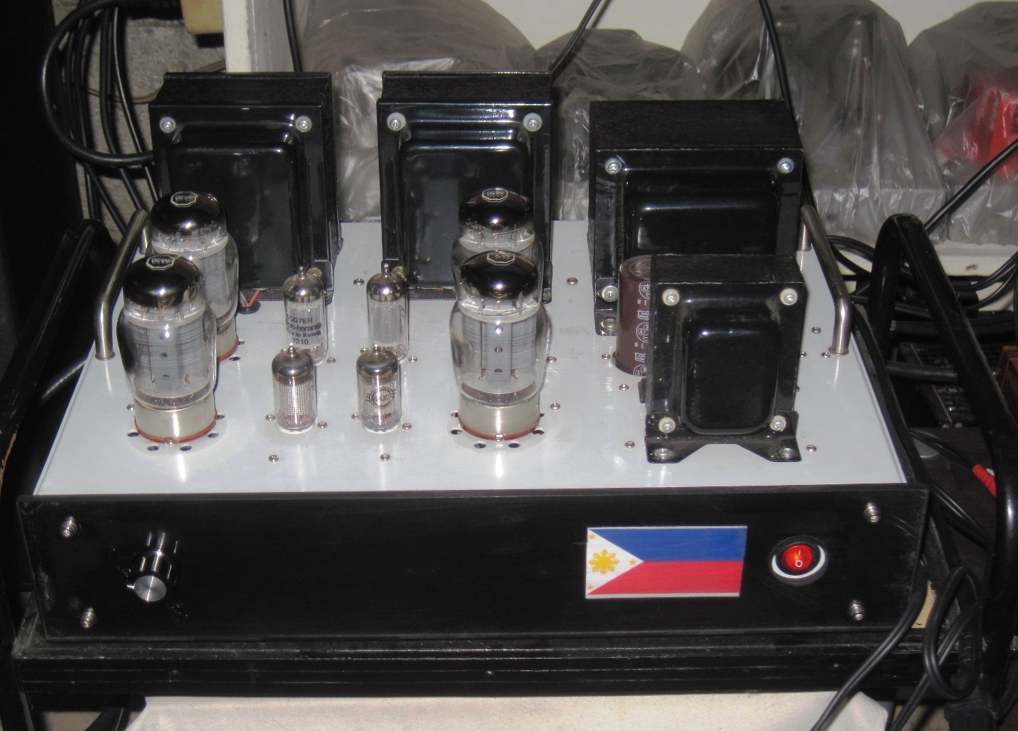

BEWITCH 6550 UPDATE... Converted back to original circuit
It's been a while since I posted an update on our BEWITCH 6550 integrated amp.
As a recap, the previous owner - a qualified EE - [prompted by a few posts by the LAMPIZATOR main man Lukasz Fikus] changed the amp circuit by: -
1. Bypassing C3 and C4 .47uF capacitors with 2.2uFuf capacitors
2. Bypassing R1 (and its counterpart - not sure what it is named) with a 100uF cap
3. Swapping preamp tube positions. Essentially both V1a and V1b swapped with V2a and V2b.
The previous owner felt that this allowed the amp to provide greater top-end extension.
To our ears though, something didn't sound quite right, almost as if there was some kind of restraint to the sound. An imbalance. So, I recently removed the additional caps and moved the preamp tubes back to their original positions.
As a result, the amp now sounds very good - and much more balanced - but perhaps with a little less detail than the previous configuration.
So I am now seeking ways to improve the sound of the original circuit.

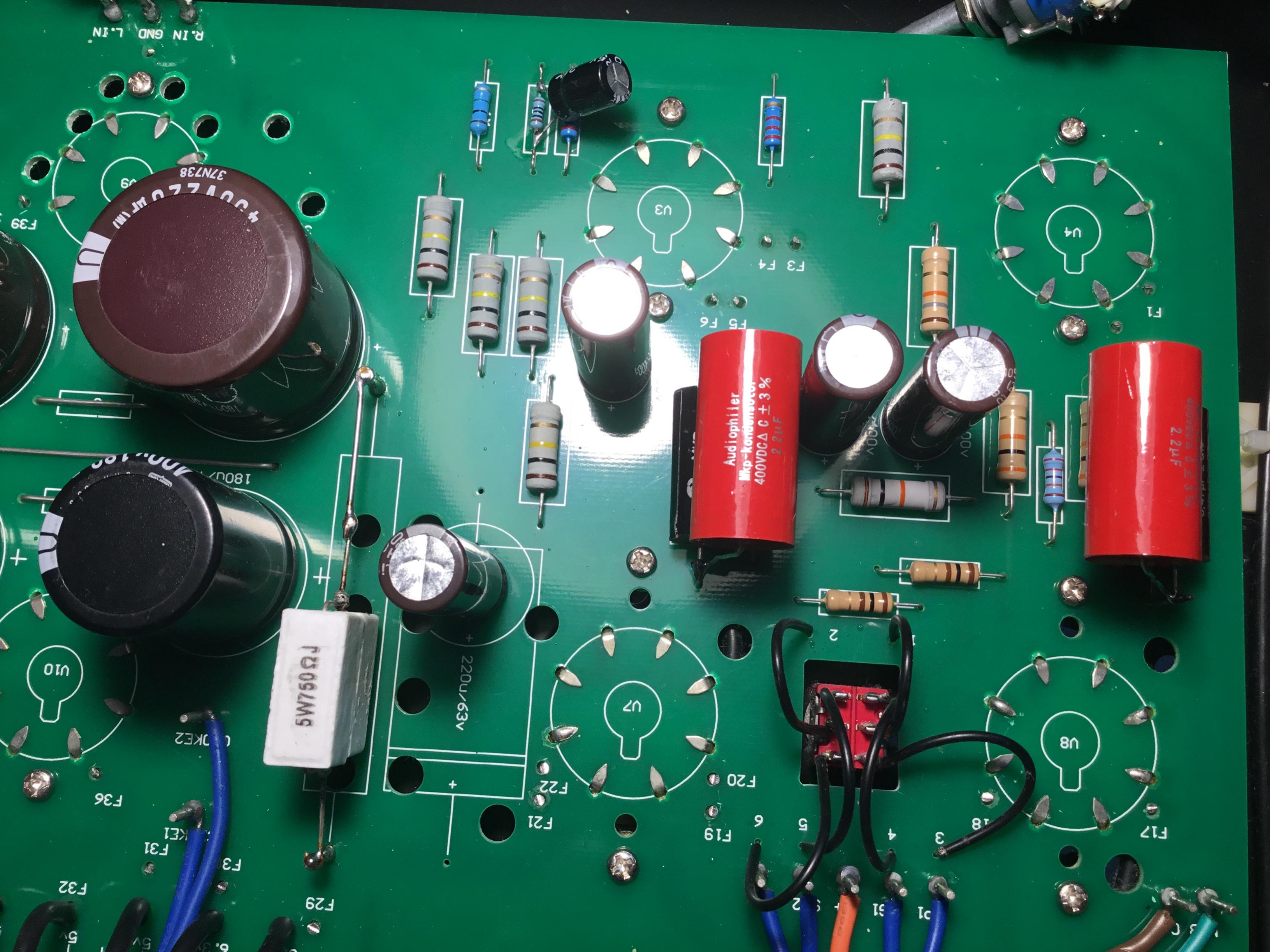

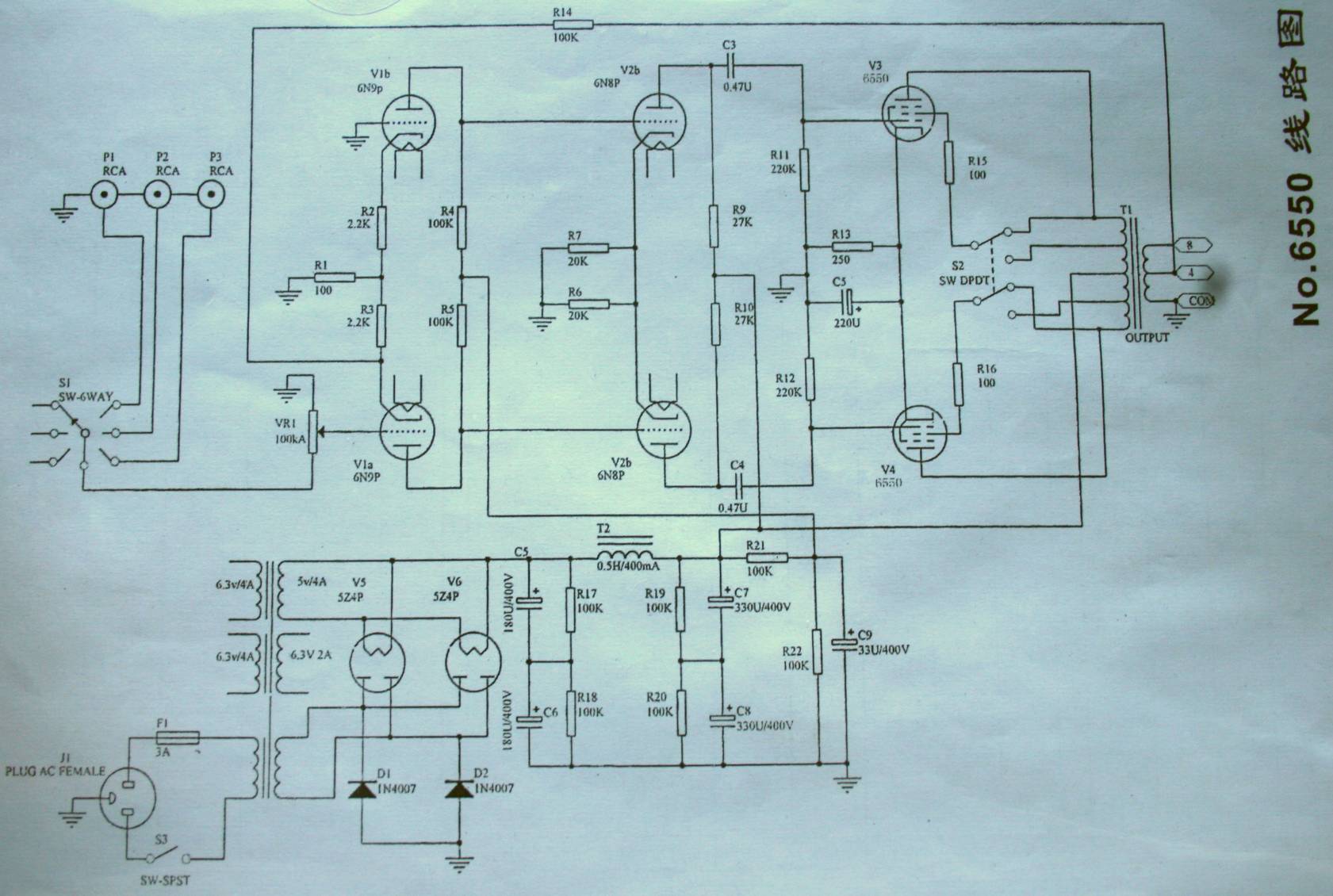

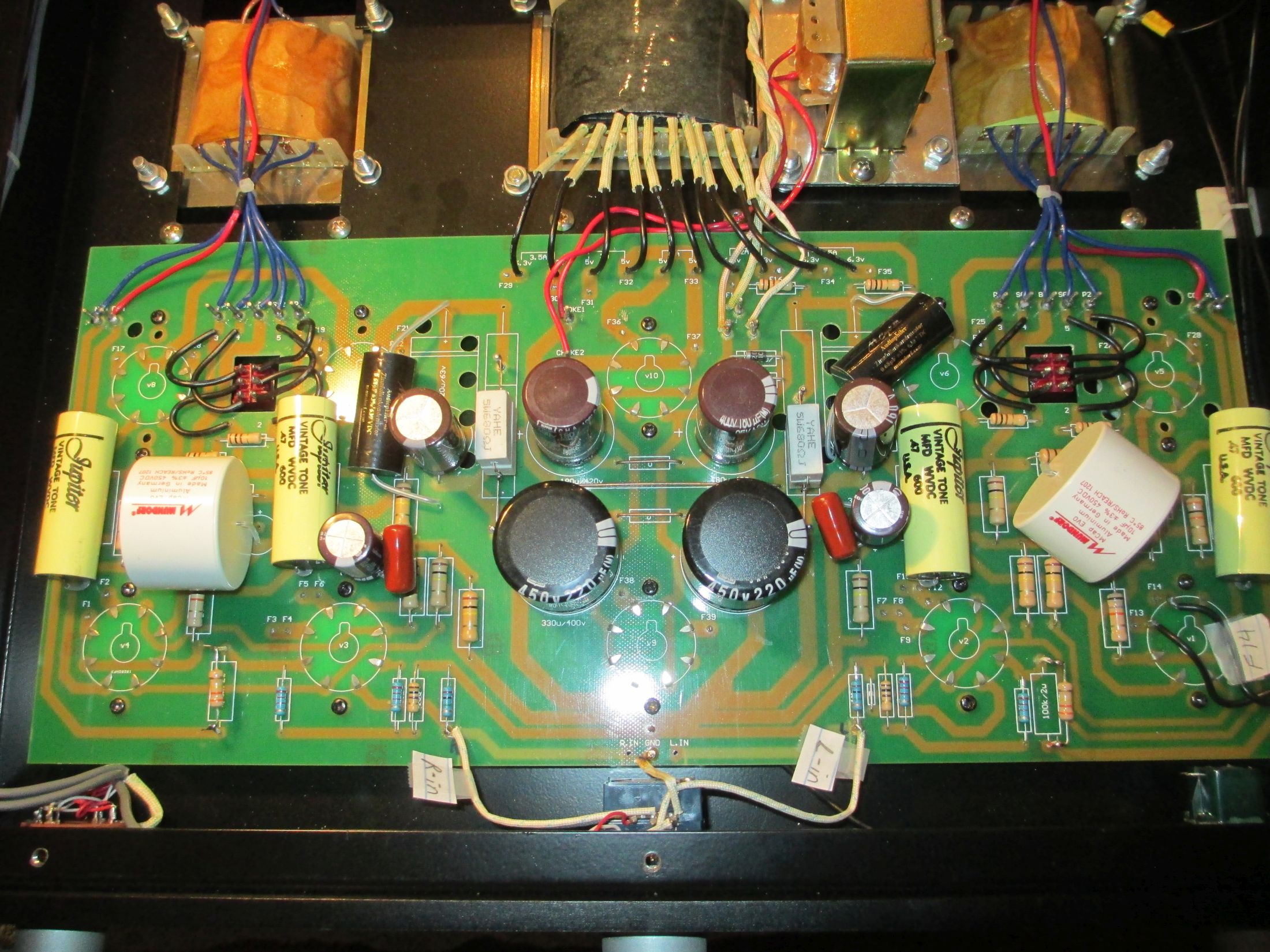

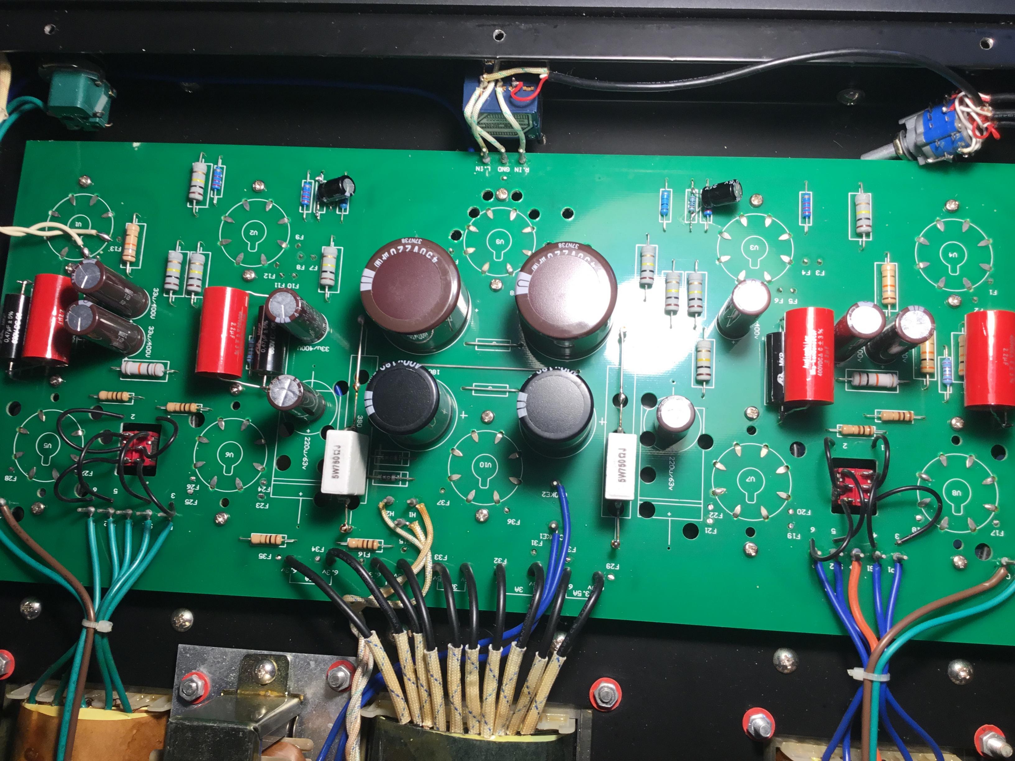

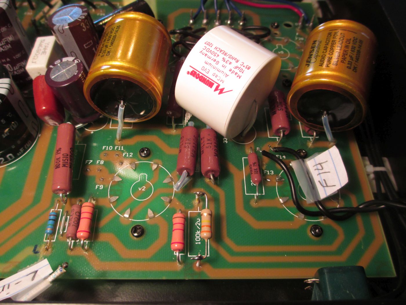

Shown again below is the original circuit - and also some photos of the amp interior BEFORE I converted it back to the original circuit.
Where worthwhile, it is now my hope to be able to upgrade some of the cheaper components to achieve improved sonics.

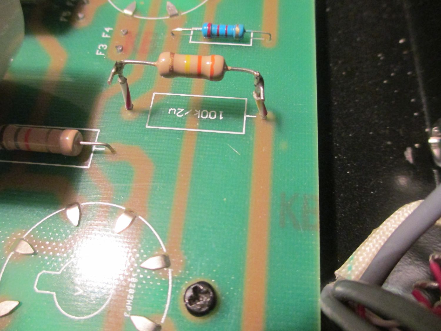

As a newbie, one of the challenges in unravelling this circuit, is trying to understand exactly which components are in the signal path - and/or impact sound quality - and which do not.
EXAMPLE: I notice that each side of the amp circuit has two 750-Ohm/5W sandcast resistors paralleled to deliver the required 390-Ohm resistance.
Sandcast resistors get a bit of a bad rap sound-wise, so I thought this might be a good component to upgrade - to Mills non-ferrous - to test this theory.
Trouble is, on the schematic, there is simply no mention of 390-Ohm resistor anywhere.
What have I missed here?

Well the first mistake was doing "upgrades" from Lampizator.
Adding 2.2ufd to those coupling caps is a recipe for blocking distortion, and completely unnecessary. With stock caps, low frequency response is 1.5Hz (approx), with the 2.2ufd is about .33Hz. Adding nothing but more subsonic noise.
Putting a 6N9P tube in the second position will kill drive to the 6550 tubes. It just isn't capable of supplying the drive.
Bypassing R1 is useless and senseless and may affect the balance of the phase splitter as well.
Those two 750 ohm resistors give 375 ohms, not 390, and they are the cathode resistors for the output tubes. That may or may not be correct depending on the plate voltage. You'd have to measure the voltage across that, divide by two and divide by the resistance to get the current through each output tube to see if it is correct.

Hi Dan, Many thanks for endorsing my returning this amp circuit to its original design - and thanks for explaining why the former owner's "upgrades" sounded wrong.
To be fair to Lukasz Fikus of LAMPIZATOR, the former owner did NOT follow Lucasz' upgrade recipe; and instead, just did his own thing. I have no idea if the exact Lukasz Fikus upgrades would have delivered a better result than the former owner achieved. This will have to remain an unknown.
The cathode resistors for the output tube mentioned below - that are currently paralleled to deliver 375-Ohms of resistance - are sitting in a position that is clearly labeled "390". I assume the manufacturer decided 375-Ohms is close enough.
The mystery to me, is why this 390-Ohm (375) resistor is not visible anywhere on the schematic. Perhaps I have missed it somewhere?

SONDEKNZ,
Your schematic in Post # 61 shows the 6550 g1 grids are returned to 220k Ohms.
The maximum g1 spec for Self Bias is 250k.
That is within the specs, but may be cutting it close, because . . .
It uses a Common self bias resistor. One tube may choose to hog the current.
You have to use very well matched 6550 or the output transformer will saturate early.
Use Robust 6550 and get away with 220k

Replace the 250 Ohm self bias resistor.
Use an individual 500 Ohm self bias resistor for each 6550.
Use an individual bypass cap across each individual self bias resistor.
Measure the voltage across all the 500 Ohm resistors.
Volts/500 = the cathode current of a single 6550.

good thing, this is how i do my pp amps....6j32/ef86, 6cg7 ltp splitter and 6550 finals..
That's the 250 ohm marked on the schematic. Design change probably.The mystery to me, is why this 390-Ohm (375) resistor is not visible anywhere on the schematic. Perhaps I have missed it somewhere?

Okay - so this is the 6550 Cathode Bias resistor, currently labeled R13 on the supplied schematic. Mystery solved!
This 390-Ohms resistor (375 actual) that is currently in place is a considerable increase over the labeled R13 at 250-Ohms.
As discussed earlier in this thread, I guess the designer realized they were cutting this way too fine with 250-Ohms and subsequently fitted 390-Ohms in the R13 position.
In some ways, it still does not seem high enough resistance.

I'm new to diy audio and have no experience in modifying amps. Few months ago I bought a Bewitch KT88 on ebay and so far I like it a lot, one of the reasons I bought the Bewitch was the positive review on the Lampizator website (Bewitch).
He also made a recommendation on some mods. I'm planning to follow his mods, but recently I heard from some people that the Lampizator mods might not be as good as he claims.
Can somebody give me some information about this mod?
http://lampizator.eu/AMPLIFIERS/CHINA/bewitch 6550/IMG_5577.jpg
About 3 years ago, was at the same place wondering the same. I bought the Bewitch 6550. Stock sounded pretty good. But like you found the Lampizator website and decided to try his mods. one of his mods was removing all the GNFB. I tried that but sound was too uncontrolled, so put about half the GNFB back in. Then did all the resistor changes, cap changes, etc.
The coupling caps made a pretty big improvement. Originally had Jupiter Vintage Tone caps in, then replaced them with Jupiter coppper foil caps.
The amp is very sensitive to ground hum, so if you remove the input connections, make sure you get a really good hot solder connection on the ground wire.
Of all the China hifi amps I have tried, its one of the better sounding amps. The other is the Music Angel EL34 amp. If a person hot rods that amp, it makes REAL music. One of my favorite tube amps, at its rated power output.
If I could figure out how to post some photos would do so.

You could also move the feedback connection to the 8 ohm tap.
That will change the feedback ratio, so the value of the series feedback resistor would need to be changed to keep the same level of negative feedback.
