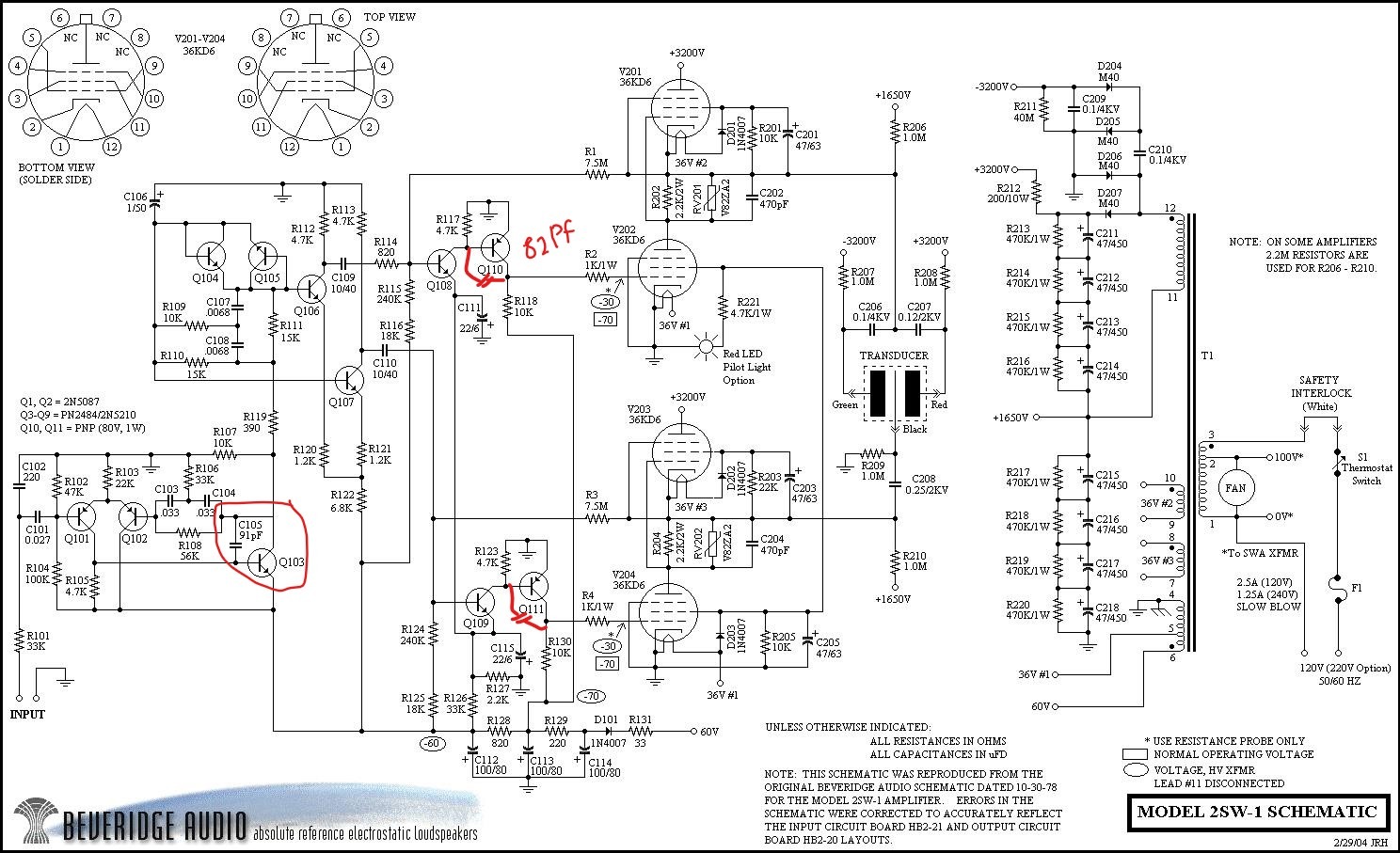

Hello to all the guys working on the OTL amps for SW-2 :
My upgrade sounds very promising with lots of high end micro dynamics and big analoge sound !!
I have a problem with white noise (HQ Swing) after replacing the XO board with a Jean Hiraga design upgrade. All new caps in the driver board has also been installed.
Does the old XO board have any kind of anti HQ oscillation that I have missed ?The old design also have an IC circuit but I dont know what it does ? It seems that the noise are beeing transmitted to the other speaker as well as a HF transmitter.
When i touch the chassis on the outside the noise goes down.
Grounding are done on the driver board only.
The wires inside are also supplyed with ferrite perls everywhere.
I have put 82 PF in parallel over the out put transistor in the driver bord, see attached file. This stabilize the circuit a lot but it affects the sound quality.
The white noise goes almost away after 1 hrs warming up, but occurs only" like dust on the cartridge " in the dynamics ex piano midrange.
Hope for som input 🙂

Hello @Bmalskr
Does this noise exist if you go back to using the original crossover board? Most users disband using the original crossover board because better solutions now exist for self powered subs-- I have abandoned this board. The IC chip is a quad op amp used for cross over.
It is definitely oscillation- I am experiencing the same effect "white noise"that you describe on my pair. Have you looked at the output with a high voltage probe on what would be the electrodes "red" and "black" --- it is quite obvious on the scope.
I have not been able to pin down the oscillation- I am getting some advice from an experienced member hear that is trying to kindly help over long distance.
I am just wondering where the source of the oscillation is... It is a difficult circuit to manage because of the HV... Can you observe oscillation without the HV taps to the board connected on the input board alone. I know you can only get so far- because of the feedback required by the 7.5M resistors but it would be interesting to see how far on the input the signal is clean.
My suspicion is that its happening on the HV side and being fed back
Have you changed your transistors from original - if so to what?
Where exactly have you placed the ferrite beads?
Let us know!

I think that you experience the same thing than many of us has been struggeling with... internal isolation problem in the power transformer!
Those "sparks" creates spikes thats is transferred to the other speaker. It was not that easy to understand! Many months of scratching my head.
