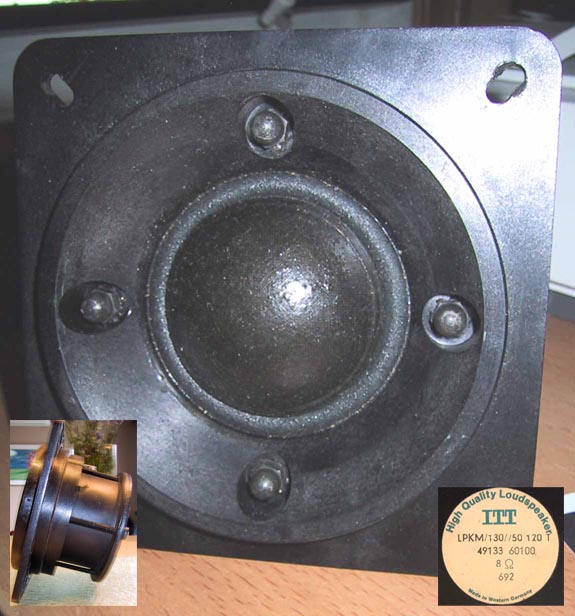

That strange rear-baffle plate comes from the design of the original, from which the ATC seems to stem, the SEL/ITT 50 mm dome that also had the double suspension way back in 1973 or so:
Martin Colloms gives a crossectional diagram of the SEL/IT unit on page 120 of the 2th edition of High Performace Loudspeakers showing a certain resemblance between the two. The design is of the ITT unit is rather unique. The motor of the ATC , however, is very different.
Strange indeed! Thank you
