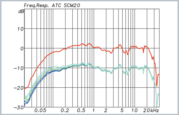

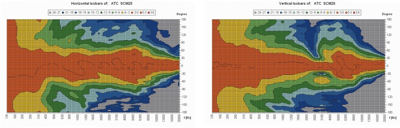

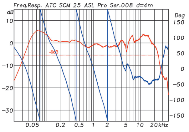

There are not many measurements from ATC around. I have reliable measurements* of the SCM 20 and SCM 25 ASL. The second one uses the 3" dome. THD-limited maximum SPL in the midrange is still lower than of the Neumann KH 310. This is nothing to complain, because, it is still high.
I only complain about the frequency response which is pretty bad and very different on both ATC monitors. Additionally ATC doesn't control directivity. I find that the biggest flaw of their monitors. Even in well-treated studios there is always a power response.

I can not judge all speakers from ATC, because I have only measurements of two smaller models. It seems that they tried to compensate the bad power response with an inverse direct sound. This only works if direct sound and diffuse sound have the correct proportion. In nearfield this will fail completely, because direct sound dominates. Both speakers vary by about +/- 2.5 dB in very broad frequency ranges.
Compared to the (much cheaper) equivalents from Neumann and Genelec these are not very good designs.
Please take alook at these plots:
SCM 20:
attachment.php
attachment.php
SCM 25 ASL:
attachment.php
attachment.php

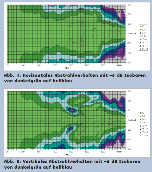

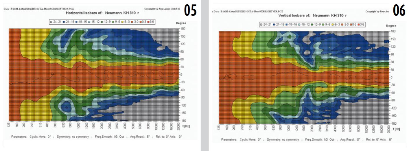

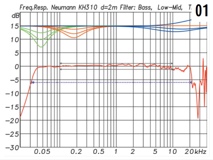

And for comparison the Neumann KH310. It has a better power response, a linear amplitude response and it costs only one third (!) of the SCM 25.
Neumann KH310:
attachment.php
attachment.php
If so then I refer back to my previous assertion that a speaker is no fix for poor acoustics just as good acoustics are no cure for a bad speaker.
Of course. But I don't see a smooth power response as a fix. It is a must-have. 🙂
The SCM20 is a two-way speaker and therefore subject to different compromises. It is not therefore the right place to add it for comparison.
No. As far as I am aware there is no equalisation applied
Yes it does. Quite extraordinarily so! Whether it is a match for the ATC in other aspects of its performance remains to be seen...
I just added it to show the differences in amplitude and power response. If you compare it to the 2-way models from Neumann and Genelec the conclusion is the same. 🙂
There may be no special equalization applied. There are other ways to "shape" the amplitude response. Maybe I'm wrong with my assumption, but I see a slight correlation between widening in directivity and drop in amplitude response on both speakers.
Of course I can only tell from the measurements. Decay and maximum SPL is good on both speakers. I don't know what about reliability of operation etc.

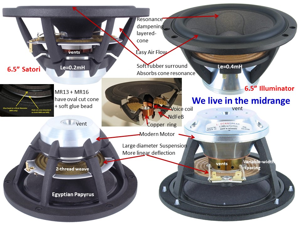

The ~$500 Volt VM752 3" textile dome midrange is used in a couple diyAudio monitors.
The Scan Speak 12mu-4731t00 has exceptional measurements, 90db SPL
The SB_Acoustics Satori MR13P-4 and MR16P-4 are medium priced
The SB_Acoustics SB15NAC30-4 and SB_Acoustics SB17NAC35-4 are modest priced aluminum cone mids.
SB_Acoustics sells modest cost 5" SB15NAC30-4 and 6.2" SB17NAC35-4 midranges with a ribbed aluminum cone for crisp details with reduced cone breakup. A search will bring up several designs.

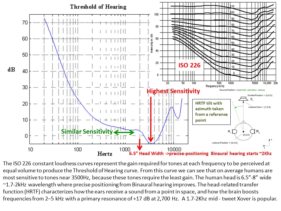

For consistent TONE, a speaker designer using DSP with 1-amplifier per driver can put the human vocal range (80-1100Hz) (E2 to C6) on one well designed midrange driver... like the Satori MR16P-4, which trades some dynamics (~91db SPL) for a smoother frequency response. The MR16P-4 has an elliptical cut cone and a ring of soft silicone around the back of the cone.
Copy of earlier post====
The ISO 226 constant loudness curves represent the gain required for tones at each frequency to be perceived at equal volume to produce the Threshold of Hearing curve. From this curve we can see that on average humans are most sensitive to tones near 3500Hz, because these tones require the least gain. The human head is 6.5”-9” wide ~1.5-2kHz wavelength where sound positioning from Binaural hearing improves. The head-related transfer function (HRTF) characterizes how an ear receive a sound from a point in space, and how the brain boosts frequencies from 2–5 kHz with a primary resonance of +17 dB at 2,700 Hz. A 1.6-2Khz mid - tweet Xover is popular.
