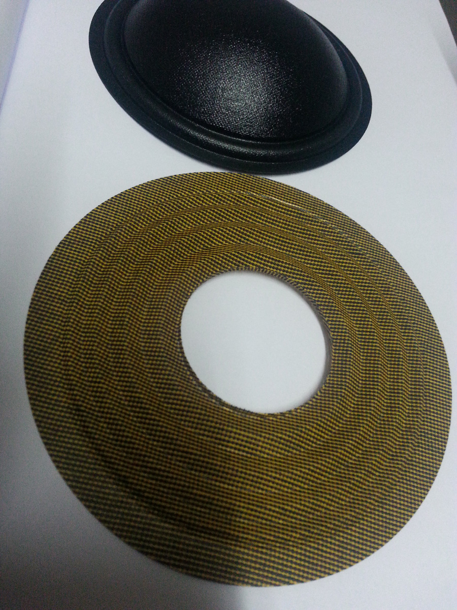

pic of the dome and the suspension type ( size of the suspension will be much larger than shown here but the material is same )
The speciality of the suspension material is the threads woven has very low twisting tendencies at higher excursion. Since the excursion of the mid domes are lower it works perfectly linear.

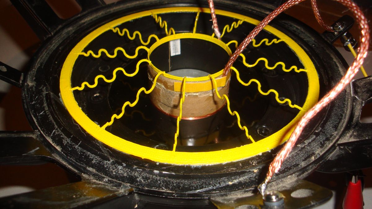

Suspension open on both sides to have compression free operation
Voice coil vents provide some more reduction in the compression.
Spoke to the companies who are providing the suspension and they said larger the suspension more will be its linearity. 167mm Overall suspension diameter.

Regarding the collar ( it contributes the signature )

Double spiders are not recommended as the linearity is disturbed
