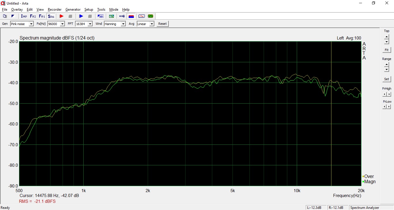

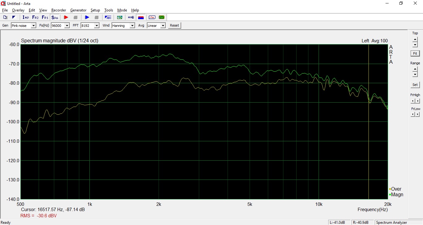

I have obtained a very nice sound with Selenium d220ti screwable version, an adaptor and a chinese clone of eigtheen sound xt1086. With only a series 3uF cap, a `parallel 1 mH coil plus 30 Ohms R, and an lpad to adjust level, measured some 30 cm from mouth look like this (i`m using it with a 10` woofer, though). The flatter response is with the simple passive x`over. The other is with no crossover.

  • d220ti en xt1086, driver en bruto(green) vs driver con 3 uF-2mH-30 Ohm.jpg
another view, two drivers nicely matched, indoors, some 30 cm from mouth, measured using a DIY mic with CMA-4544 (CUI inc) electret capsule, and the laptop card; nothing fancy, but good enough for government work.
D220ti is tweaker`s delight: some felt on the backcup, a copper ring made with a circular soldered wire tightly packed in the bottom of the voiice coil gap, and a very thin coat of diluted modgepodge in the diaphragm (use a turntable and a camel hair brush to do it neatly).
I always tought that reflections on the back chamber were part of the `intended design` -original voicing- of the driver; anyway, the sound gains in midrange weight and smoothness with some felt added. I used the tight wool variant.
If you go this way, use a battery to center the voice coil prior to the adjustment of the 4 screws that hold the backcup: the `autocenter` ring is for a hurry and ballparking, but the response is vastly bettered (and pairs easily matched) with a very short pulse from 3 volts DC to center the VC.
