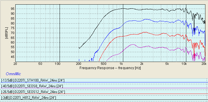

I tested the D220ti with other horns. Click HERE for the plots.

..the narrow vertical opening won't allow for much alteration without harm on the H812, and there is about an inch of height beyond that of the OP's requirements.
(..it would also need a good screw-on adapter (2 bolt) for his needs.)
Great response (with low freq. extension) though. (..very good for a 15" driver combination.)
Great charts. Thanks Michael.
You're welcome.
If those graphs depict the drivers on those horns with no crossover or compensation, isn't the 810 a no-brainer? That is SMOOTH! I had to print those out and keep them.
Yes, there's nothing between the power amp and the CD. I don't need to insert any capacitor for protection because OmniMic has a sweep that is "without Bass".
Also, no compensation or EQ, so what is shown is the RAW response of the CD/horn combo.

There's no need to test. The response is the same with a proper adapter.

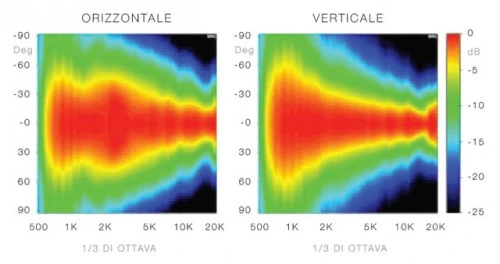

Unfortunately not constant directivity at all 🙁
One needs to understand that not everyone prefers the sound of constant directivity for their home-use horns ( within their own unique listening environment ).
I might prefer to listen to this directivity type ( seen below ) in the vertical orientation.

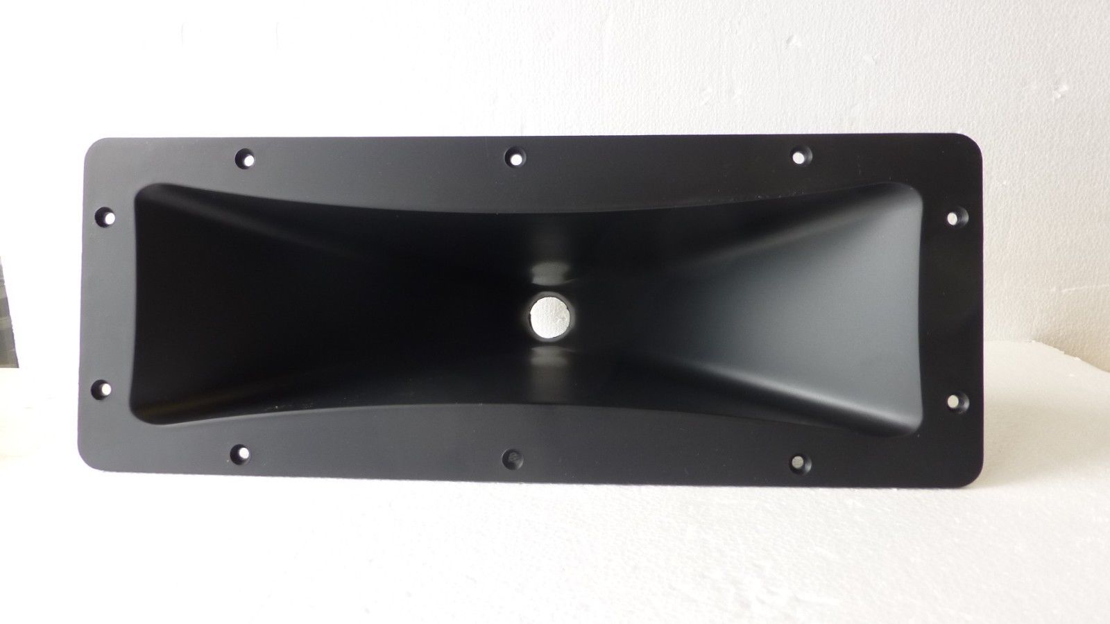

The eminence H290 is another well thought out biRadial that has a good balance between lower octave loading and directivity . It's still a small 12"x6" horn.
It is pretty amazing that the Dayton, Eminence and JBL 6 x 12s play well with just about anything. I have them in use and also listen often to the QSC equivalent and my large and small JBL butt cheeks (2342 & 2344) - it's all good listening but I keep my ears open for anyone who discovers another inexpensive, but great, performer.
Earl, have you worked with that one? (ZXPC)
No,, not the one that I just posted a link to ( my recommendation is driven by price & ease of acquisition ).
OTOH, I bought a pair of ZXPC biRadials last year ( they're very close to the size of an Altec 811b Radial ) .
- They need a lot of work ( smoothing in the throat area ) to be considered a usable horn ( IME ).
- After the mods were done they turned into a good 811b standin.
