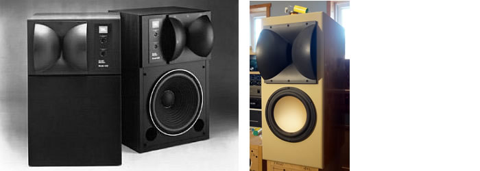

The Blackbirds look fun. I LIKE 'em.
I just sanded a pair of boxes and built the crossovers for a pair of vertical 4612 Cabaret clones. Imagine them bi-amped so I can run LE14As for the bottom! Just came in from the garage doing that.
Looks like I can put a finish on them, install the drivers and fire them up this weekend. I'll pull these out to poolside for a little fun. Getting warm (but rainy right now) here.
Thanks. Glad you like them.
I would like to make two versions in future. One with a 10", possibly a JBL 127H and the other a 12", a Dayton PA310. I have these woofers in hand so it's just a question of building the boxes.

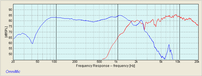

I managed to cross the M8a at 1.5kHz. Believe it or not, with a 1" dome tweeter, the HiVi TN28. Not something I usually do.
