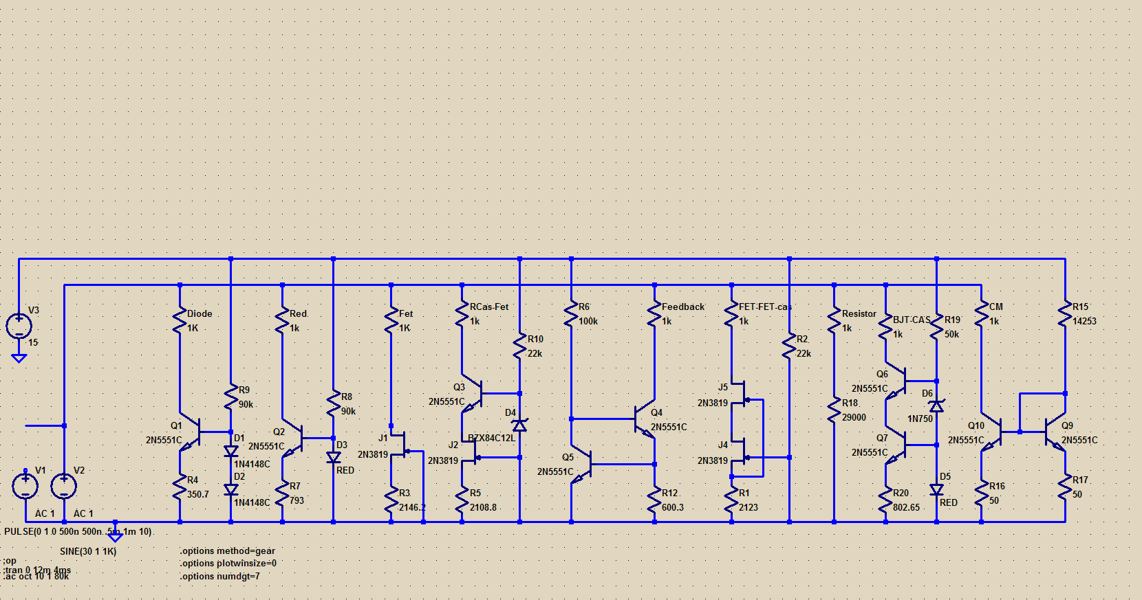

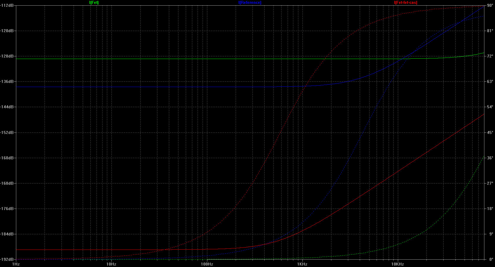

Which ever topology, most asume a constant current source. I have been playing with them. Two things are readilly apparent, the first is the are far more of a CCS than just a resistor. THe effectiveness of them as a ccs does vary with design quite a bit, but compared to a resistor, the worst is vastly better. THey do vary a lot by device. As I expected, you need both very fast and very high gain. No surprise.
So, here is the question: In the following plots, would you pick the design that is far stiffer, but changes radically over frequency, or the less stiff design that is very consistent? Just for reference, a standard red led is about half way between the two, a resistor is at 90dB.

Not an answer to your basic question, but:
The two-FET design, to work well, needs a higher-pinchoff-voltage part for the upper device. Then your return of the upper device's gate to the lower source will work quite well indeed for much lower output capacitance at the upper drain. You may need a few more volts overall for best performance.
BTW, what is R2 doing?
bcarso, Good question. R2 is clearly not doing a darn thing. I think when I started, I had a resistor from gate to ground.
I am greatly hampered by the very limited models for parts. The 2N3819 is the fastest one in LTSpice. To actually use it, one needs to add a 10K resistor in the tail so it stays within it's voltage range. Small hit to performance, but better than the other models.
JCX, These were the versions I dug up. I am sure there are many more. I'll do a bit of searching on bootstrap versions. Like anything, one can keep adding parts and beat it to death. I limited it to two active devices arbitrarily. I have seen all of these in use. I'll do some searching on bootstrap versions. Extending their bandwidth would seem to be a reasonable goal.
Such a simple thing, a ccs. Humph. I just need that part that is in Spice, you know the one with two circles that works perfectly. Funny, it has no part number 😀 I guess the only way to see how transistors I might actually use work is to breadboard them. 2SC1775, 2SC2240. I really don't know about available JFETS. They seem to be very limited.
For the moment just put a voltage source in series with the upper FET gate, to bias that part up a few volts. It will then resemble a higher-pinchoff part.

Bootstraps don't work very well. Tried a couple. More linear, but barely better than a resistor.
Tired splitting the resistor feeding the red led and returning that to the lower rail. Exactly the same as without it.
The current mirror is not terribly stiff, but very linear. I see it used a lot on VAS. Never seen it on an IPS. That goes back to my original question of which is more important, overall impedance or linearity? If suitable FETs existed to make the fet cascode linear through 20K, that would be the ticket. Just a single FET, or the conventional led BJT with a transistor of sufficient BW and gain would be reasonable. How about a Darlington? Oooh. Gona go try one of those.

Summary: If linearity is most important, the basic feedback is the champ. If absolute stiffness, the FET cascode. With a suitable device, the single FET is about between. In reality, the traditional BJT-LED works darn well. This leaves out all the reality factors of non-perfect rails, thermal issues, phase of the moon, left rear castor.......
I did three tests. The AC analysis for linearity, sine wave on the load to see the variance in current, and a square wave to see how it handled steps. The square wave was the one place the BJT cascode came out on top.
The thing here is to appreciate what this CCS is for. Having a not-so-high but constant load on the "VAS" versus a much higher but frequency-dependent load --- which of those results in better overall performance?
