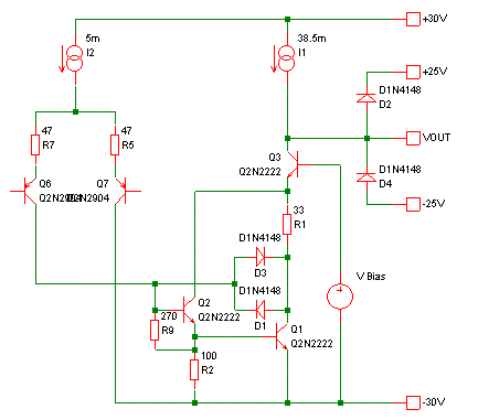

It sounds like you're talking about Vbe multipliers for output stage bias, rather than voltage gain stages.
lol sorry its a while since I designed any class AB amps and got the VAS and Vbe mulitpliers mixed up.
Yes, the whole point of it is to provide bidirectional current limiting in conjunction with D1 and D3. In practice, there's a couple of gotchas. The trick is to make sure that neither Q1 nor Q3 can turn off. IIRC, the main things to be aware of are Q2's collector current being added in at Q3's emitter, and that the full input stage current flows through D1/D3 during clipping.I especially like the collector resistor R1. This doubles up as a current limiter as well.
I guess it does, but that wasn't a design consideration. I expect that allowing voltage swing on Q1's collector actually makes distortion a bit worse, especially as Vce is so low to start with. I considered that a small price to pay in exchange for civilized clipping behavior though.Does R1 act similarly to Puefue's "magic" resistor? i.e. trying to maintain constant power dissipation.
Not really, it just lowers distortion a bit and gives higher gain. A more normal approach might be to connect the bottom of R9 to the -30V rail, but if you do that, then the voltage across R9 = Vbe of Q1 + Vbe of Q2. The problem is that the signal voltage across Q1's base-emitter junction is much larger and more distorted than that of Q2. With a current mirror, it's not an issue as there's no input resistor.Does the compound current route R9+R2 as the input collector load, change the way the VAS works?
I'd want to clip the output a few volts before the output stage reaches it's limits. My approach would probably be to run the front end from the same rail voltage as the output stage but with extra filtering, and then set the clipping level 5 volts or so below the front-end supply voltage.Would a pair of 25V Zeners from the +-30Vdc supply rails work as the voltage limiting +-25V references?
Or.
Would it be better to run the next stages @+-25V and then the VAS limit would match the next stages capability?
IMHO it's a mistake to use higher voltage rails for the VAS than the output stage to maximize output power. Sure you get a couple of extra watts, but clipping behavior is horrible.
Agreed, that's the purpose of R1, D1 and D3. The voltage across R1 is proportional to the VAS current. When the VAS current gets high (or low) enough, D3 (or D1) will start conducting to prevent any further input to Q2's base.

Makes sense. I bet where the higher rails are used, additional protection circuitry to make it more beguine is employed. That's one thing I noticed between top amps of the 80's and now. New ones have a LOT of parts for management.
Why such high VAS current? The other amps I have looked at are more like 6 or 8 mA.

jcx, I am using a beta enhanced VAS that feeds a cascode. And the whole amp has TMC and it appears to be quite stable and I have done a lot of testing on the physical amp. I prefer to see TMC as 'transitioning' the output stage (triple in my case) out of the global feedback loop at HF rather than positive feedback, or are you perhaps talking about a different mechanism?
I think in a classic Darlington connection to the VAS you talk about Homeodder then Cob indeed is an issue, but the VAS feeding the cascode is a little different. Sims show a very big improvement at HF (both with and without TMC). The whole idea of fixing the collector voltages is so that changes in Vce cannot take place and changes in Vcb are minimal anyway (a few mV) However, I'd be interested to see you findings - I might be missing something here.
It is a bit over the top. I was using a double EF output stage and wanted a VAS with very low output impedance and high output current capability, to drive it with a "fist of iron". (The low output impedance happens with local feedback connected, but requires high current gain, hence the Darlington)Why such high VAS current?

I was under the impression that you were opposed to high feedback amps.
Godfrey, the circuits shown by you have a lot to offer in terms of performance. Worth trying.
So essentially are there no Miller compensations caps anywhere?

It is important to keep in mind there is no single “optimum VAS” – the rest of the amplifier circuit determines if some “enhancements” have any impact or are swamped by source/load effects
Very true!
I don’t think the proponents of TMC give the stability issue enough emphasis – in fact I suspect most are ignorant of the potential gotcha in TMC loop stability from the positive feedback around the output stage
TMC is potentially dangerous in inexperienced hands -
Again, very true. But TMC is no more 'dangerous' than TPC. Both affect the PM and GM to the same extent.

I'd certainly encourage anyone using TMC to try the equivalent 2-pole with matched high frequency gain, stability (not the same component values; search for user: megajocke posts in the Cordell book thread for equations)
I suspect some would reject the 2-pole comp for appearing unstable - not realizing their TMC is "the same" on stability
as long as people fully understand the stability equivalence then they can decide on the performance differences in their amp's particular circuit topology
my sims shows matching gain intercept with TMC, conventional Miller, measured in the outer, global loop gives a higher "true" gain intercept for TMC as measured around the output Q, and less phase margin: http://www.diyaudio.com/forums/soli...lls-power-amplifier-book-134.html#post2420438 - and next page
judging TMC stability from analogy with conventional Miller, or based on step response damping will be overly optimistic

Compensation is just not shown, but practical circuit would require.
Edmond/jcx, what cross over frequency do you normally shoot for with TMC assuming 1281/1382 output stage and an equivalent MC ULG of say 1MHz? I have tried from 500KHz throght to nealy 1MHz without too many problems. However, I will admit I always err well on the side of caution with loop gain and ULG. Interested to know your views.

“proper” cascoding requires VAS degeneration R, returning/recycling the common base Q base current – well explained by Hawksford
really high gain, linearity VAS then deserve 2-pole compensation to make use of the gain to linearize more of the amplifier – “TMC” is an option but traditional 2-pole splitting of the Miller C gives largely equivalent results and greater improvement of input diff pair linearity
I like to add that TMC gives greater improvement of the TIS (formerly called VAS). That's why TPC and TMC give largely equivalent results (sometimes TPC is slightly better, sometimes the other way around, depending on circuit details)
As for linearizing the input stage together with TMC, this topic has been covered here: (Super TIS)
