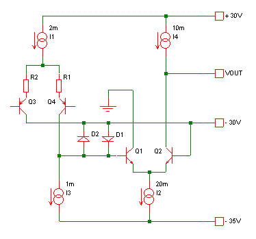

The front-end consist of a push pull cascode (folded cascode) - very similar topology as used in OP-amps with very high GBW product.
Link please.
Are you asking me for a link? I don't have one. I invented it myself.
Yeah, sometimes I find a thumb. (from Defying Gravity)
Are you teasing me? Anyhow, may we have a look at the schematic, please?
No, I'm not teasing anyone. I just thought it was simple enough to not need a picture. Here's a portion from a schematic I developed.

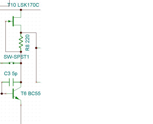

I think in a classic Darlington connection to the VAS you talk about Homeodder then Cob indeed is an issue, but the VAS feeding the cascode is a little different. Sims show a very big improvement at HF (both with and without TMC). The whole idea of fixing the collector voltages is so that changes in Vce cannot take place and changes in Vcb are minimal anyway (a few mV) However, I'd be interested to see you findings - I might be missing something here.
Last night just to be sure I dug up my books, looked at the maths which suggest I was on the right path.
Then I did a quick check with LTspice and this confirmed theory and a little hiccup.
The beta enhancer does outperform cascoded darlington at high frequencies, no surprises there for me, its not a vast difference but it is there. At low frequencies the cascoded darlington should show slight better THD figures but it does not in ltspice, comes up as =.

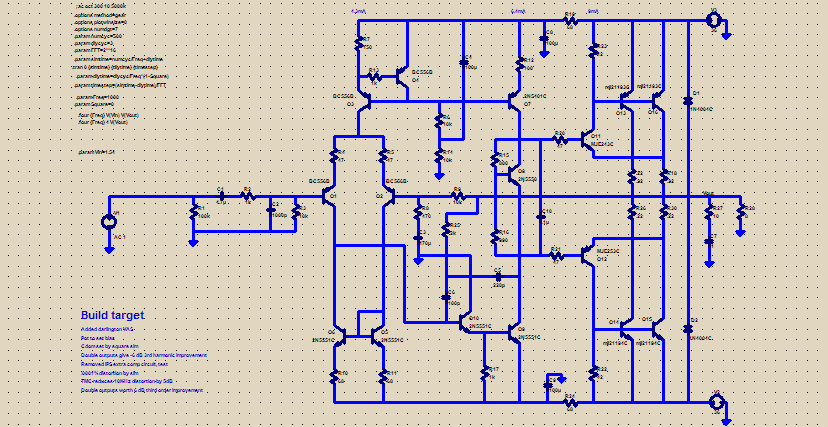

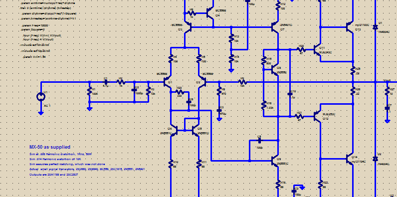

In my playing with the MX-50 in Spice, I found the darlington to sim vastly better than the simple cascode. Changing to TMC helped the high end distortion. I was keeping the changes minimal as I am using the boards that came. If you are doing your own boards, a lot is opened up. When I find a transformer, I am going to put it together. I was thinking about converting a DH-220 into a test power supply with adjustable regulators for VAS. Yes, it seems a shame to cut up a good amp, but it is cheaper than building a supply. I figure I can recover most of my cost by selling the output transistors. Maybe I should buy a crappy amp to cut up instead.
Tvr, now try this get rid of cascode and just use a beta enhanced vas as Self proposes, this is what we were discussing. When you did comparison did you keep such trivial parameters like vas currents the same ??? When investigating its preferable to isolate the stage not sim it in circuit.
Btw what does this MX 50 look like ??
