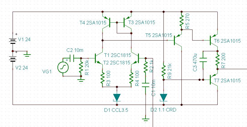

Well, I got to thinking and fooling around. Two power transistors in SRPP formation. One watt into 8 ohms with about 1.5% distortion. Not terrible, but not outstanding either. Given that at the time there weren't any good complementary transistors, I guess this was not too shabby.
Let me suggest improvement:
1. Zener referenced to ground instead of + rail, and
2. Resistor between Zener and base of gyrator.
Oh, I'm sorry, that is a CRD (CLD), not a Zener.
I wonder if an SRPP made from jfets (and thus self biased) would have better performance with changes in the power supply.
Otherwise, I'll just build the Leach amp.
Ah, it is current source... I thought it was backward drawn Zener.
You may add one more transistor and feedback to it's emitter that will increase PSRR and decrease distortions and output resistance.
Back to the topic, I think the name "VAS" is misleading because in any real amp it is loaded on some impedance that is also non-linear. Even in order to amplify the "voltage" it has to be able to drive this impedance properly.
Can you show me please? I'm having trouble picturing your idea. For the attached circuit, the power supply has to be within +/-0.5 volt for good performance. It's like the VAS is balanced on a knife edge, which is not comfortable for me. (this is only for full power output, for much lower output the allowable variation in the power supply is at least twice that)
(T5 actually has it's collector connected to ground, not the -24V supply)
