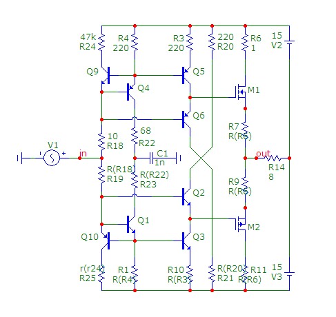

I've redrawn the top half of this output in a format that matches your description. Now I see it. Very clever - and quite fun to make the leap from your first schematic to something more recognizable. There's so much to see in this design and lots of potential for playing with it. It's possibly a novel way to look at the CFP.
You got it right. The bottom part, P-type, is a mirror reflection, and both VAS-es are loaded one on another.
You may look at it also as a Sziklai Darlington with additional diode (bottom) that protects it from over-current, and one more diode (top) that thermo-compensates an output transistor.
In any case, I could patent it: it is a unique topology, with own unique properties. Now, since it is in Public Domain, everyone can enjoy it, but nobody can sue me for patent law violation if I start using it commercially.

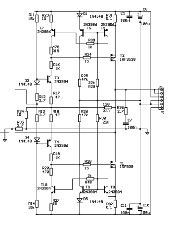

This is the best class AB stage
Hybrid Amplifier by Andrea Ciuffoli
and now I am testing this
I will try soon 2sk1058 instead of BUZ900P and 6C45 or 5842 instead of D3a

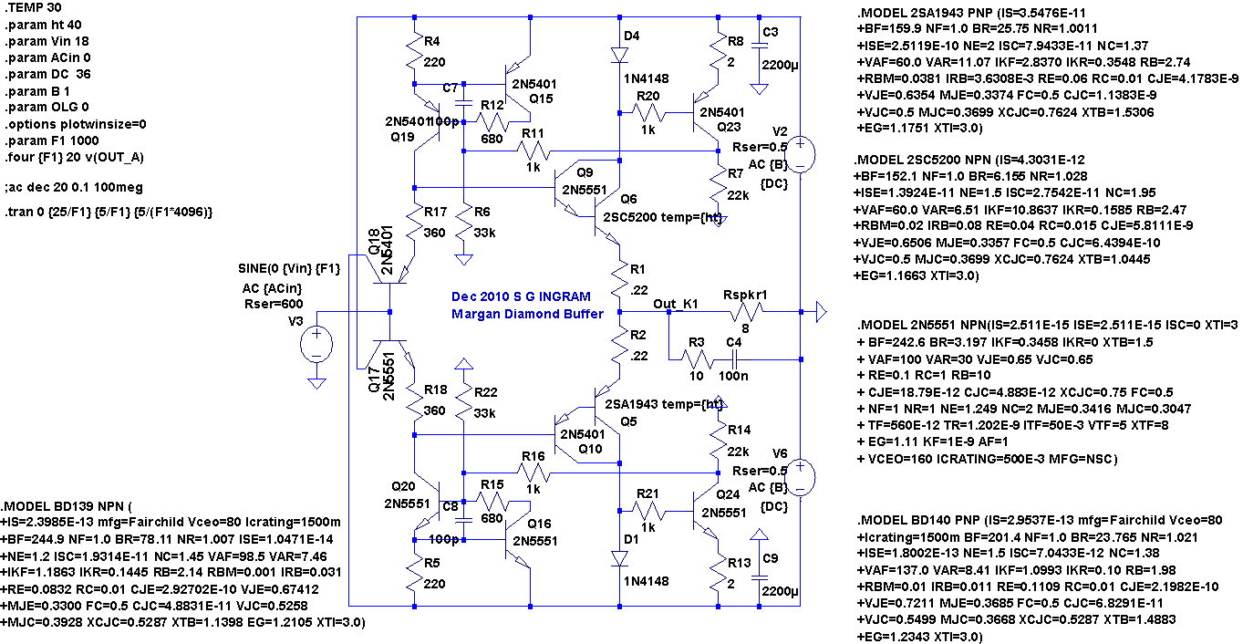

Margan

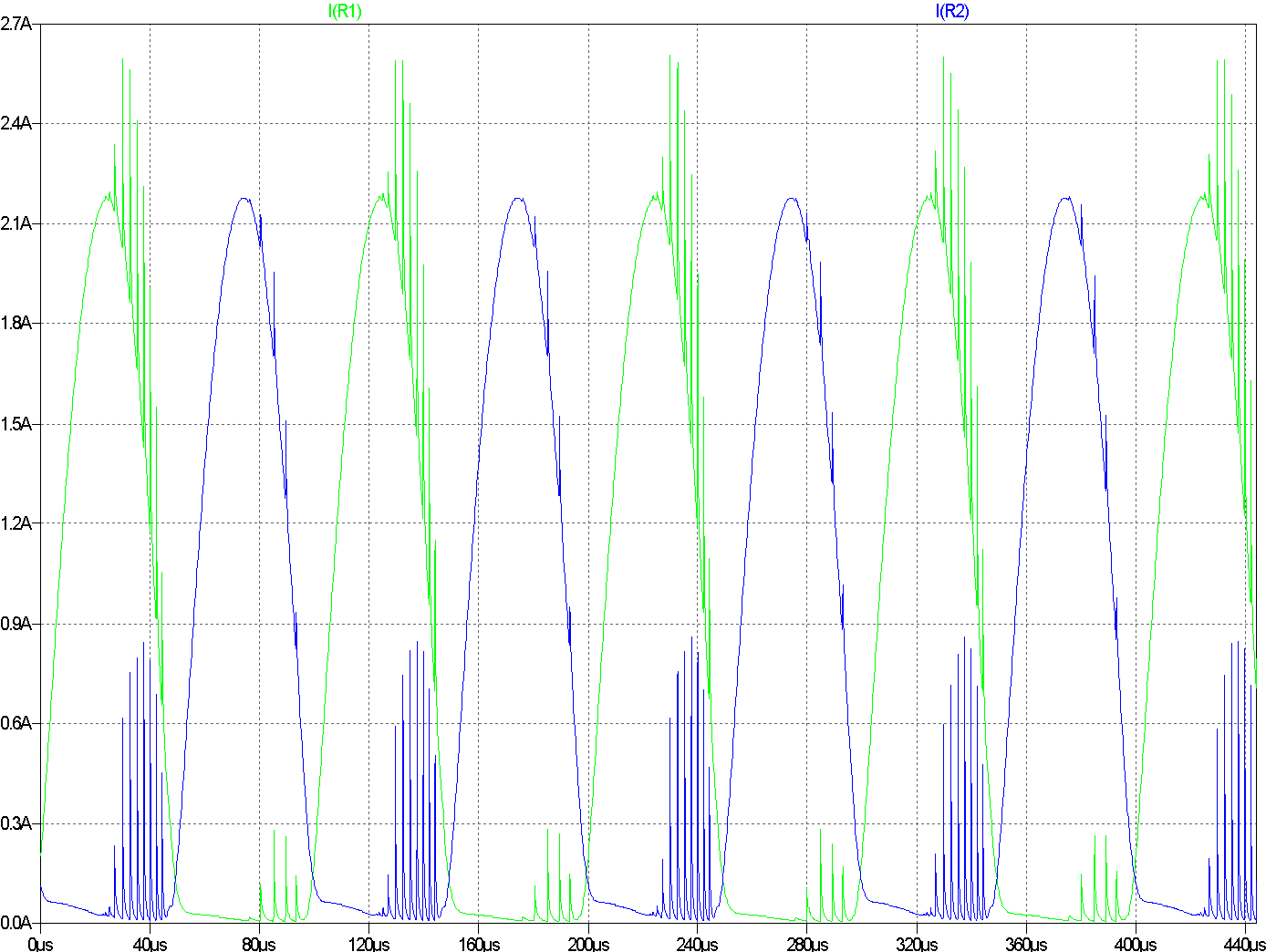

I couldn't resist a quick look at that Margan idea - essentially looking at the current flow at the output to determine when the devices switch off and boosting the current to Diamond Buffer to prevent it.
I'll attached the spice file (to the next post) for somebody else to play with - it's a bit of botch job, not very effective, not very stable and not clean enough.
Voltage drop is measured across a diode and the signal used to modulate the CCS that powers the diamond buffer signal stage. That's all I did.
First plot is the schematic.

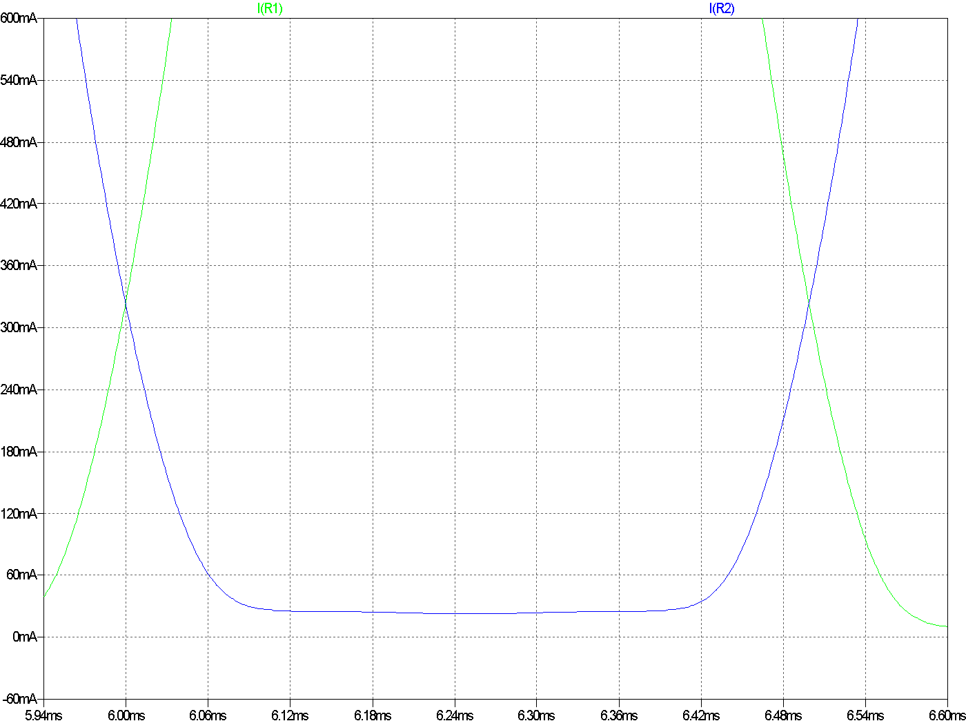

Second plots shows current through an output device, never turns off.
Third plot shows same thing if you get is all messed up - looks strange eh ?!
If you know how to configure this thing to work properly please let me know !
