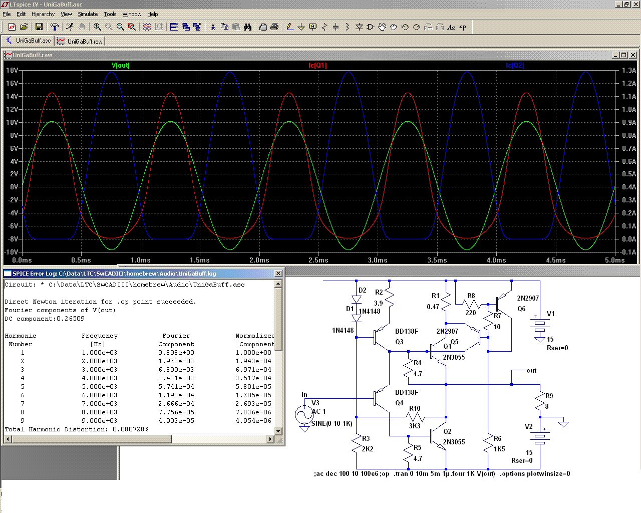

In the attachement the DC conditions in my simulation for that circuit (between 2N3773 and 2N3055 no difference to observe).
The p-spice modell of 2N3773 I have download from
ON Semiconductor
It is also possible to operate it in a high bias mode:
By pushing the Iq to ~200mA, Q1 never turns off completely, and the result is a very soft class AB operation, and a distortion down to less than 0.1%.

Indeed, but here, there are times when Q1 alone is active, and this should cause even order distortions, but this is not the case.
Replacing the input transistor by a composite increases the input impedance to ~6 Meg, and reduces further the THD:

At whole very interesting. If I have time, I will test the sound character. Why is despite Iq servo a thermal compensation necessary? In the attachement both circuits to compare the DC conditions

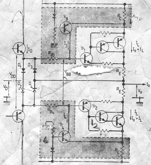

frominteresting topic. I recall to a special circuit in the German magazine "Funkschau" (diy power amp project approx. 1965) concerning bias stabilization for 2N3055 Circlotron. In the next time I will check old stuff and if I find this article, I will report about that circuit;
http://www.diyaudio.com/forums/soli...polar-transistor-circlotrons.html#post2337331
the second attachement (second circuit) shows the buffer stage and the exactly title and magazine number.
Concerning the temperature compensation was follow to read (translate in english from me):
By the CSPP topology there is no DC feedback (in opposite to normal true complementary push pull darlington or triplet BjT power follower). Therefore this kind of temperature compensation (NTC resistors) was used.
The first circuit with Sziklai-darlington is an idea from me - more easy to find appropriate thermal compensation about the source resistance.

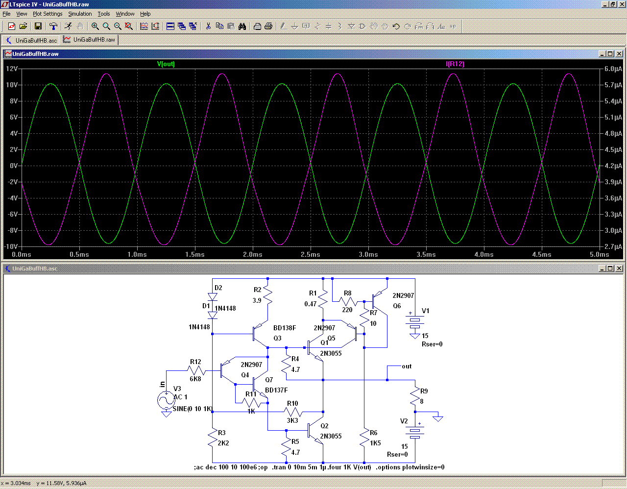

another ab buffer with jfet aikido
another buffer approach,
taken from the site evolve power amplifiers Trans_linear_Bias
should I call it aikvolve or evkido no matters🙂
again this buffer worries me: symetrical limiting caused more odd harmonics, you can see it at higher levels like 15Vpp. More idle current helps a LOT, odd harmonics dissapearing but my intention was the radiators only warm...🙄
anyway with the idle ~80mA at 10Vpp only odd harmonics are little higher than at 1Vpp

Symmetrical output doesn't 'cause' odd harmonics per-se, but it does a good job of canceling even harmonics so that the odd harmonics are left as the dominant signature. I wouldn't be too concerned yet, best build it and then worry if you need to tweak it.

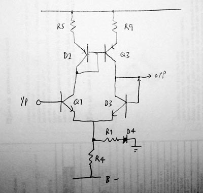

Q1 and D3 form a N-type LTP. Q2 and D2 form a P-type LTP. Q3 and Q4 each represent VAS for each opamp. They are loaded on each other, fully symmetrically. I.e. it is a complementary fully symmetrical opamp with 100% negative feedback.
For better linearity and thermal stability D1+R5/Q3R9 in the upper half and corresponding parts in the lower part form current mirrors.
Long tails are shortened intentionally: they are calculated for peak output current on max swing when the half in in class B phase. It prevents both hard clipping and output transistors' damage when output is overloaded. Don't apply GNFB around this stage, otherwise you will loose soft clipping!
You can turn it into class A symmetrical output stage: just remove R1,R2,D4,D5 and decrease R3 and R4 values.
I've redrawn the top half of this output in a format that matches your description. Now I see it. Very clever - and quite fun to make the leap from your first schematic to something more recognizable. There's so much to see in this design and lots of potential for playing with it. It's possibly a novel way to look at the CFP.
Then I have yet only one possibility in mind: The introduce of emitter resistors for the output bjt's and using a lot of this units as whole circuit in parallel mode.I don't think that using Sziklai would influence very much the range of the servo: it is dictated by the ratio of Ic(Q3) to Ic(Q5), and there is a limit on how low Ic(Q3) can go: it has to be sufficient to drive the upper output transistor by itself.
But the question is, what value must have the emitter resistor at least to get full servo funktion.
Thank you for create this schematic. Very interesting detail is the introduce of serial network consist of R1 and D4 between the emitters of differential input amp and GND. This approach I have never seen before in a commercial amplifier circuit.I've redrawn the top half of this output in a format that matches your description. Now I see it. Very clever - and quite fun to make the leap from your first schematic to something more recognizable. There's so much to see in this design and lots of potential for playing with it. It's possibly a novel way to look at the CFP.

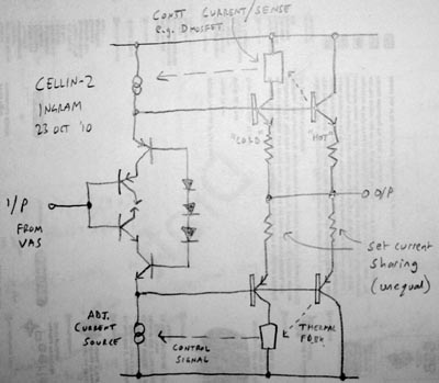

Now, it's time to combine some of the different thoughts I've been pursuing, such as the auto-bias thread [ http://www.diyaudio.com/forums/solid-state/145013-variable-operating-biass-output.html ] and my decision to go the Diamond Buffer route for my CELLINI-2 amplifier [ http://www.diyaudio.com/forums/tubes-valves/174889-cellini-2-hybrid.html ] which needs a no-feedback ClassAB buffer (the subject of this thread).
What I want is the means to control the bias from both the perspective of minimizing power dissipation without 'starving' the output and in terms of thermal stability.
Because I have imposed some limitations e.g. - no feedback it means no error correction. It also means that I can't suffer a large resistors at the output to provide current sense elements that might be used for bias control since they will increase the output impedance and there is no feedback to pull it back down.
So I'm thinking of using two pairs of complementary output devices with unequal current sharing. See the attached sketch. The main output devices will be unfettered (and 'hot') but in parallel with them is another pair which will run cooler and include a collector load that provides a means to monitor the current through them and therefore, through the amplifier output.
I figure that I get more measurement sensitivity if the collector load resistor is large, but this introduces a drop in supply voltage to the output device and attendant distortion. So I'm wondering if a current source could be used here instead. I'd then tap off the collector of this output device a measure of output current which is then used to control the bias current of the Diamond's drivers.
If done carefully it should also protect the output from over-current as in Nelson Pass F5 and the possibility to provide some dc servo action ????
