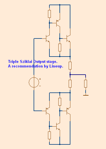

If you want a real killer, mainly for power and loudspeaker driving,
use something I call triple Sziklai.
We have normal 2T darlington.
And 3T triple darlington.
A Triple Sziklai is using 3 transistors, too.
The figure shows a Triple Sziklai
that simulates often better than triple darlington and anyhing else.
One other benefit, it has lower saturation voltage.
So can give a bit extra before clipping level.
Input impedance can be very, very high.
Like more than 1 MOhm I have measured.
MOSFETs and Triple Darlington steals voltage.
This is a factor especially when you have lower voltages and want to squeeze out max.
MOSFETs for example, can not work within 4-5 Volt of supply.
It all depends on your application.
For 10 Watt probably a double 2T Sziklai would do very well.
Now we will soon get some really wise guy coming here and discard Sziklai output.

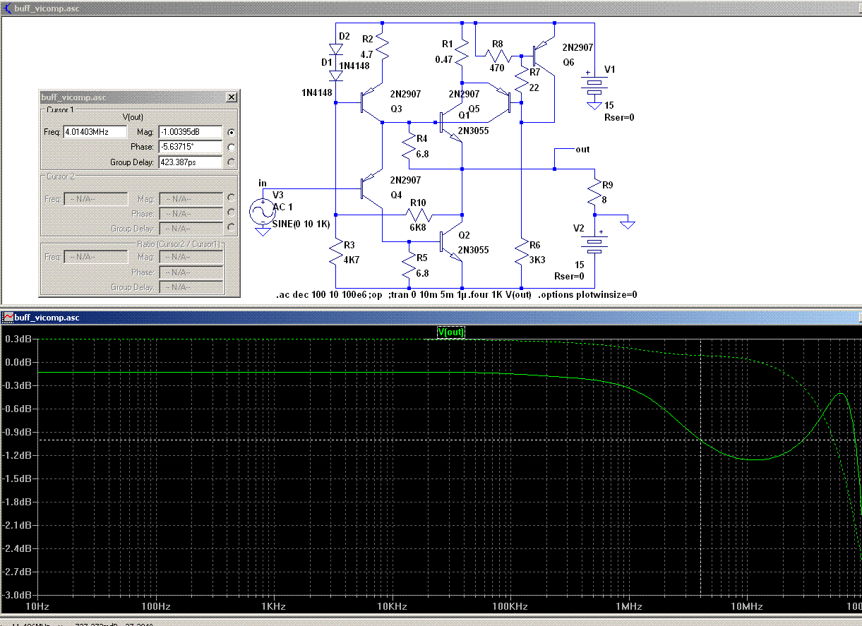

Here is an unconventional suggestion:
It is a half-diamond circlo buffer.
It has a full NPN output, low-Z, good linearity, no crossover distortion, a servoed Iq control, and a decent bandwidth, even with 2N3055s.

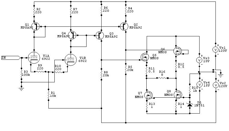

I'm also thinking of a tube VAS (JFET is an alternative) so this is really a kind of hybrid. And so maybe I forgot to include Wavebourn Tower design as an alternative ?

I have heard a no-feedback tube amp in my house and I very much like the sound. I don't want to build another global feedback amp after hearing this. Sure, there are some great gnf amps but life's too short to build them all so why not narrow down some choices ?
Whilst I like the sound of the tube amp, for a small desktop amplifier (such as one I might wish to use with my computer) a tube amp starts looking big, with two large output transformers for starters. So I am thinking of a hybrid with a single triode front end and SS output devices. If I do this with Class A I need huge heatsinks. So I am thinking Class AB SS outputs. I want to avoid feedback - but I simply don't know if Class AB without feedback is going to do the job adequately or if 'local' feedback can be 'allowed' without losing the sound I have heard from a no feedback amplifier. I do believe that if you are going to have any feedback at all, you have plenty of it and avoid the middle ground of just a little. The Sziklai has plenty of local feedback so perhaps it's OK, but perhaps it is not and the only way I could justify my feelings on this was to consider it a 'compound' device where the feedback loop is sufficiently 'local' as to be benign. But I have no experience to judge this. So I'm seeking opinions. I may simply stick with an all-tube amp if this is the best option.
Elvee, your description sounds great. But I'm struggling to understand how it works. I can sort of see the SE Diamond in there with Q4 and Q1, where Q3 provides a current source. But then it gets confusing. Everything seems connected to everything else. Can you walk me through it ?

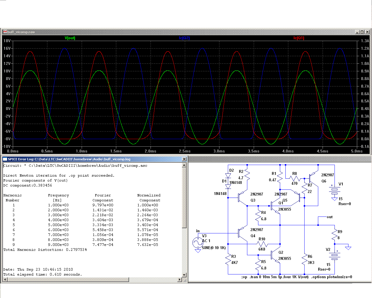

Q4 is the first stage of the half-diamond, but it also serves as a phase-splitter driving the two output transistors (forget Q5 and Q6 for now).
The current delivered by Q3 is just twice the current needed to bias Q1 or Q2 at the onset of conduction, taking into account the B-E resistors R4 and R5.
In the quiescent state, Q4 derives half of Q3's current into the base of Q2, while the rest goes into the base of Q1.
When a signal is applied, it modulates the ratio of currents received by each output transistor, and the output operates in class B.
It is basically a "circlotron" topology (make a search on the forum), except Q4 is PNP, resulting in a unity gain circuit.
It is also called a "virtual complement", because the driver + N output synthetizes a N/P complementary pair, without using an actual PNP.
The circuit in this form wouldn't be thermally stable, and degeneration resistors would be required, degrading the output impedance, and creating crossover artifacts.
So, the bias current is in fact too low, and Q5 tops Q3, so that there is always enough current available in crossover region.
Q5 senses the collector current of Q1 via the shunt resistor R1, and has its Vbe compensated by Q6.
Q5 has to be thermally coupled to Q6, D1 to Q3, and D2 to Q1 and Q2.
Note that this circuit is just an example, and can (and should) be adapted to match the actual application.
Q1 and Q2 could be darlingtons or CFPs for higher output power and/or higher input impedance, and Q4 could be a CFP for a higher input impedance.

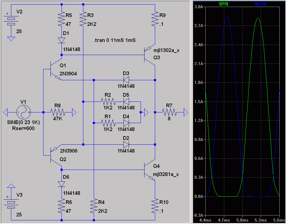

Q1 and D3 form a N-type LTP. Q2 and D2 form a P-type LTP. Q3 and Q4 each represent VAS for each opamp. They are loaded on each other, fully symmetrically. I.e. it is a complementary fully symmetrical opamp with 100% negative feedback.
For better linearity and thermal stability D1+R5/Q3R9 in the upper half and corresponding parts in the lower part form current mirrors.
Long tails are shortened intentionally: they are calculated for peak output current on max swing when the half in in class B phase. It prevents both hard clipping and output transistors' damage when output is overloaded. Don't apply GNFB around this stage, otherwise you will loose soft clipping!
You can turn it into class A symmetrical output stage: just remove R1,R2,D4,D5 and decrease R3 and R4 values.
I don't know how simple u want, but if no global feedback and class-A, this works ok.
The bridge mode prevents large offsets (due to temp drifts) at the output, which is kinda nice when u dont have GNFB to correct for the output's offset.
U will have some offset though, I think in mine it hovers around +-50mV, but that has never been a problem to my speakers.
The mirror type of circuit also makes an easy PP output if u add another pair of mirror transistors to drive the lower PP set of output transistors.
