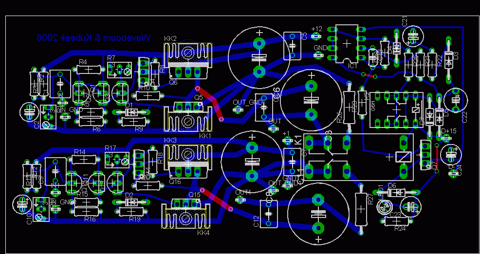

kubeek said:This should be the last revision 🙂
Downloaded!
Thanks kubeek and Wavebourn.
How far has come the practical build and testing
of this very special project?
lineup
In fact I still don´t have time to even breadboard this amp, but I am sure I will make it, some day.
Maybe I will etch the board this week, and then there just the funnier bits remaining 🙂

Never heard of any updates, and I still don´t have the money&time to make it, so I guess the board is still untried.
But because no-one complained and eagle doesn´t make mistakes too often, I bet it works.
Good luck if you wish to build it, and keep us posted about the results!
So I finally managed to build this amp, and I am really happy with it. It sounds really good and has enough power to drive any kind of headphones.
Measurements showed that the amp has really high bandwidth (it clearly reproduced sine even at 1Mhz), but I didn´t have any problems with stability what so ever.
So feel free to build yourselves a good headphone amp!

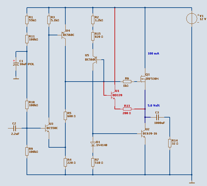

With 150 mA quiescent current it can give up to 300 mA of peak current, i.e. output power on 8 Ohm can be 0.15*0.15*8 Watt only.
For better linearity idle current has to be equal to max output current (in such case current through a voltage follower will be always the same); for better energy saving it has to be a half of a maximal output current.

Wavebourn said:With 150 mA quiescent current it can give up to 300 mA of peak current, i.e. output power on 8 Ohm can be 0.15*0.15*8 Watt only.

I did some spice.
What I wanted to know is your 'trick' of using one BJT (BD139)
in parallell with the IRF610 in the output stage.
In this post I attach my schematic for my Test Setup.

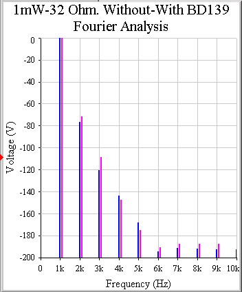

In next post I will attach one FFT, Fourier Harmonics Analysis, Comparing test:
With and Without Wavebourn BD139.
Bipolar parallelling MOSFET in output stage.
Wavebourn 'trick' of using one BJT (BD139)
Attachment one FFT, Fourier Harmonics Analysis, Comparing test:
The Harmonics spectra will change.
Not much. But nevertheless a change.
As can be seen, with the BD139 bipolar in parallell with the IRF610 MOSFET
we get a bit more 2nd + 3rd
and a bit less 4th + 5th harmonics.
Regards 🙂

It depends on how good are models in terms of non-linear capacitances.
Thanks Lineup!
Can you try it on higher frequency, like 10 KHz?
Wavebourn said:
Thanks Lineup!
Okay.
But I do 10 kHz tomorrow.
When I am sober.
I have had some Madeira wine this evening.
Regards
