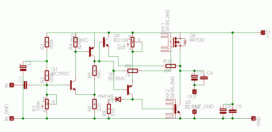

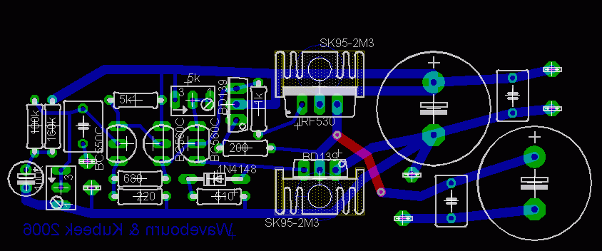

kubeek said:the acutal circuit is actually included in the zip with the board, but I will post them both as pics.
Let me advise a little bit:
1. Filter caps must be placed near output transostors.
2. Wires to filter caps from power suppy and from filter caps to output transistors must be separated.
3. Ground wire to headphone output must go again from the filter cap.
Never connect power supply between filter cap and input stage.
4. D1 put closer to Q5 so distortions will less depend on temperature.
5. You forgot to put "Wavebourn & Kubeek Designed" lettering on the PCB. 😉

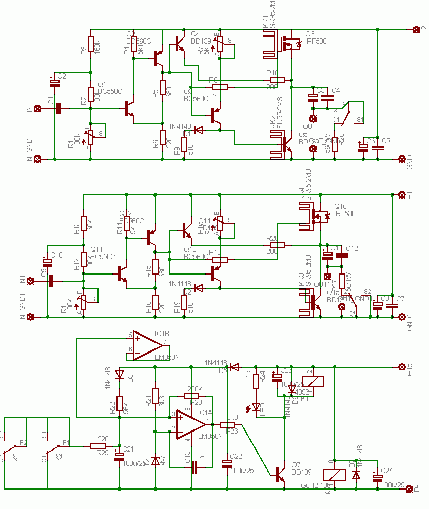

What is the best solution to avoid turn-on and turn-off thump?
What about using a relay to short the output through some resistor?

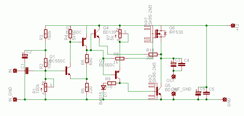

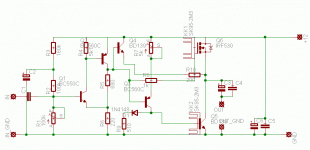

kubeek said:And the circuit, the only difference is swapped D1 an R9.

I will try to do some EWB Multisim testing of this latest version
circuit schematic:
http://www.diyaudio.com/forums/attachment.php?s=&postid=1060316&stamp=1163891588
I only hope I have Spice models of those transistors ...
All Good audio diyaudio transistors were not in the default Multisim distribution.
I call it:
It is a good idea to rename each version in a topic
to make it easier to know this is a different and later version.

kubeek said:What is the best solution to avoid turn-on and turn-off thump?
Big C2, resistor in parallal with output socket, "speaker protection" relay.

Does anyone have some schema for speaker protection, which I could use with this kind of amp?
I was thinking about powering the relay from a separate diode bridge without capacitor, and switching on after some time.
kubeek said:Wavebourn, will you post here the 200W version?
Here you go: 2x200W amp that uses the same topology of output stage.
First opamp is an amplifier for the input signal limiter, the second one is a servo feedback amp.
